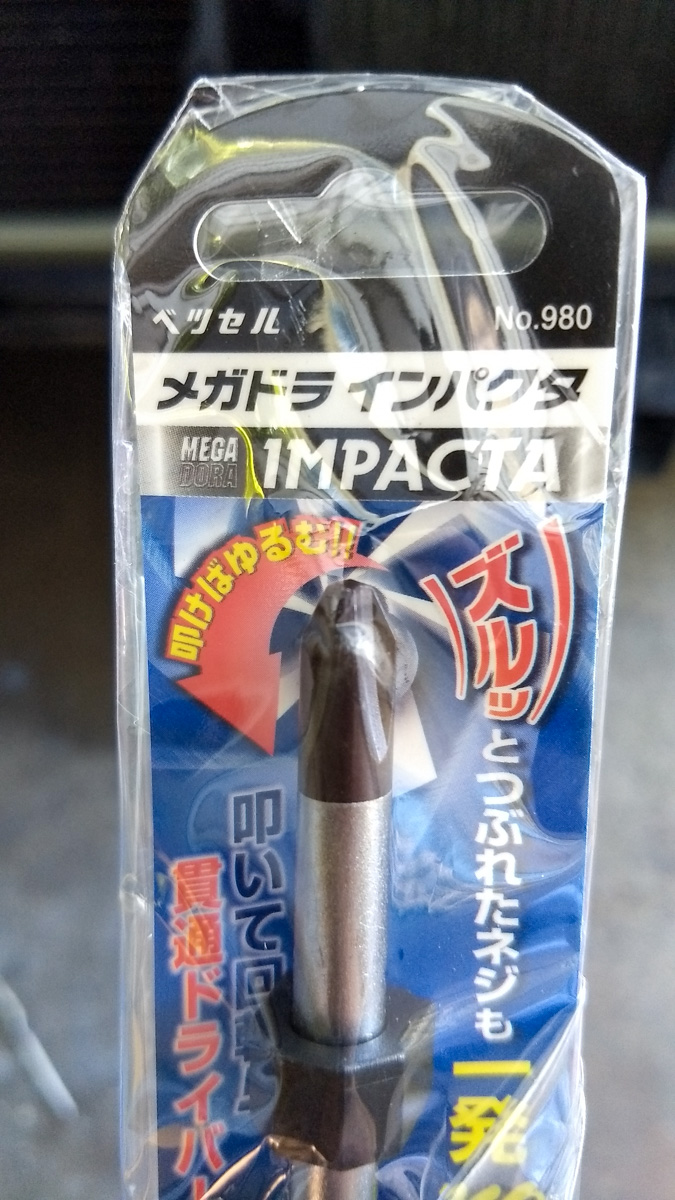

I came across the Vessel (Bessel) Impacta 980 series of screwdrivers on Amazon. They work like regular screwdrivers normally, but act as impact drivers when hit with a hammer.
Here's a terrible photo of the 150mm P2 making contact with the lower IAC screw, without removing anything. The angle isn't ideal, but it's good enough to loosen the screw cleanly:

My prior method was a Dewalt impact driver with a 1/4" long hex bit and a 1/4 driver extension, but that required removal of the PCV hose. The impact driver allows you to focus on leaning into the screw so that it doesn't strip:

That is a cool looking little tool, I may check that out. Was also advised that I may want to clean the MAF. Thanks again everyone for the advice.
