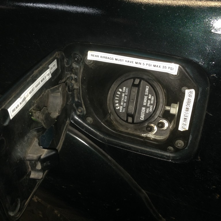

I installed the inflation nipples inside the fuel door.
That's a cool location for the fill ports. I'm thinking of getting a 45 gallon rear tank and that was the consideration for having in cab control. How much height do you gain at the 35psi maximum would you guess?

Yeah, having the subtank valve there would tend to use up most of that limited real estate. If you can somehow fit it all in, it's still the simplest spot to put them.
