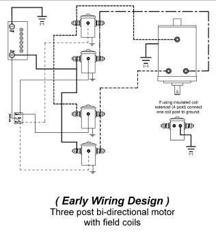

Hello, i have a smittybult and it crapped out on me . I was told by the rep that no lite on controle means relay gone- did the tap bang and take apart thing to the relay. Still no joy. Anyone know what i can use as a replacement for smittybult winch relay instead of a 130 dollar control box. Or any other troubleshooting tips for that matter. I have a basic understanding of electrical but just dont have a grasp on this 4 large wire 2 small wire setup . Thanks Jamie ( Could be stuck in florida! )
from warn .. but should work the same .. 4 solenoids ..
2 solenoids ..
if you are not familiar and don't want to mess with this never again .. do yourself a favor and get an albright ..
All of the solenoid packs/controlboxes/contactors for series wound motors will work if they are the proper amp rating. Get an Albright contactor. They are water proof. I don't know what you mean by 4 large wire 2 small wire.
