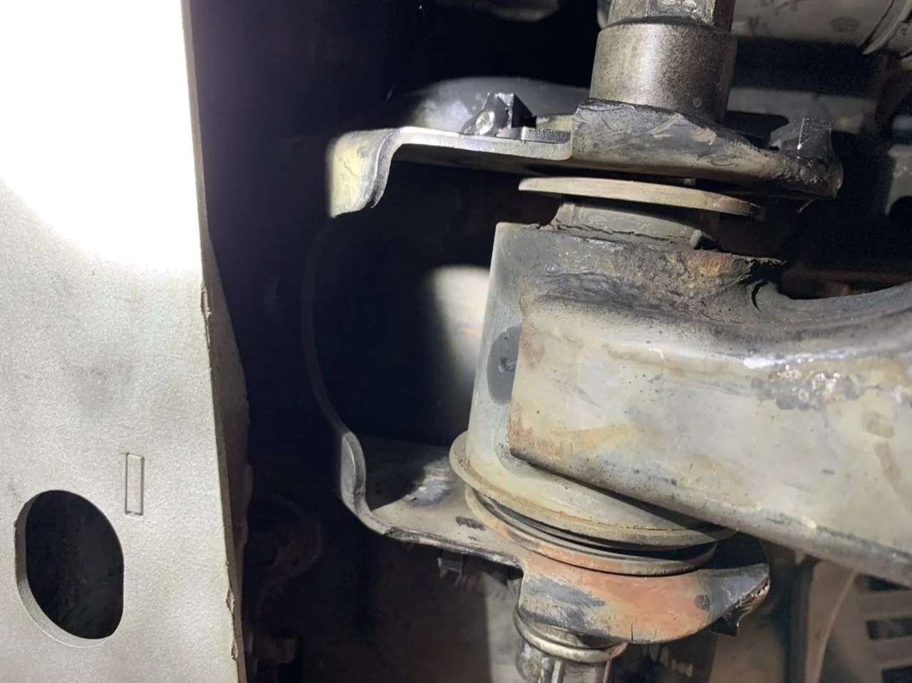

An alignment shop decided to torque the LCAs while not under load. What symptoms should I expect with bad LCA bushings? Vibrations? Clunks? Here's pics of the front side bushings:
