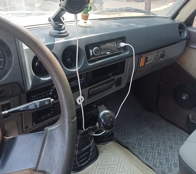

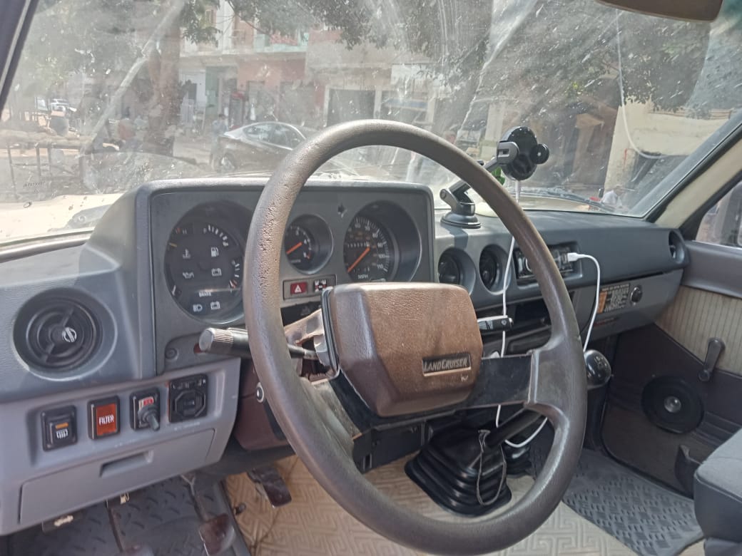

Howdy folks, just recently joined the 60 series family and really looking forward to enjoying the experience!
First thing I noticed was the lack of space and USB / electric sockets for the various instruments I use for off-roading. I do some chargers but manual gearbox clearance in 3 & 5th is so low i cant shift if I plug it in.
The console I have is the same like the 80 series (Probably retrofitted by the previous owner).
I need at 4 to 5 charging cables for the Camera / GSP / Phones etc. as well as other bits and pieces at the passenger side, so any ideas & solutions are more than welcome.

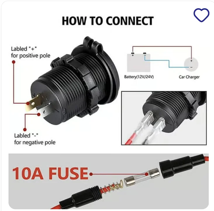

Depends on how you want to use it, below is a direct battery connection in case the USB charging port is needed to have power regardless of ignition position.

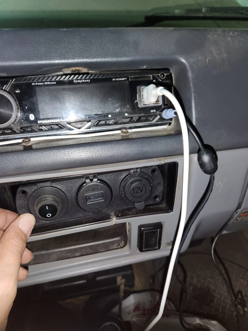

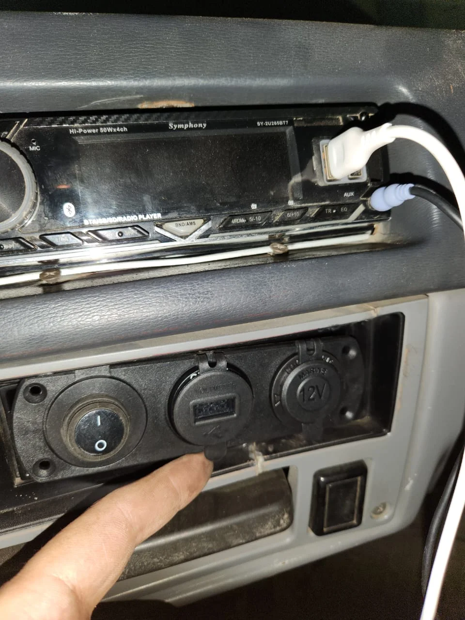

Found a nice solution on Aliexpress, its 13$ shipped and received.
Will just need some minor tweaking to fit it but seems snug enough.
I do need to make some holes or remove the compartment to allow cables access.
2 USB ports, 1 12V car socket and an on / off switch.
Will fuse it and connect directly to 2nd battery so i can use it with out draining main battery. The on and off switch will connect the electricity and also the internal LED lights i will fit inside.

I only use a bluetooth controller for my phone so I don't have anything in my radio slot. I have this installed in its pace. I also took the cigarette lighter out and installed a round one like the one shown above in its place. I had to use a step drill and open the hole up slightly to make it fit. It is recessed so the cable does not hit the shifter in 1st and 3rd.
