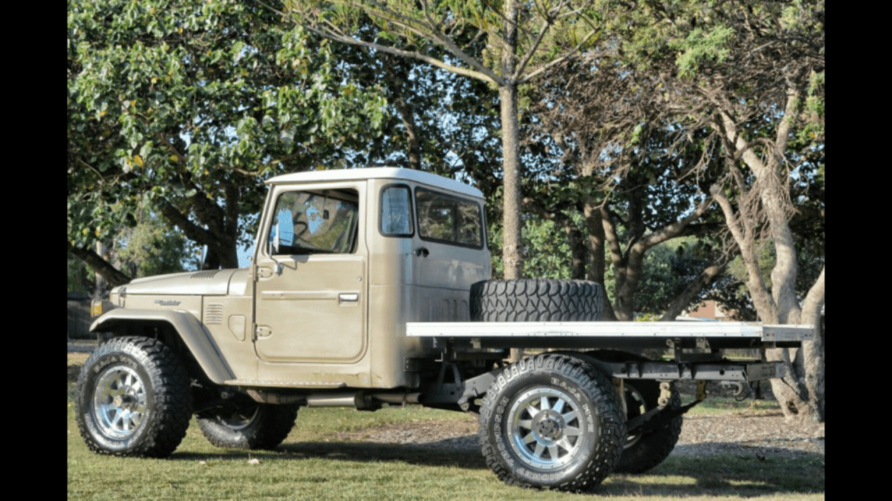

Well I think the simplest approach would be an fj45 cab with a custom flatbed. That means no body work or frame work to make it all fit...
Oh an Aussie tray back UTE...

Here is some pic of what the OP has described.
