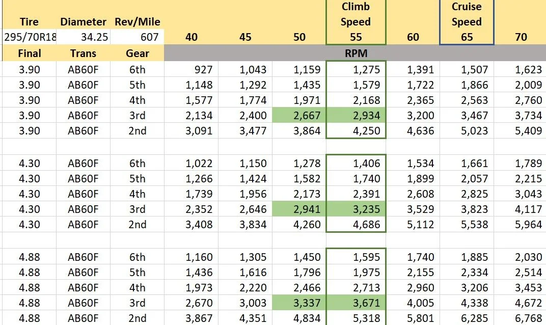

I have a more scientific set of advice. First define what your problem areas are then compare those areas with the chart below and see that the re-gearing puts you in the right powerband to solve your problem. The below example is with 34s. The colors are just an example of were you would be before and after in a 55mph mountain pass climb. 3rd and 3.90s and 2,934 rpm is probably a great gear to hold. With 4.88s, 3rd becomes a little short and 4th maybe a bit tall (depending upon weight and grade).

The chart is just a data point showing where you will at rpm (and powerband) for a given speed and gear. I come from the perspective of someone who didn't do the full research prior to gearing a truck and wish I had as it would have driven me (pardon the pun) to a different conclusion (5.29s in my case). 4.88s may indeed be a great solution for a given 200 build.
