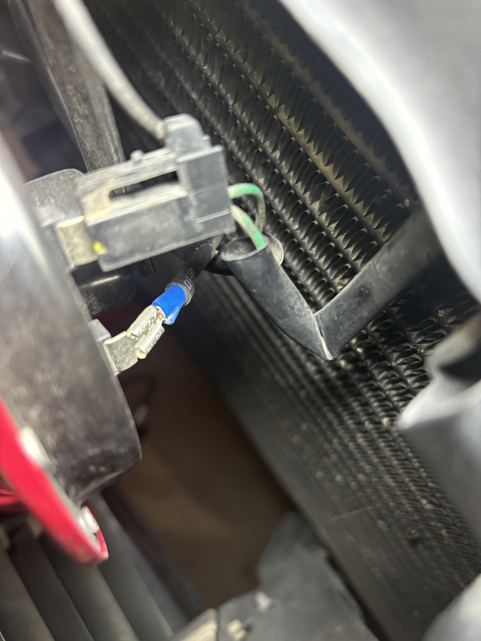

One of the wires going to the horn is broken from the connector. I need to find a replacement connector. Any suggestions on where I might find a replacement connector?
Plus one put an new female spade connector - you might need to do some chiropractic work with a small screw screwdriver or an pair of plyers to make it fit.
I recently went to harbor freight and picked up a new set of horns. They sound very similar to the cruiser, except without the cold virus. the same connectors (spade) attach right on the front. I'll go see if I can get a pic of it....

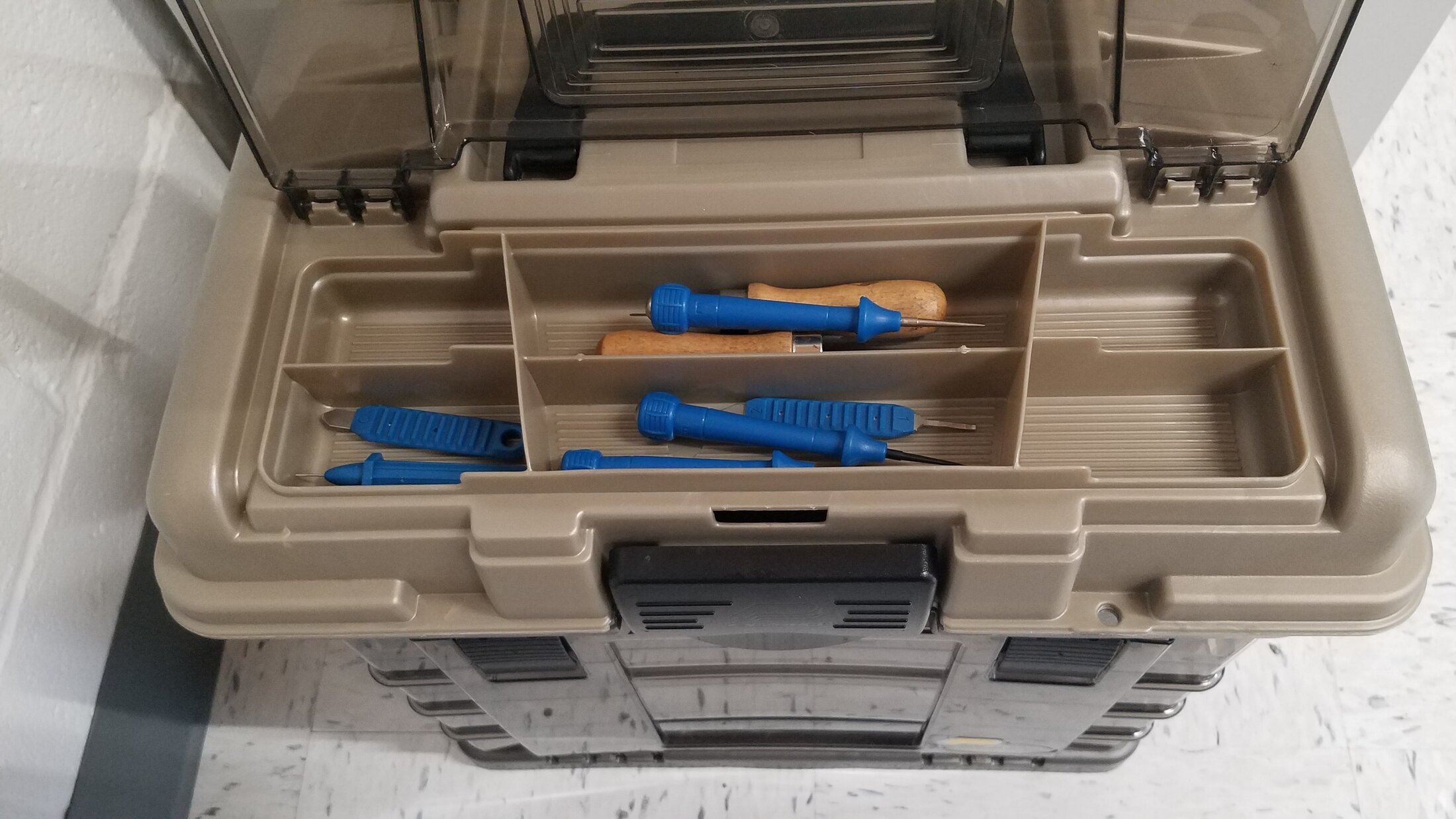

You will need an open barrel crimp tool to attach a new terminal, reuse the old housing. It's good to have the tools to fix these as they break. I keep my connector parts and tools in a tackle box to keep track.
