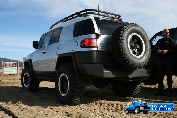

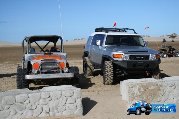

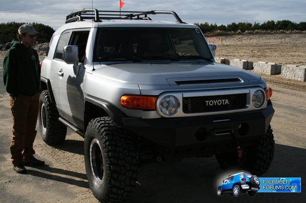

I'm running 35" KM2's, on 3" of lift.
You will need the most aggresive body mount chop you can do, as well as possibly the lower wheelwell corner.
I had to trim some plasic as well.
Once you get your tires, it's easy to see where the issues are(shiny steel where paint once was, shredded plastic).

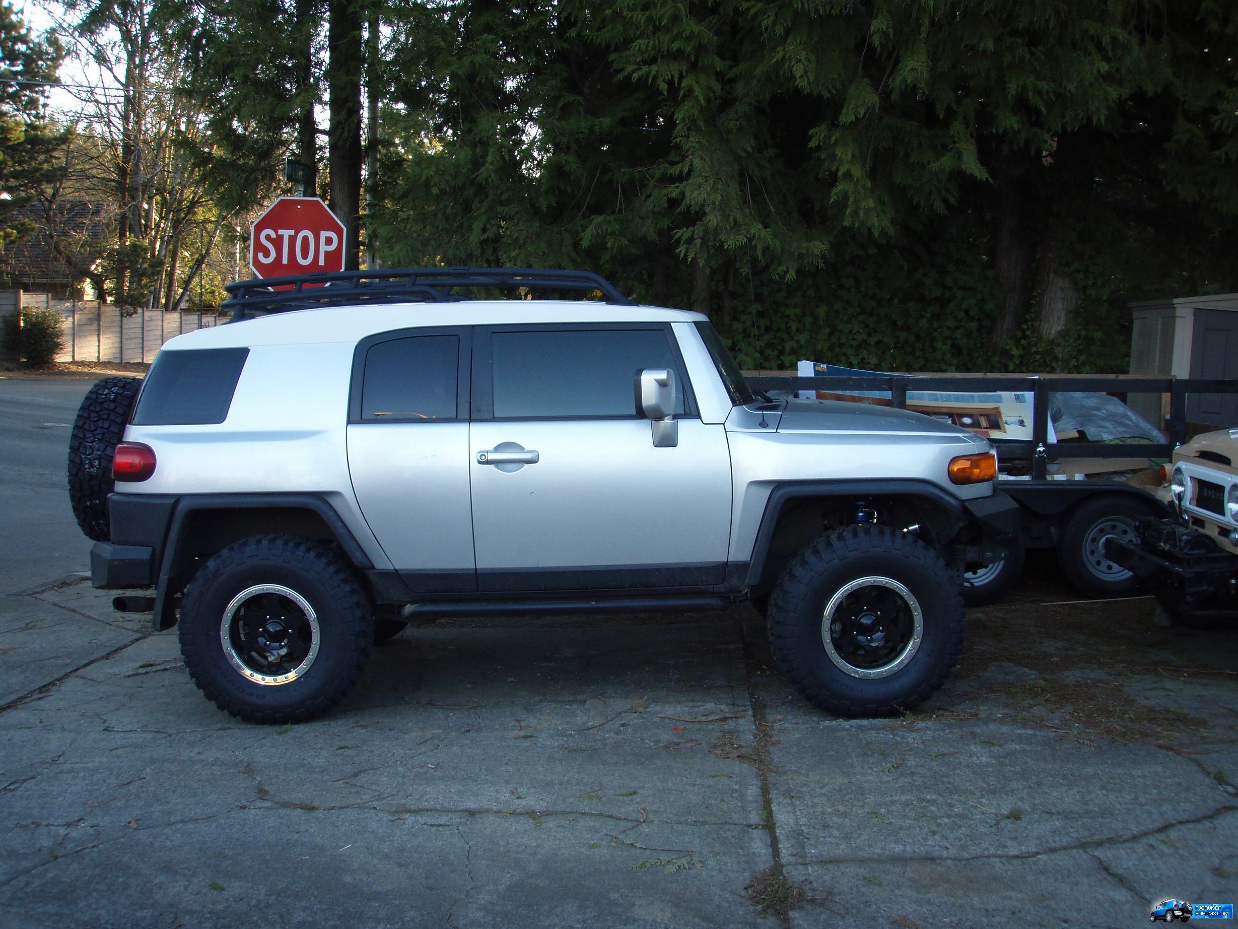

6" lift really doesn't buy you much in the bigger tire size, my 325 50 22's still rub alittle on the drivers side and I've cut the body mounts twice. The wheel wells are small and when you flex up into them they rub.
Without moving the front spindles forward (solid axle swap) 35" are probably the biggest you can fit.
