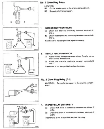

2- No.1 Glow Plug Relay continuity and operation
Is working like it should; no continuity on the relay, continuity on the plugs terminals leading towards the relay and continuity on the relay when applied 24 volt to the terminals leading towards the relay.
3- No.2 Glow Plug Relay continuity and operation

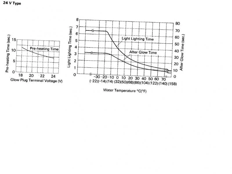

Someone with experience of the superglow setup may like to chime in but I believe your 14V plugs do get fed with "full 24V" for a brief period.
Feeding them with excessive voltage like this makes them "heat up fast" so you don't need to wait around for a full 20 seconds like I have to on my old 1979 cruiser. (Not that I'm really complaining because I actually really like my older system.)
I suspect the "full 24V application" time period is represented by the "light lighting time" on the RH graph. In other words.....around 1 sec at 70 oC and 6 secs at -20 oC (with the temperature being sensed by your coolant/head sensor). ..... In other words, I think your dash light illuminates only when 24V is being applied.
And as 1tontoy has wisely pointed out ....Since your dash light hasn't been working for quite some time, you may have been missing this feature for that same period.
The other line on that RH graph shows that "afterglow" should be finished after 30 seconds or so regardless of temperature. ..... Well..... At least that is my interpretation of the particular system described in this manual. (And you are right to conclude that more than 1 type of superglow system is used on a 3B and my interpretation here conflicts with 1tontoy's experience with his later model HJ47 where he apparently says his afterglow is terminated by his temperature sensor and could remain on far longer than 30 seconds.)
Now the LH graph has me completely confused. Perhaps someone with personal experience of this superglow system can explain it for us? It appears to me to suggest that the busbar voltage varies from 18 to 24V. Yet I would expect you to be getting around 22 to 24V for the "quick heatup period" (lasting up to 6 seconds) and then dropping immediately to somewhere around 14V (roughly matching your glowplug rating) for the "afterglow duraction".
But as I say .... on the topic of superglow .... I've no personal experience at all Coen. (I'm just another text-book-reading discussion-facilitator.)
:beer:
I read the RH graph like this: read from left to right. Anytime the water temp is in those temperature ranges, your afterglow is ON for bursts of seconds. If the manifold sensor (which I think has water in it?) continues to show a temperature within that graph, it will re-trigger the afterglow for the corresponding amount of seconds. This is why I say it is possible for afterglow to come on in very cold climates like dropping into an very cold valley. The Cummins motors do this, too. You may think your engine is warm, but if the intake air temp triggers the sensor, pre-heat is triggered to ensure proper burning of fuel. Could your manifold sensor be not functioning/connected/missing?
I read the LH graph like this: read from right to left corresponding with the RH graph. Initially, per the LH graph, the pre-heat is full 24V for ~7 seconds (corresponds with the light lighting time from RH graph for a completely cold engine).
You have to consider the water temp which is read by the sensor. The amount of time that the afterglow is triggered, per temperature, corresponds to the pre-heat voltage. So, afterglow time is dictated by temperature, and afterglow time dictates voltage. I think it is safe to say that afterglow is always 24V.
Of course, I'm no expert.

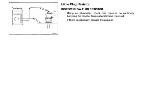

If this is how you tested your Resistor then it doesn't appear to correspond to the FSM description here:

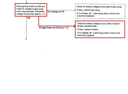

Furthermore, the following part of the FSM suggests to me that if this resistor is faulty it will leave your plugs exposed to the full 24V battery voltage (when the voltage should actually drop to around half that figure for "afterglow").
And this continuous high voltage would cause your plugs to explode like yours actually have!
And furthermore (if I'm not mistaken) this "glow plug resistor" would likely have been available to your engine reconditioners (to destroy) when they were applying jumper leads and trying to start your engine.
:beer:

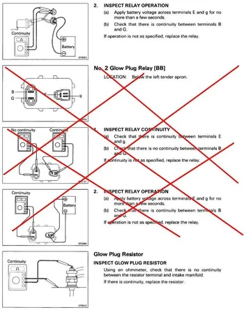

Hmmm my manual shows this:
And so I tested this, and there is continuity between the terminals.
Now if I test it like this:
Then I there is no continuity.
So both tests appear to turn out okay. Does this mean the resistor is okay?
