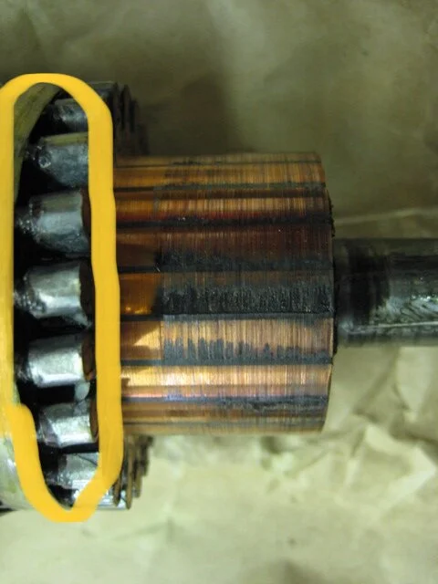

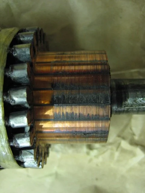

I tried a DB Electrical motor on my 8274 winch; it started working erratically after about 6 months of little use, and quickly went to hardly ever working. Took it off and pulled it apart and found this:
The very thin amount of copper on the commutator hard worn off on something like 50% of the surface area.
The DB Electrical motors are made in China. Maybe I got the odd bad one, but at the very least their quality control is quite poor.

@1911 I called WMS Western Motors Service Co. - http://old.wms1.com/wms1/ and spoke with Rick on Friday. I sent him the link to this thread. He looked at your pictures with me on the phone and said you were right about the thinness of the copper on the commutator. He noticed another issue with the DB Electrical motors is that they are lead soldered which can then melt when the motor gets hot. He said these are several of the reasons DB Electrical motors are some of the least expensive motors on the market. For reference WMS copper welds them.
I purchased their 6hp motor (on 6-3-23) for my 8274 part # W-7608 $248.35. Which is rated for 6 HP at 1850 RPMs. This motor will require the 20 spline pinion gear upgrade for my 8274. This is the Warn 9.5XP 6hp winch motor equivalent.
