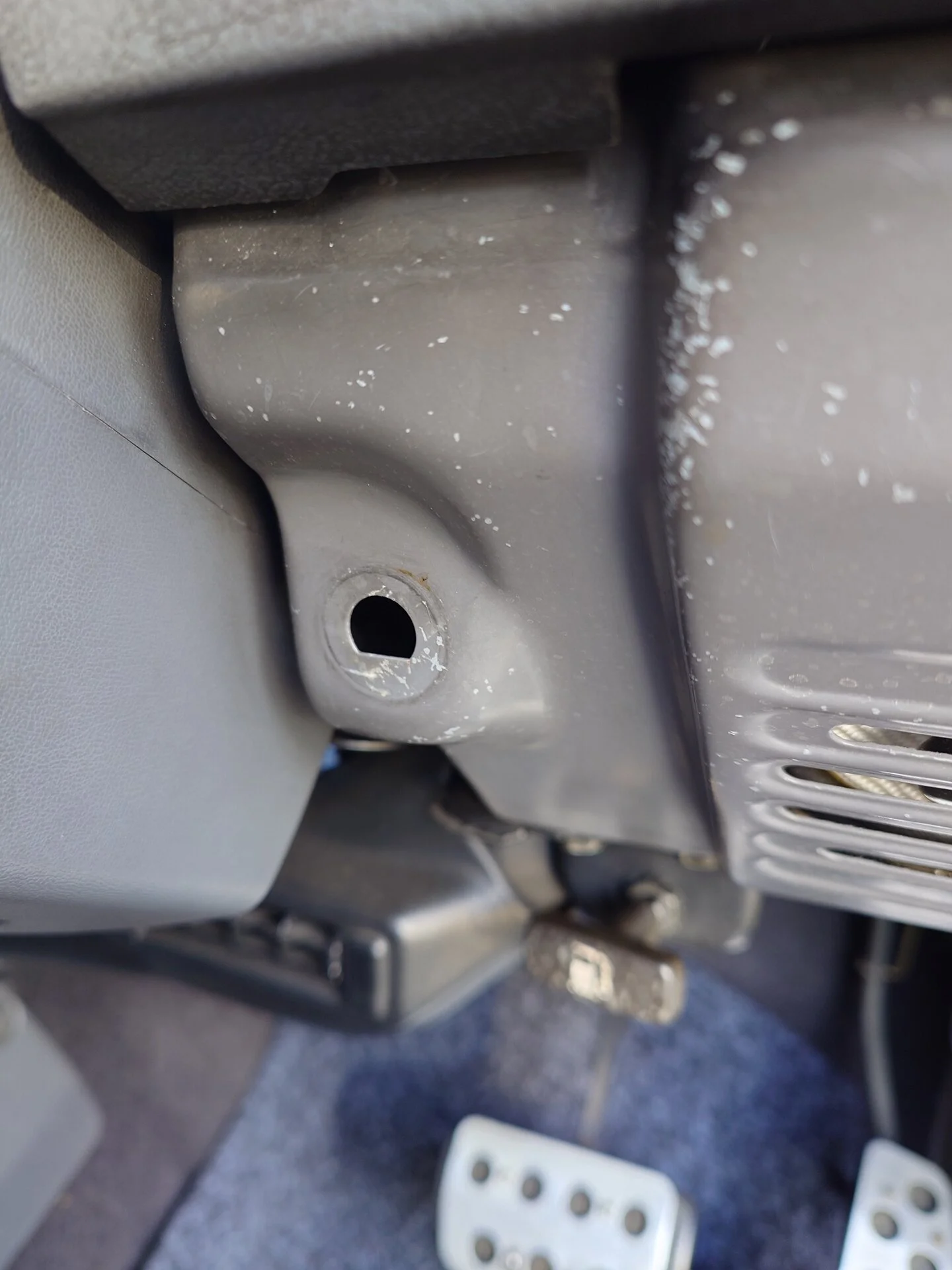

Does the KZJ78 have a differential lock or only a hub lock and if so where can I find it?

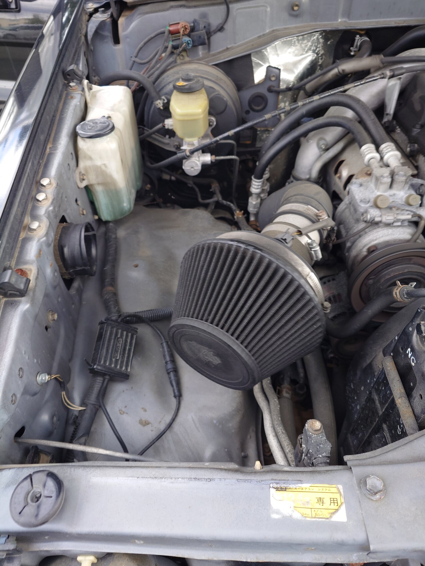

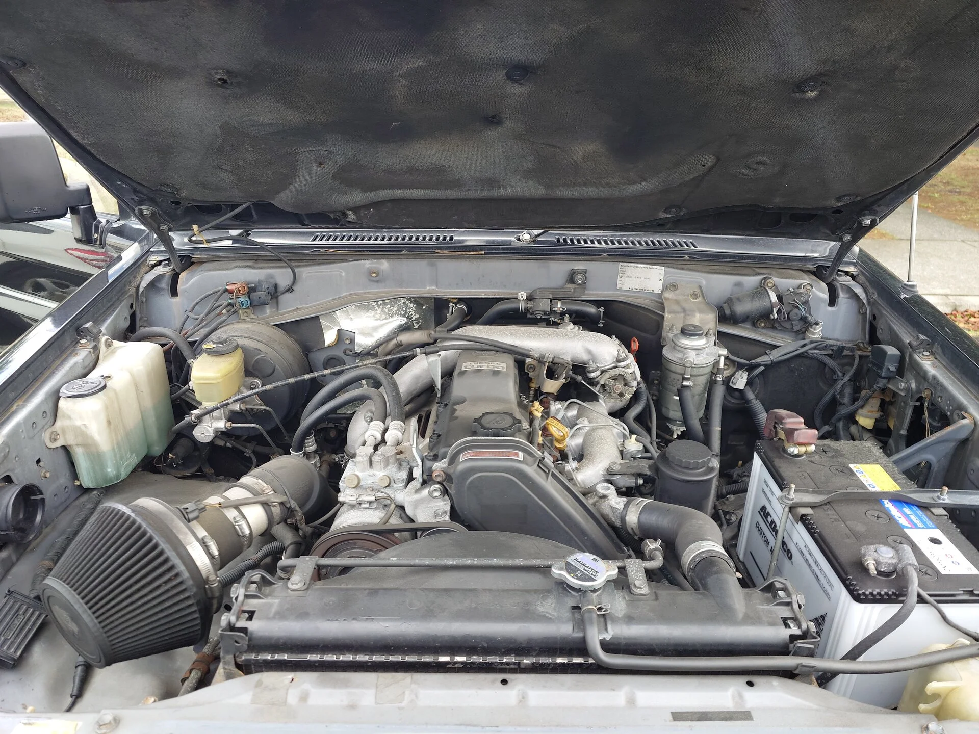

Previous owner removed the stock cold air intake and now there's a hole and an aftermarket, should I be worried?

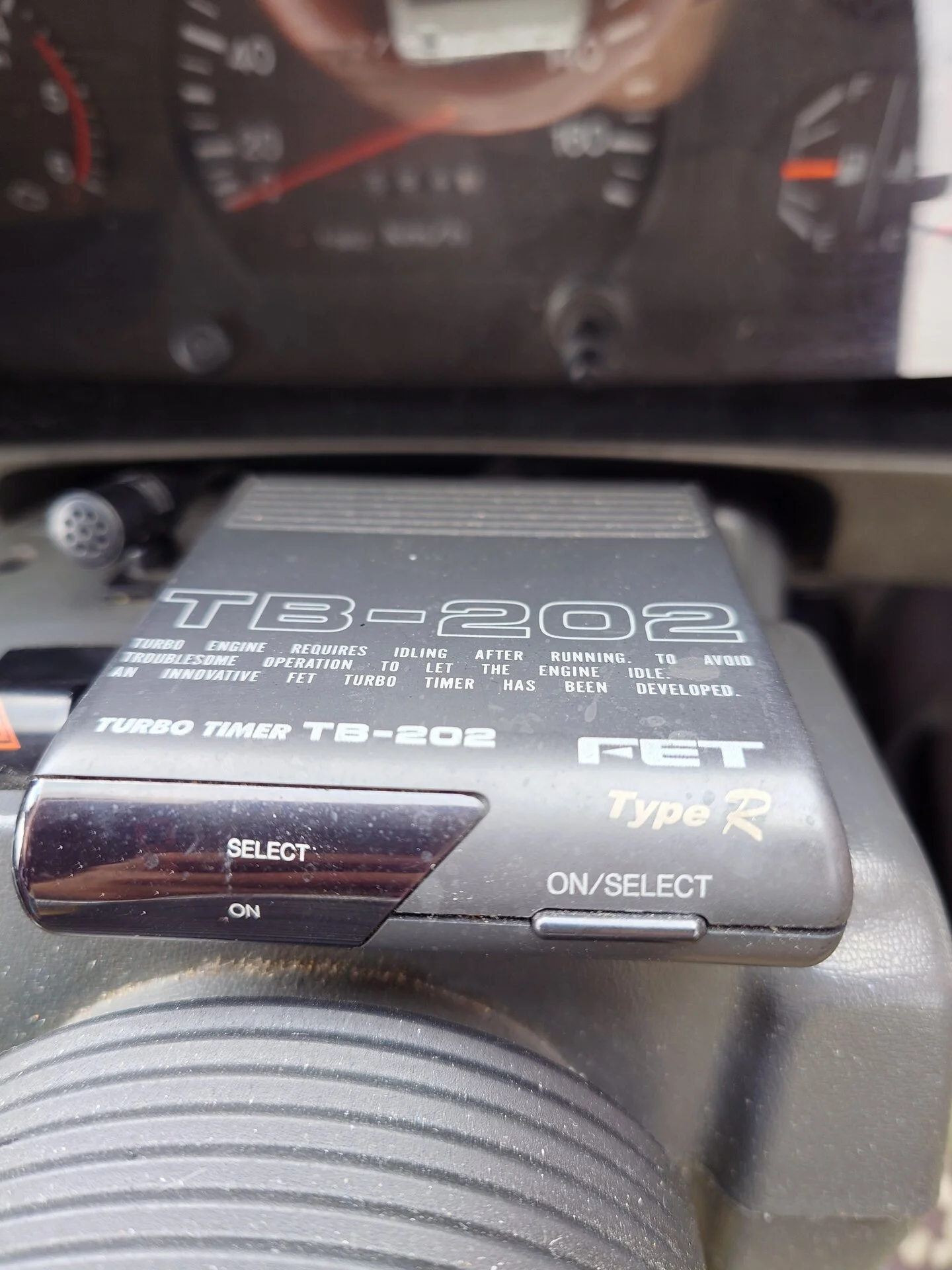

This thing above the steering
Depends on what it's equipped with, methinks. You should see a diff lock button if you have a factory one.
Eh, I wouldn't want to keep that, myself...but I wouldn't lose sleep over it.
While it is easy to turn on the 4WD button right next to the hublock, how do I utilize the 4WD stick handle by the transmission?
Rear diff lock was optional on the KZJ78, if you have one there will be a knob for it mounted to the lower left of the steering column.

If you can find an original air cleaner setup I would highly recommend going back to that.

The device on top of the steering column is a turbo timer, when turned on it will keep the engine running for a set amount of time (usually adjustable from ~30 seconds to several minutes) when you remove the key. This gives the turbo time to cool off after running hard and can help keep the oil in the turbo bearings from coking up. Mostly an issue on older diesels with no intercooler like this. Modern synthetic oil helps too.
