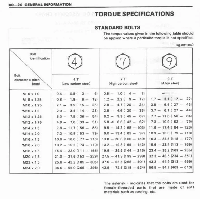

Stole this and not sure it is accurate. Found it while trying to find the info on a bolt that says 11 on it. Its amazing how hard it is to find this using google. Probably have this info some place in one of my FSMs if I look hard enough. figured this might be helpful if someone can confirm the info is correct for bolt head markings
