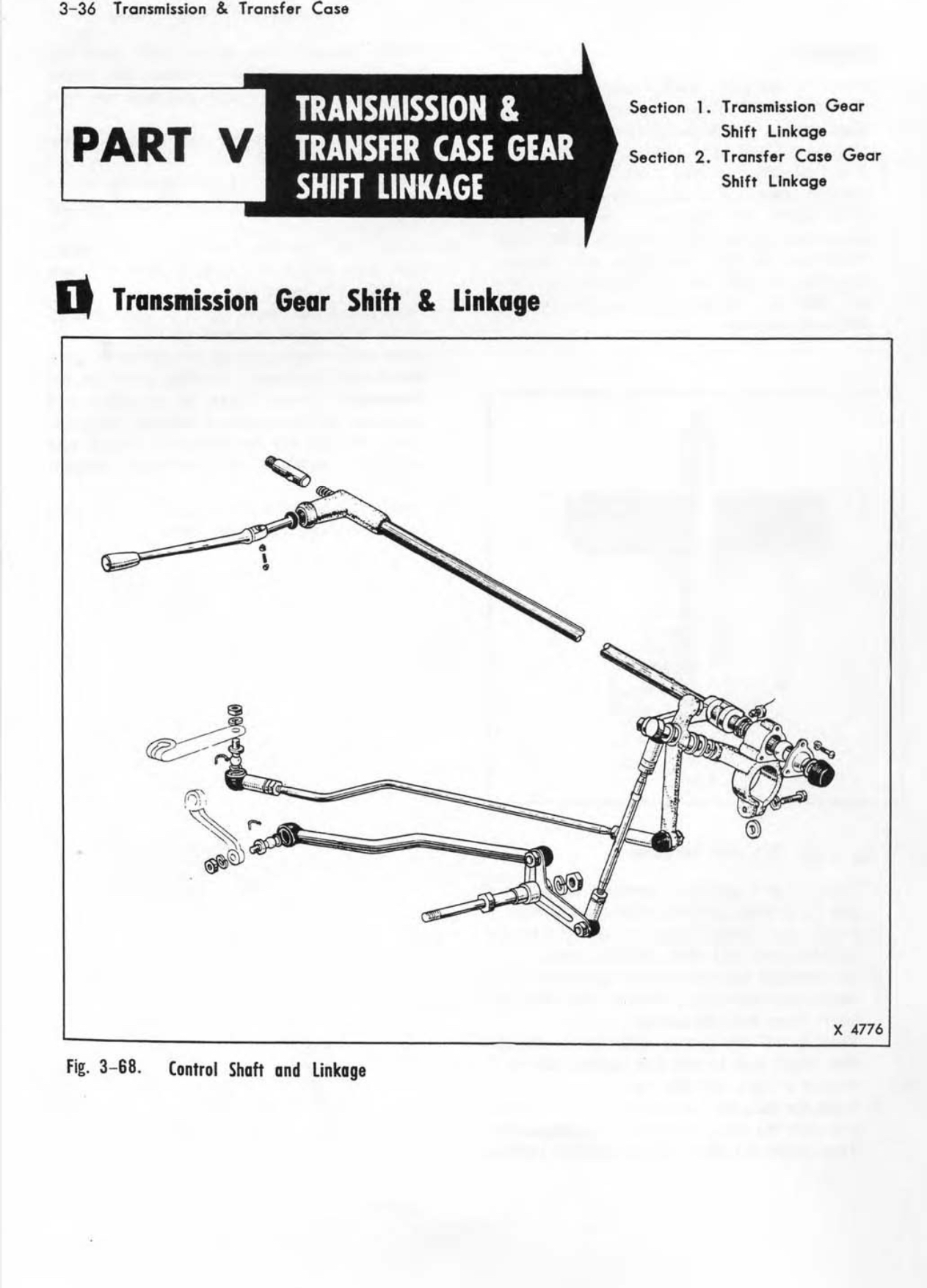

So instead of starting a new thread i decided to see if anyone has had similar issues to me. After a long ( much longer then I would have liked) engine rebuild and refresh, the other night I was able to test drive it for a couple of miles. It is verry hard to shift into 1st and reverse, almost impossible, and second and third are easy enough. I went from a 1F to a 2F in my 69. So any clarification on the adjustments would be greatly appreciated. @Mark Jennings I took a picture of your service manual pages so that i can have them readily available.
The throw between second and third is shorter than the throw between first and reverse, so I would expect that you have excessive freeplay in the linkage. You need to have someone move the lever while you inspect each of the pivot points.
Think of it like a miniature version of a steering center arm and tie rod ends.
