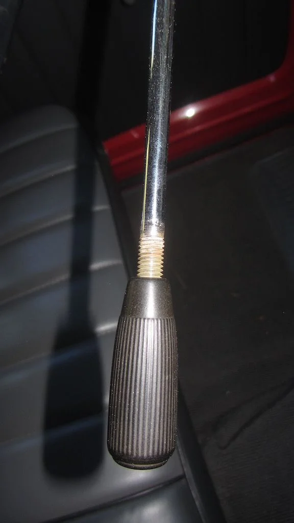

Can someone tell me how the column mounted shift lever knob comes off? The knob is in great shape but the lever is heavily corroded and I was thinking about getting it re-chromed. Separating the two seemed destined to do more damage than good. Any help is much appreciated. 1965 3 speed FJ45
Its threaded on.
Thanks for the assist! With a lot of effort, I was able to get it off without messing up the knob or the lever. Ran the threads with a tap and die set and then put on some anti-seeze compound.
