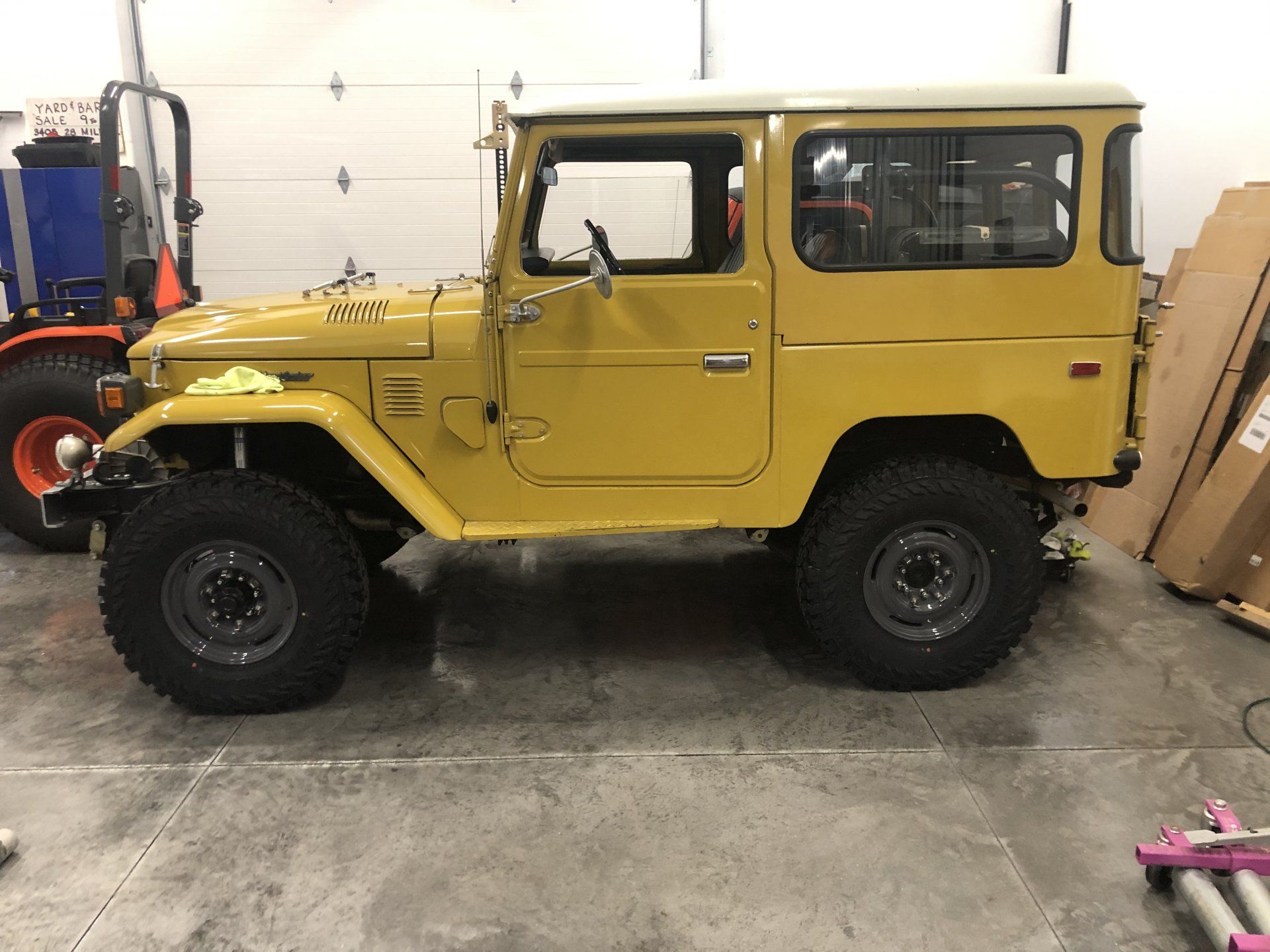

Colonel Mustard refresh and update (1 Viewer)

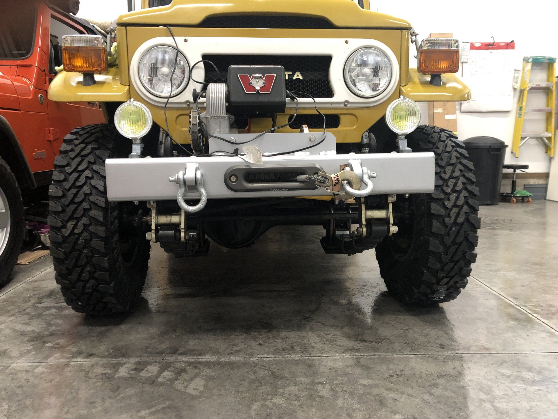

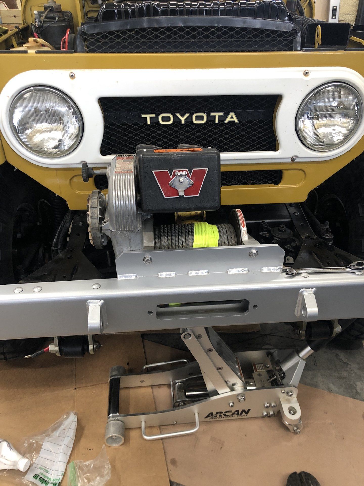

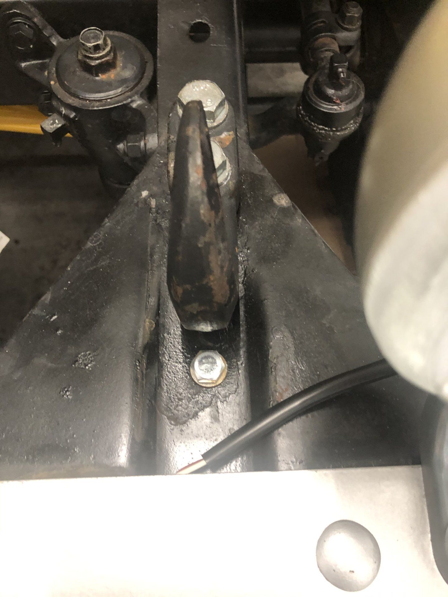

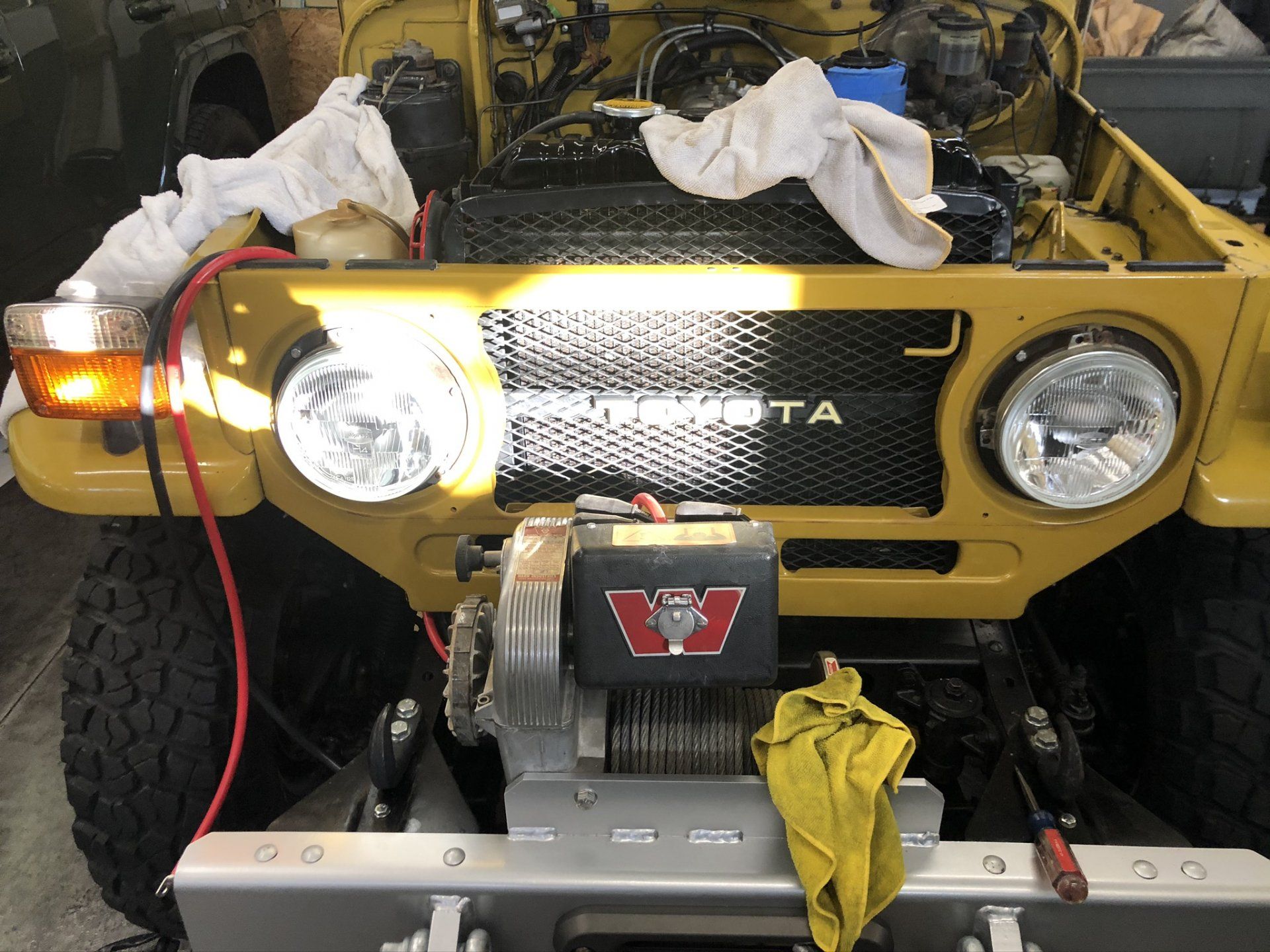

I debated on what fairlead to use, the old roller type or new design, thoughts?
I don't know what you mean by "new design", but for steel cable definitely use a roller fairlead. I have a old steel hawse fairlead in my junk pile and it's all grooved from steel cable. Nowadays, most of them are aluminum.

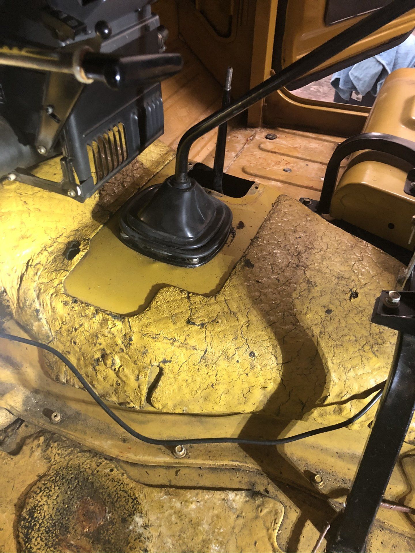

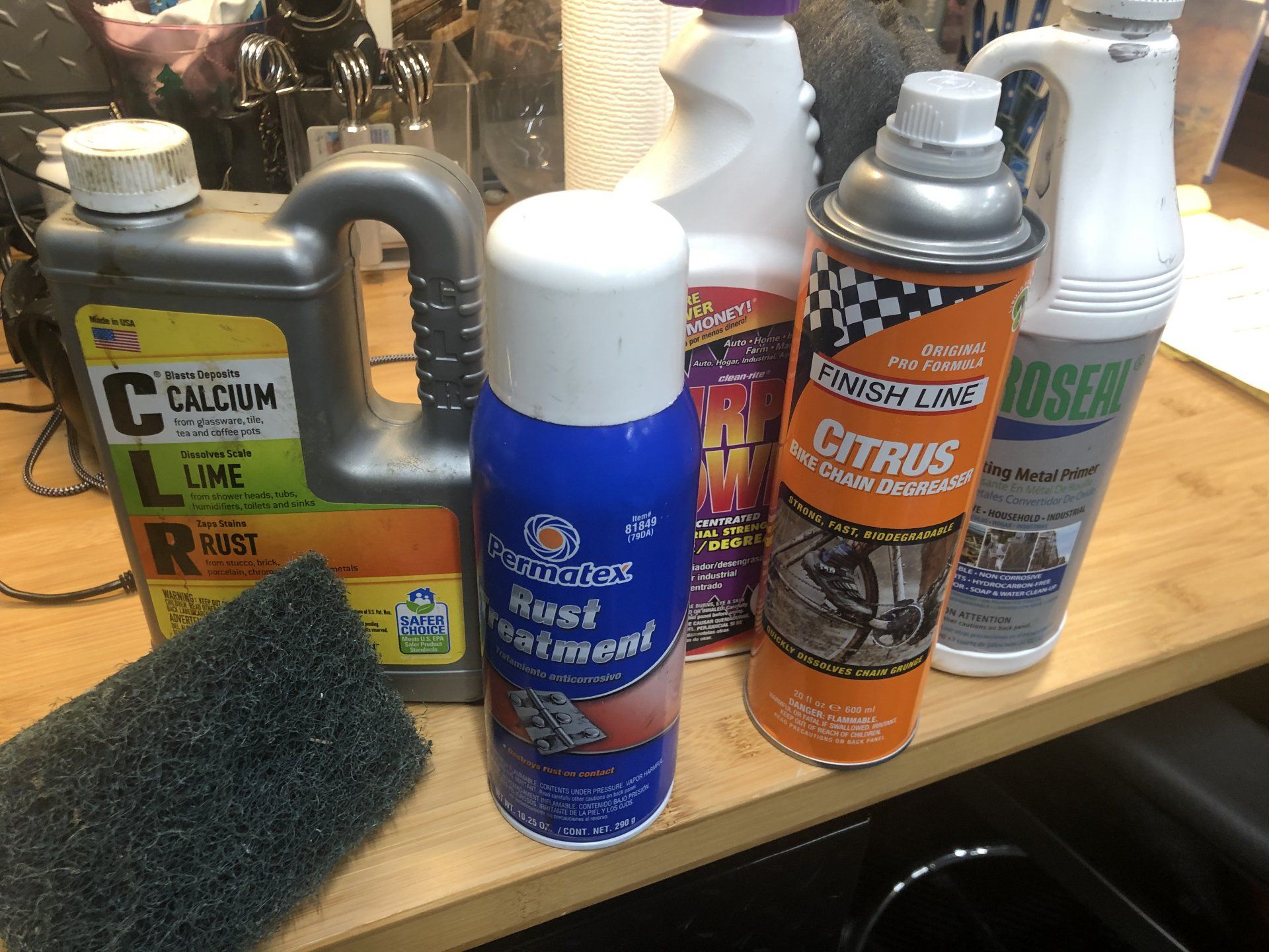

Here some of the items I used to clean engine compartment and interior. Most have been suggested throughout previous forums.
Not shown are the various brushes I used including tooth brushes and various other sizes and intensities .

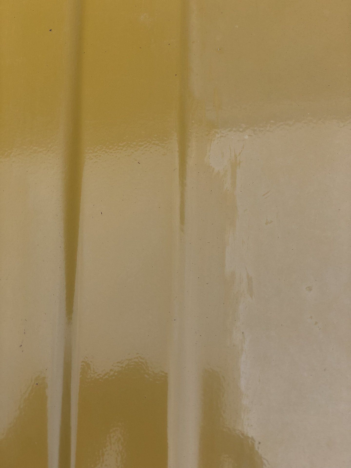

The truck has mostly original paint. So I soaked it with Mcguires #7. The key I found is to let it sit overnight and remove with a Terry cloth. I did this process several times on the exterior as well as areas of the interior. I was please with the results.

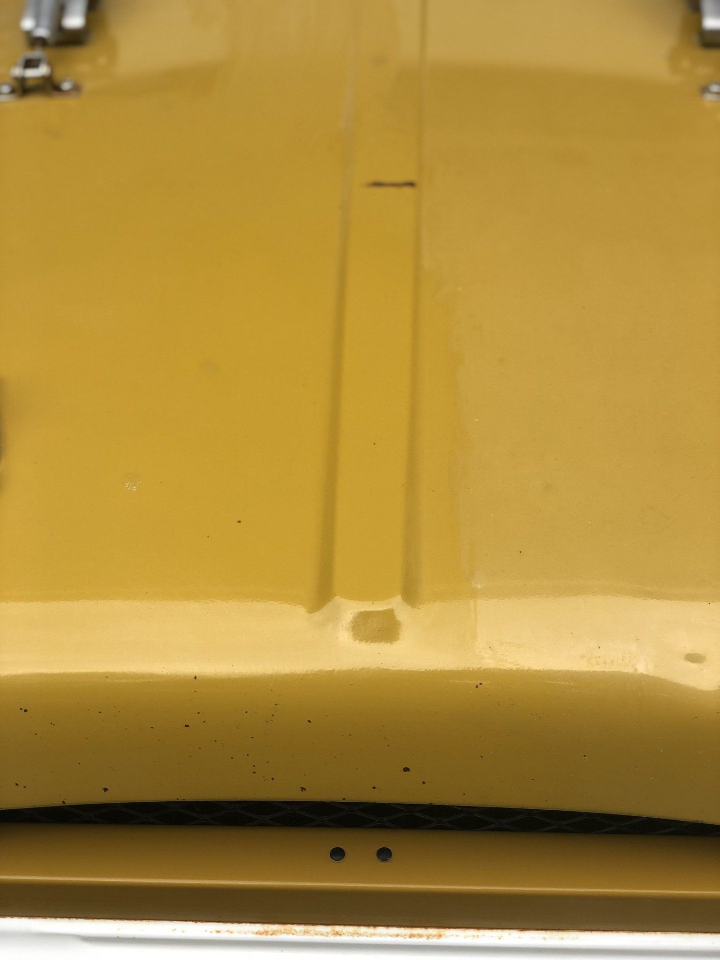

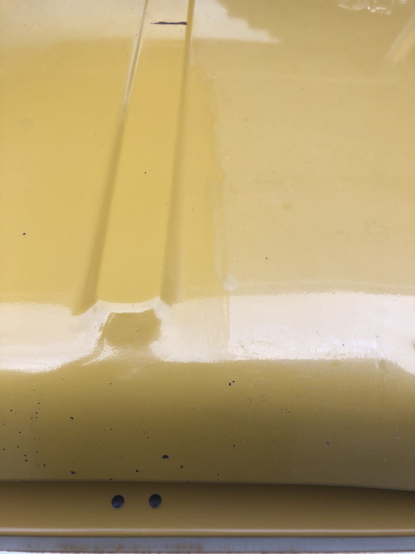

You could keep that divit in the hood from getting any bigger by installing a roof drip channel cushion, part number 63118-90300 still available from Toyota for 3 bucks.
Mine as well install a set of new Koito headlights while I’m doing all the front end upgrades. What a cost effective and major improvement , I highly recommend. Lots of threads on this one.

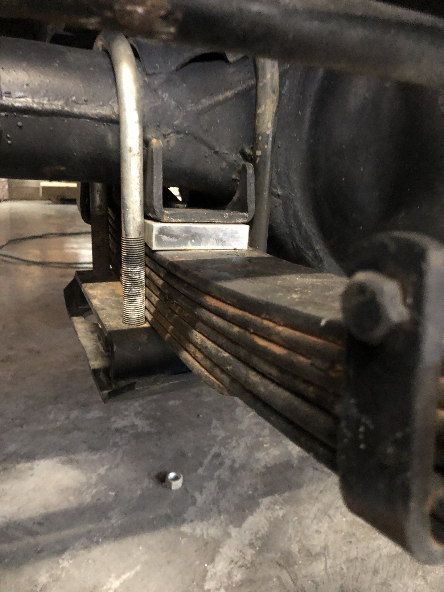

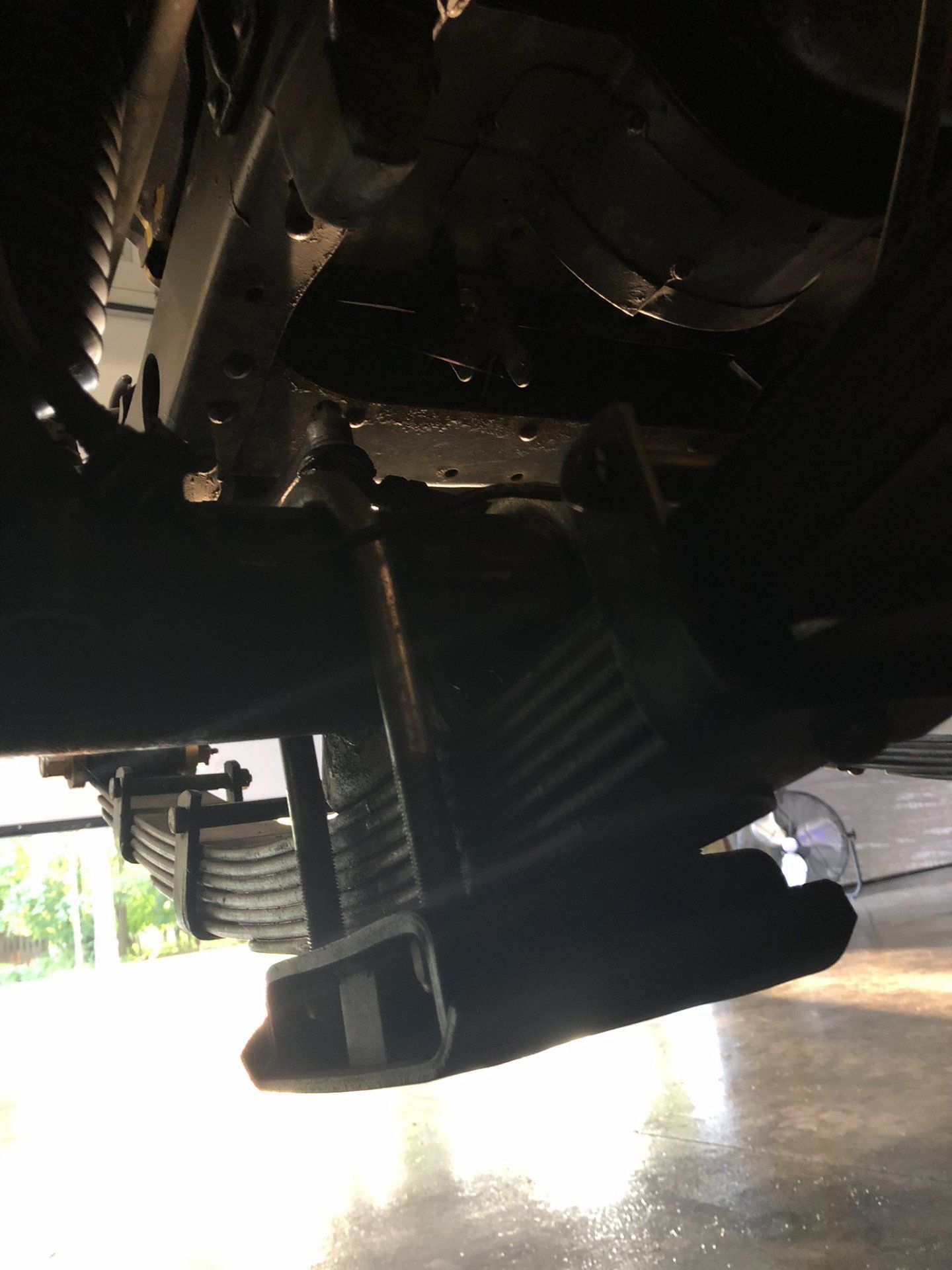

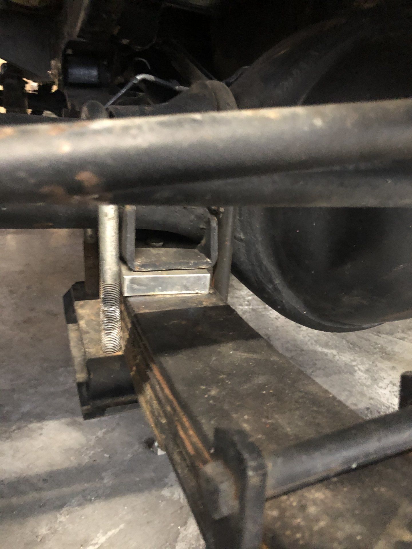

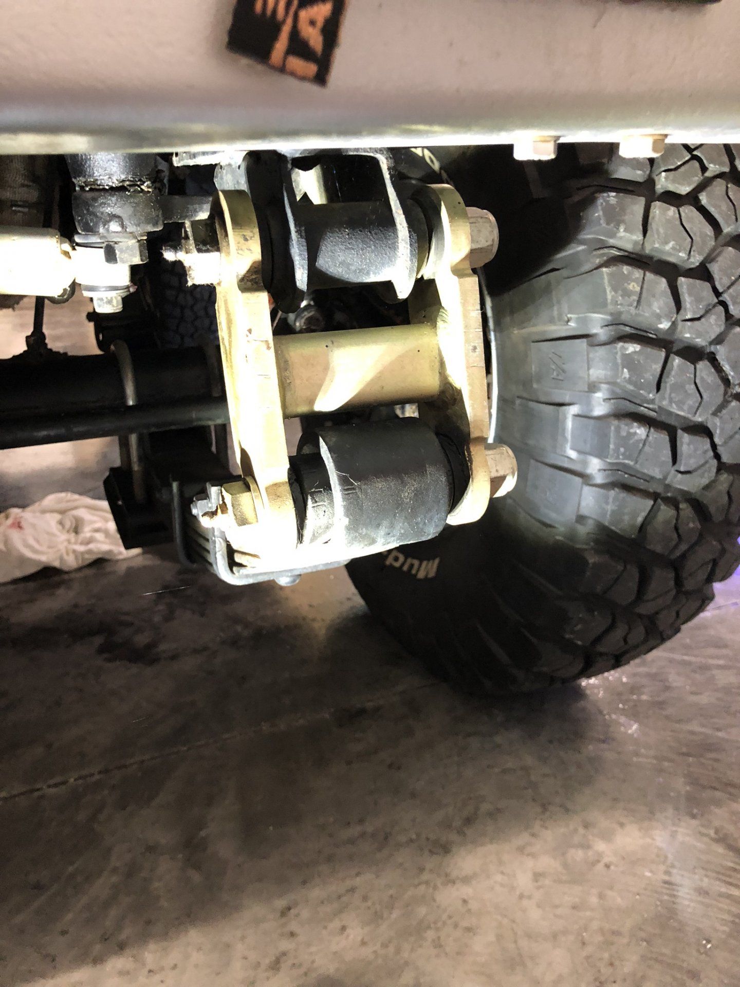

PO did lift and shackles w/o any castor adjustment. Truck sort of zigged and zagged.
Installed 4 degree wedges and had to lengthen u bolts so had some made
