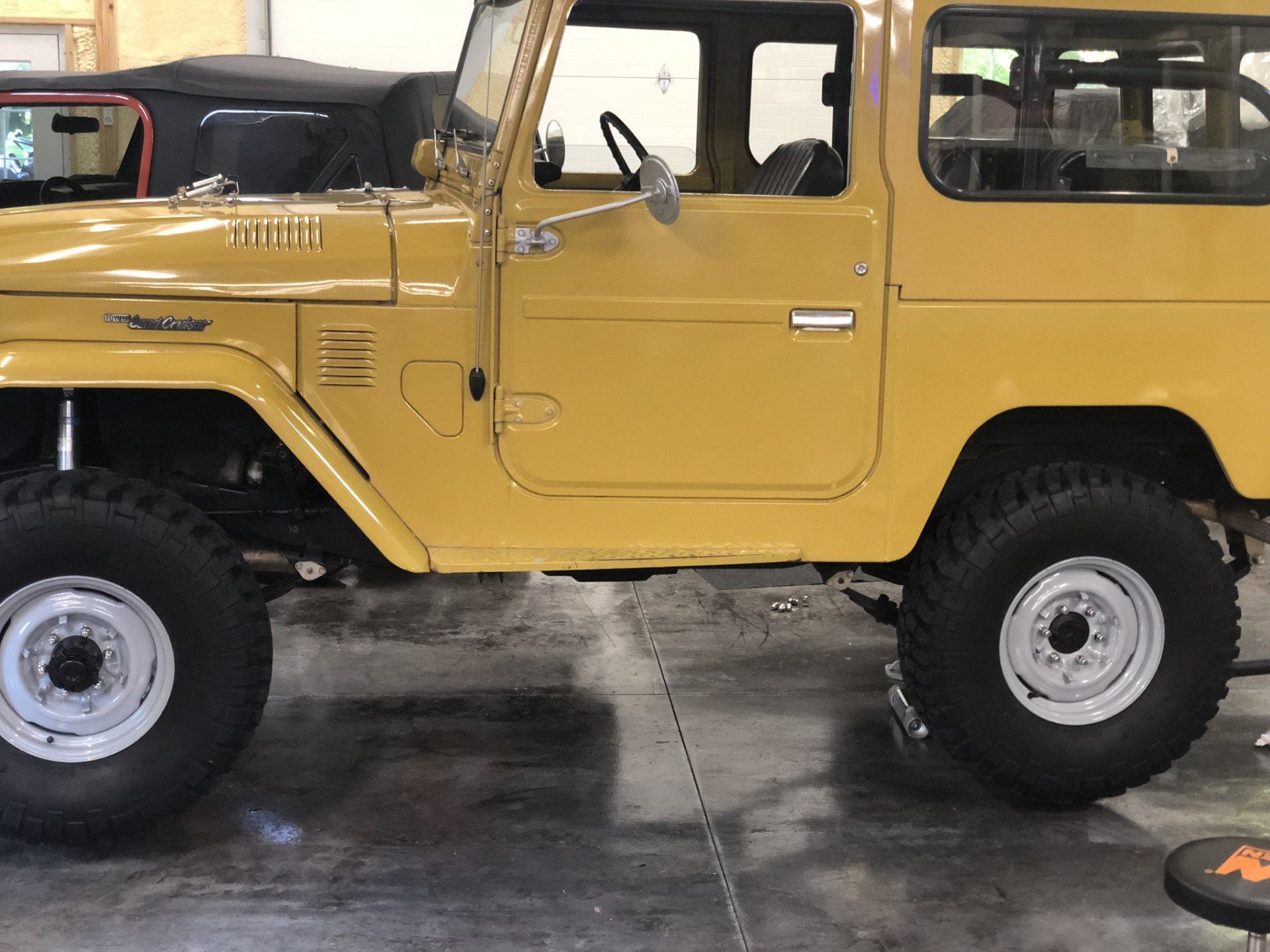

How I got it
That 1st photo doesn't look like Michigan. It looks more like the Bay Area, where I'm from.
Does it have a late model wiper motor? The motor cover looks modified.
By the way, nice 40.
Yep as mentioned in my ad I got it in California up by San Francisco. It is a 1975 and I’m not sure about the wiper motor.

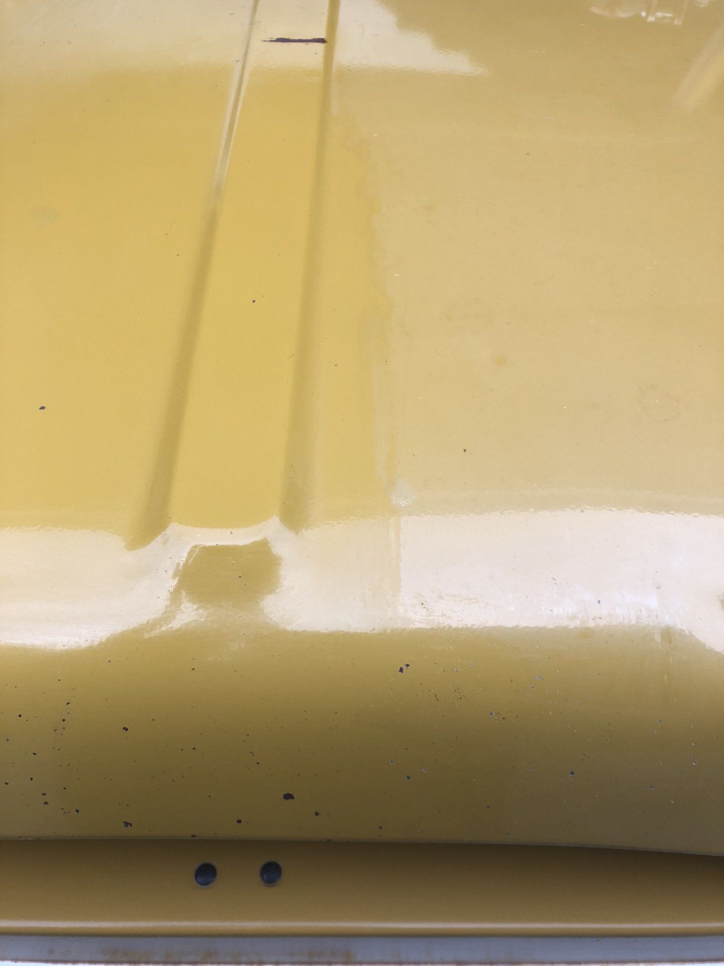

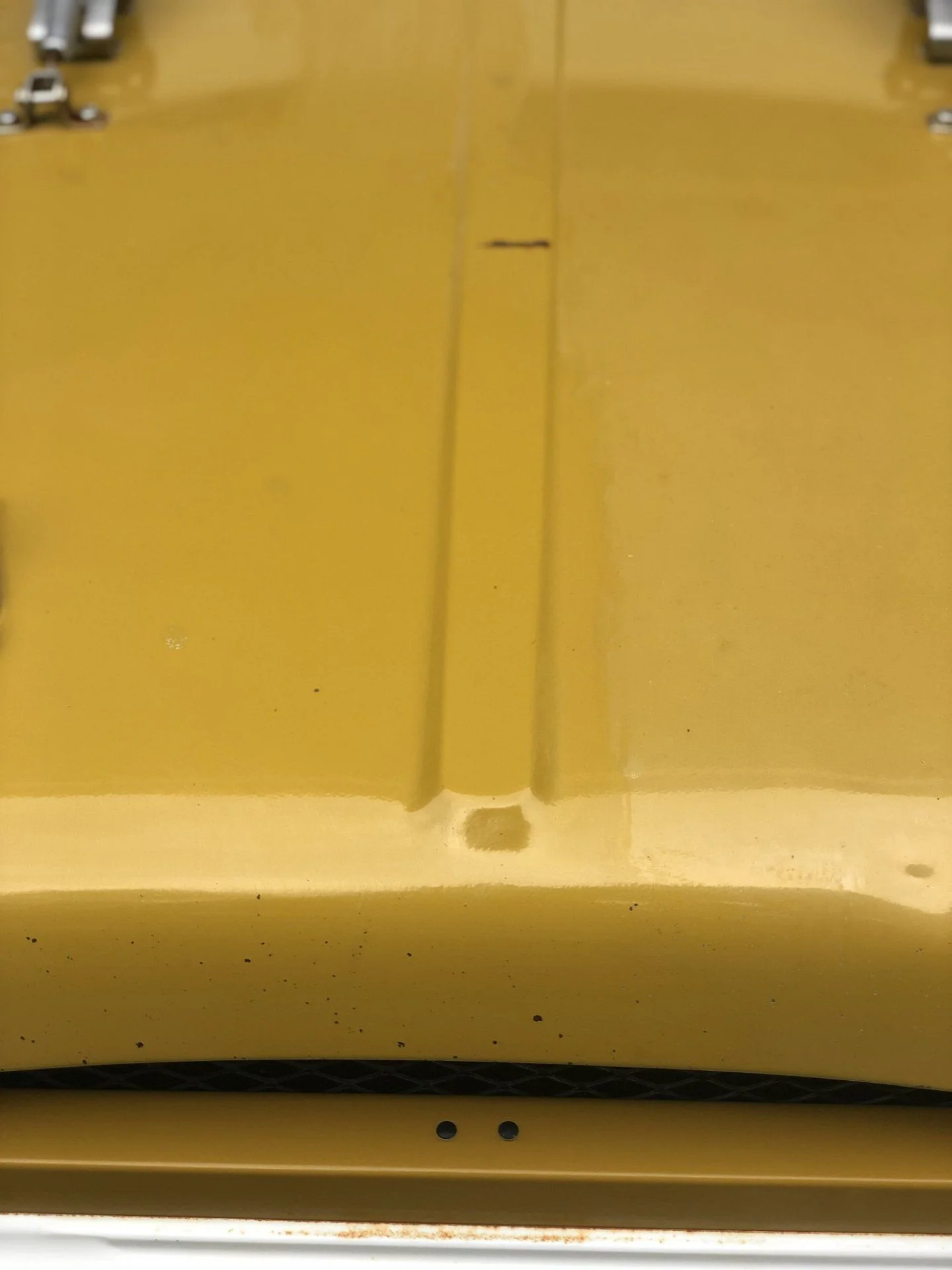

Ok cleaning time
Paint first
The truck has mostly original paint. So I soaked it with Mcguires #7. The key I found is to let it sit overnight and remove with a Terry cloth. I did this process several times on the exterior as well as areas of the interior. I was please with the results.

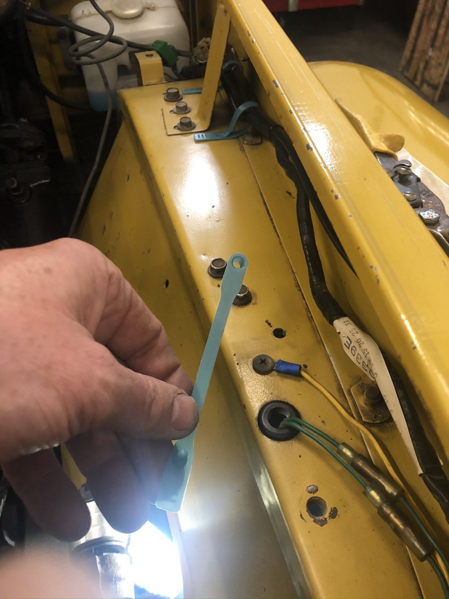

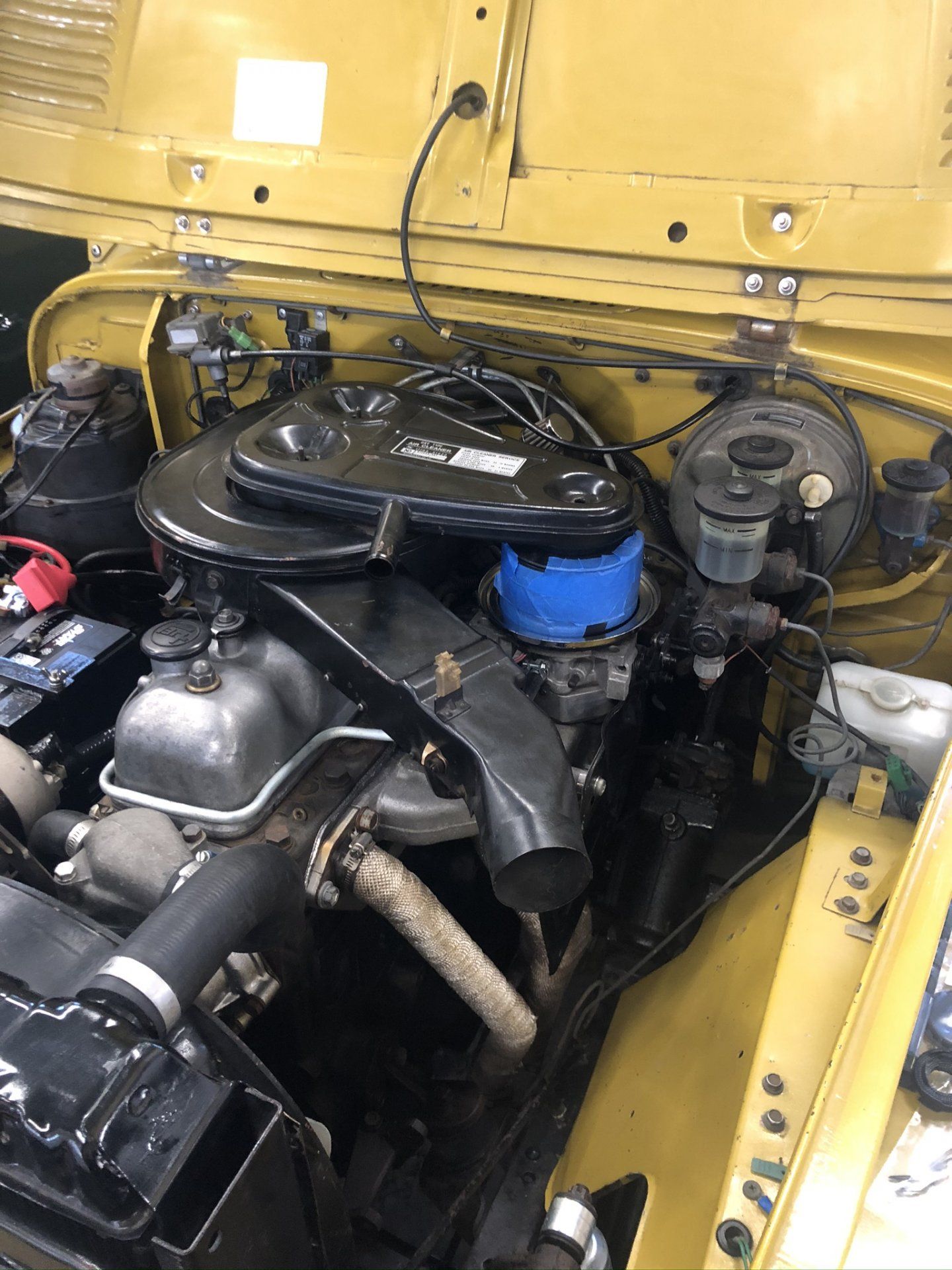

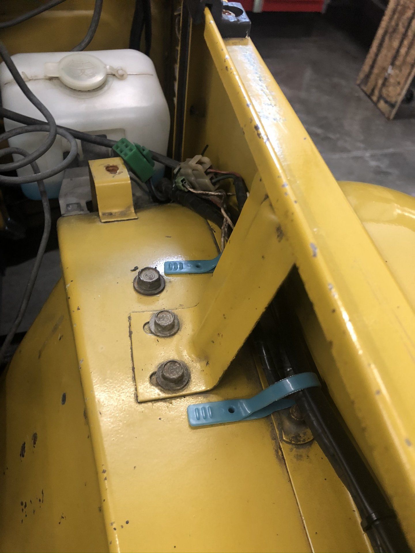

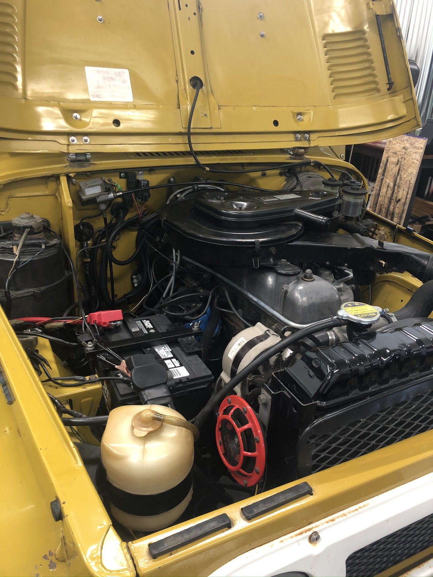

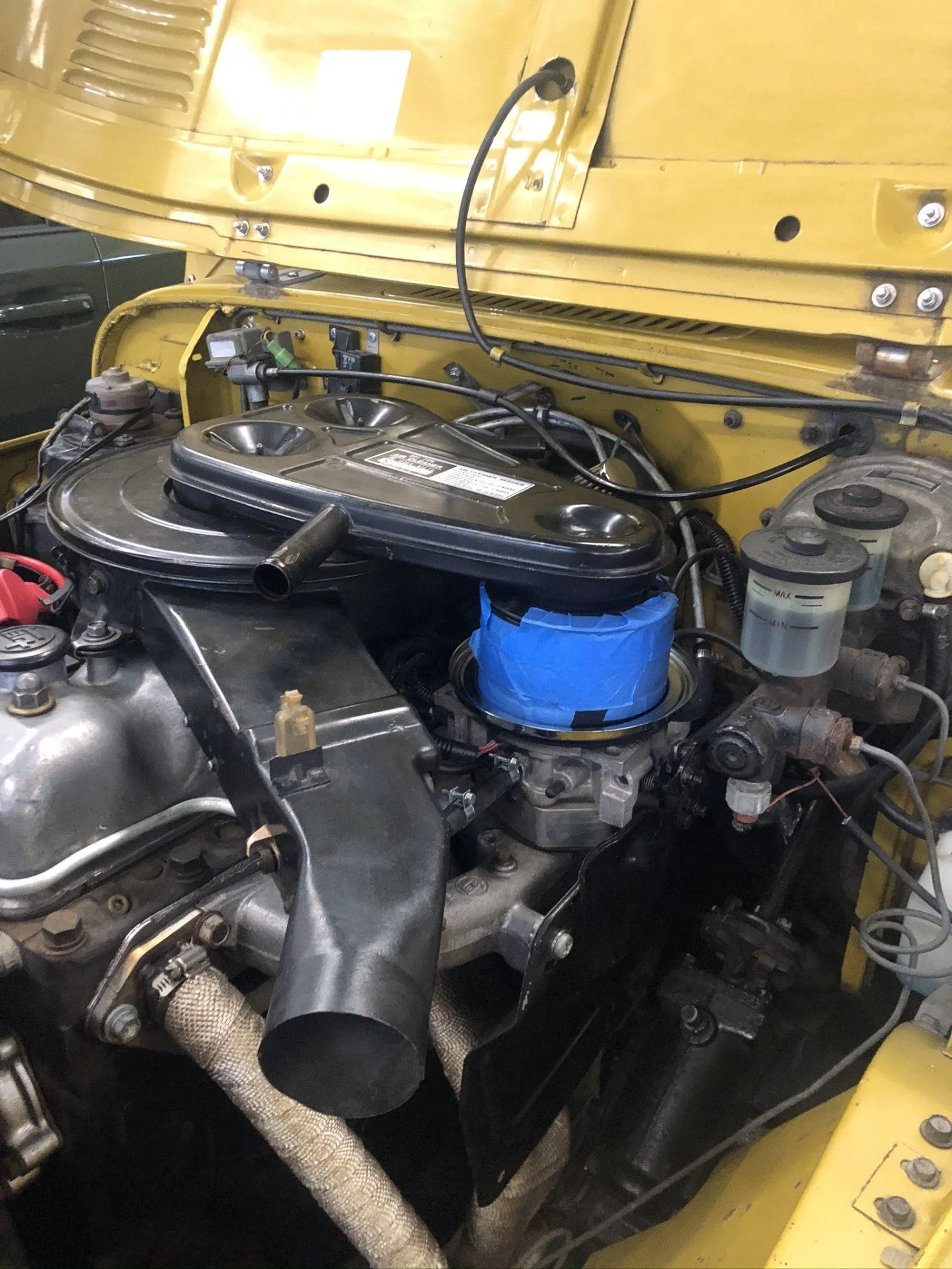

Ok moved on to engine bay:
This included all new power cables as I’ll be adding some “stuff” to front end.
Clean under hood and engine bay
Reroute fuel lines
Cover wiring harness as needed
Replace green straps
Put original air cleaner back on with custom adapter for Howell efi
And more

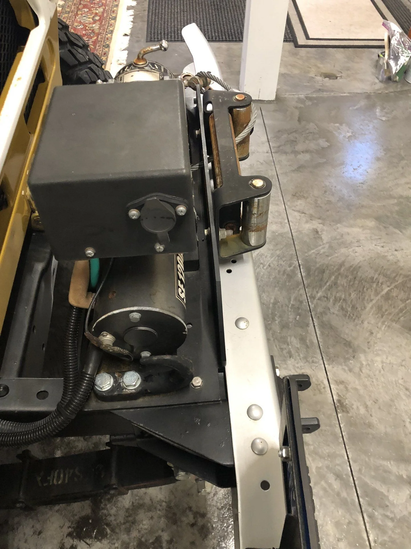

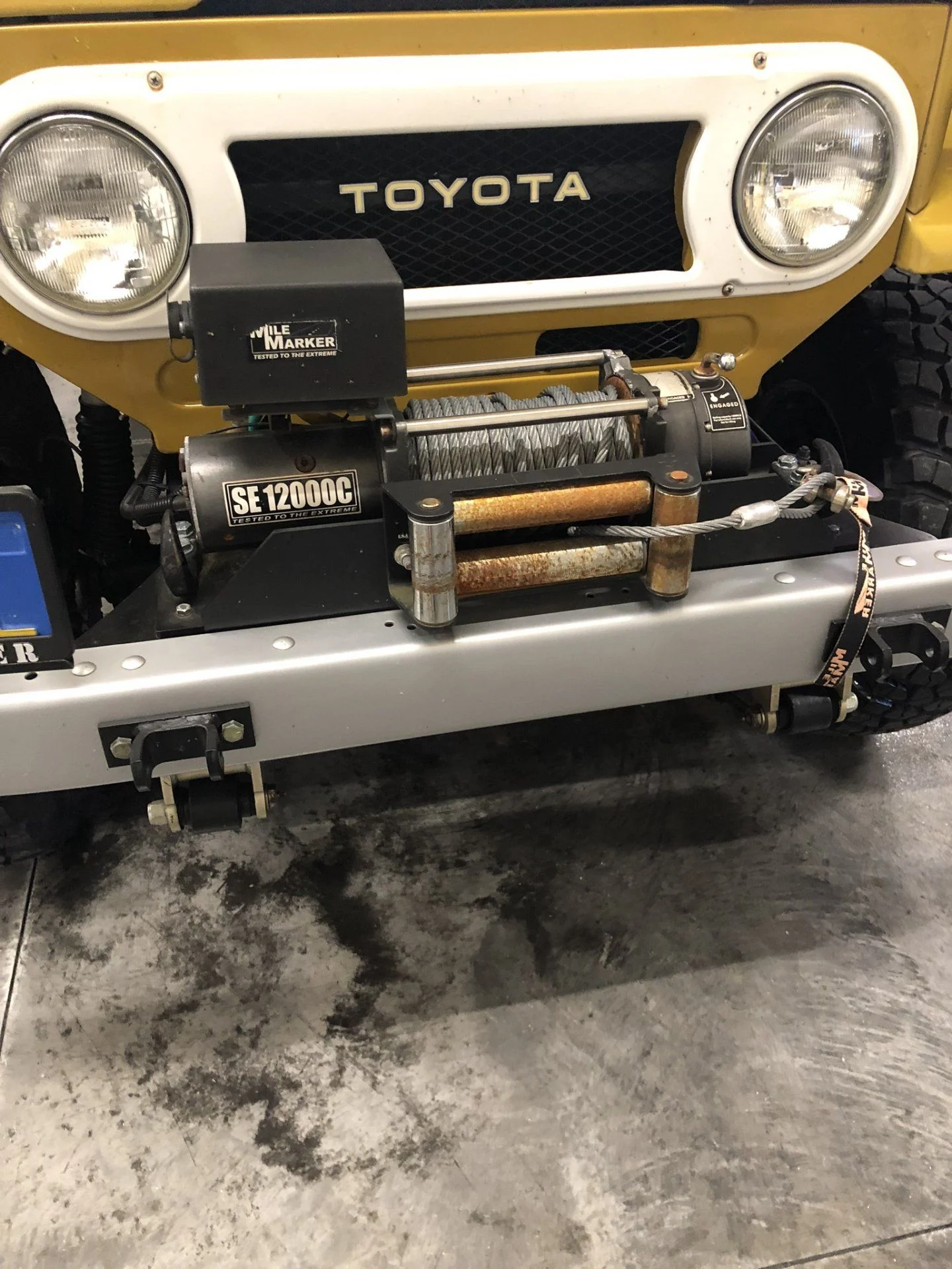

Time to put on a proper winch
Here is what came on it.
I also decided to upgrade power cables and bumper.
I was fortunate to pick up a rebuilt 8274. I really like the period corrective ness ... is that a word?
