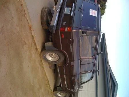

I registered this 1984 FJ60 in the cruiser registry the other day and after talking with my bro wadeclinton, have decided to do a build thread on it as well. I've started a build thread on this 60 on the Marlin forum as well. I have been a member on that forum for a while so pics are unlimited for me over there, here I need a few more posts before I can post alot of pics. This forum seems to have alot more folks involved with the cruisers so I thought i'd post up here as well. Once I get ten posts I can put up an avatar and more pics of the crusier as the build proceeds.
More info
The work that I have done so far is rip all the 27 year old faded brown turned green carpet out. Started replacing the interior rear panels with aluminum tread plate cuz the po had hacked em real good trying to put some blown 10" and 6" speakers back there. I think they didn't pull the panel off to check where the supports were cuz there first attempt put the speakers right in front of one, no worky so to cover up the hole they just faked it by putting 6" speaker covers over the hole. I also pulled the stock bumpers off, getting ready to fab up heavier duty ones. If anyone is interested in them they are available. the front one comes with a push/light bar. The 60 is down at Michael toyota in fresno getting the rear seat belts and fuel tank/filler lines replaced on recall work. It smoked a little when I picked it up but since then I have done a full tune up, replaced all the water hoses except one right above the water pump super hard to get to as well as one on the driverside fire wall hard getting to as well. I have also replaced the exhaust system from the headpipe back, it wasn't too hard. I ordered all the tube and flanges from summit cat as well, only thing that wasn't newish was the flowmaster I had laying around but it's in good shape. As soon as I get the 60 back from the dealer I am gonna have the carb rebuilt, It kinda hesitates. That should be the last thing to do, before I take it to get it smogged.

Got the cruiser back
I got the cruiser back from the dealer on friday. The tank looks good but for some reason the site won't let me attach photos?
