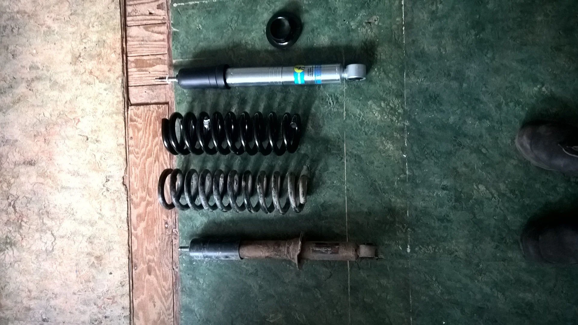

I installed the shocks with the circlip in the second groove which according to the piece if paper that came with the shocks that should give it a .67" lift. I think it just compensated for my bumper.
Old and new

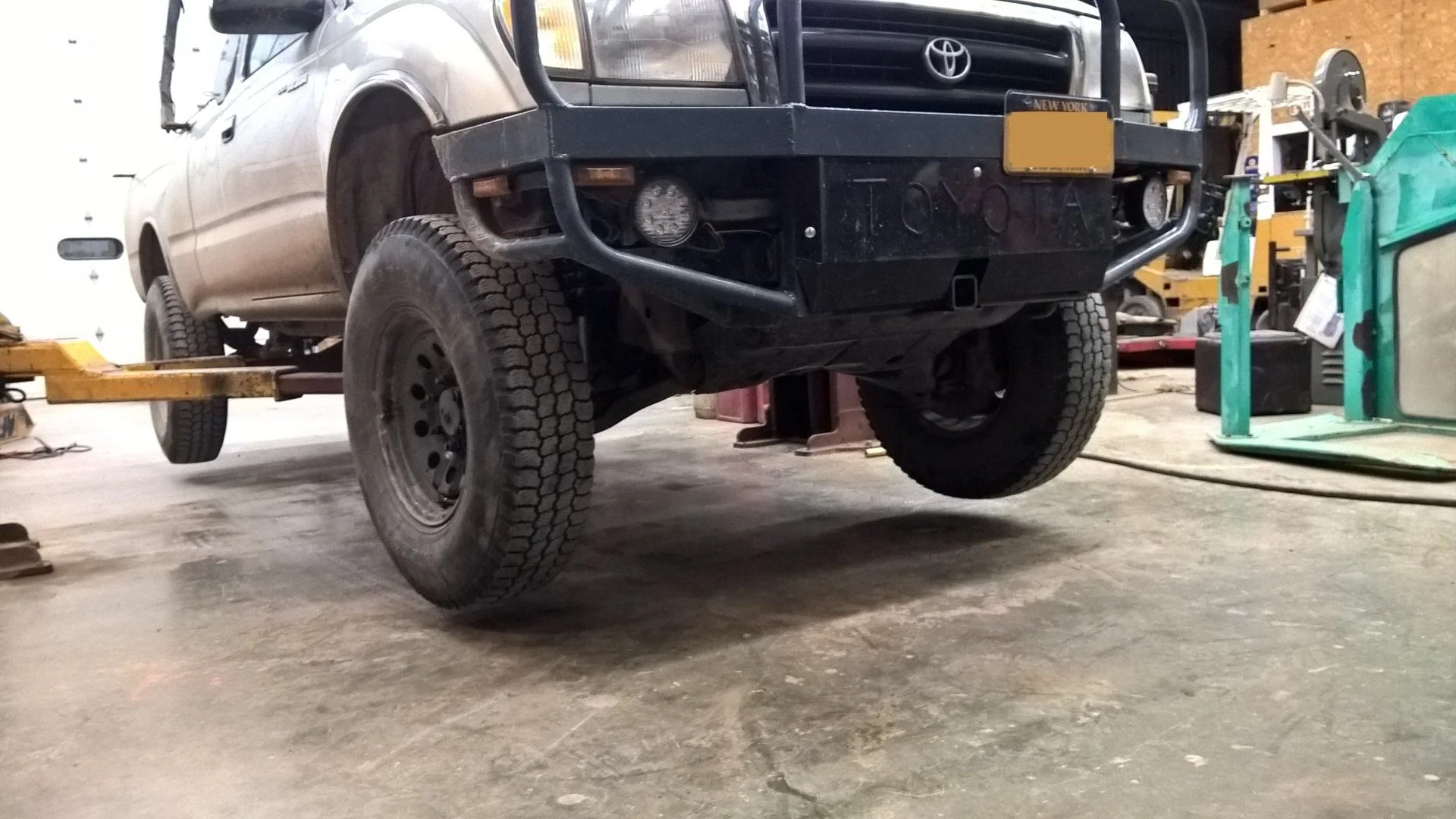

Truck's weight on and off

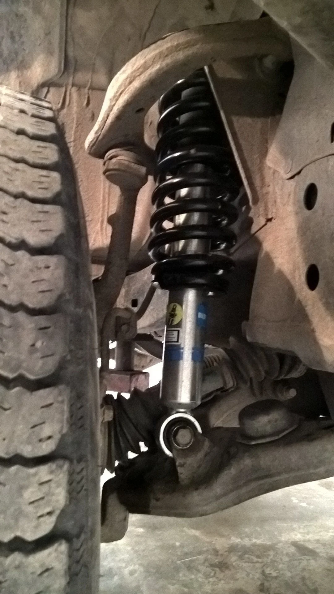

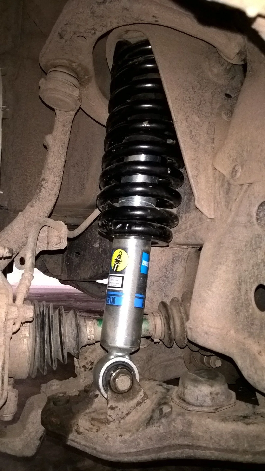

I did end up moving the circlip up one notch in the front Bilsteins, to make the CV shafts about level. Not sure how much lift (if any) I got from them. Bear in mind I have a 120lb bumper on the front so you may not need to go so high if you have a stock bumper. So far I've been happy with the 5100s with Moog coils.

From fender to ground i was at 33.75" before up front but set the new 5100s at 1.5" and now it is at 36.5" up front
Once I get the new tires that have tread and are 265 75r16s it should add another inch or so.
