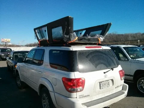

Yup, pick n pull special. Happened to be 50% off today, so after a little help from one of the friendly junk yard lurkers, I walked out with it for $46.30. Thanks to 2f for the tip they had a 1st gen.

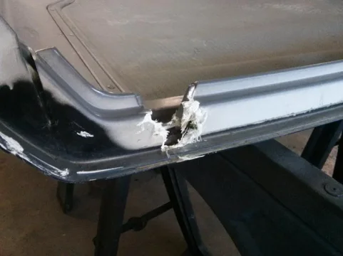

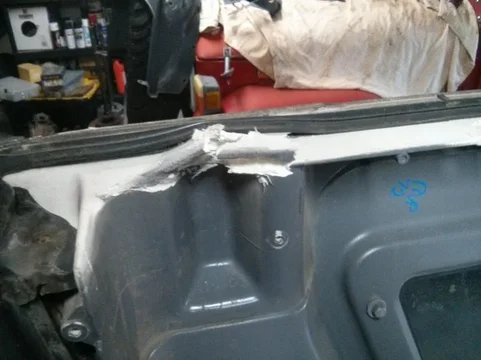

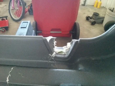

It needs a little fiberglass work. It was already pulled off the truck when Tornado and I got there. Whoever pulled it attempted to do so without removing all the bolts...

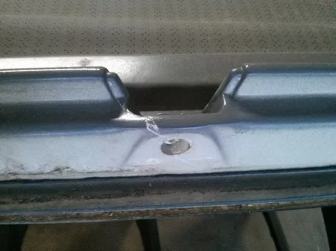

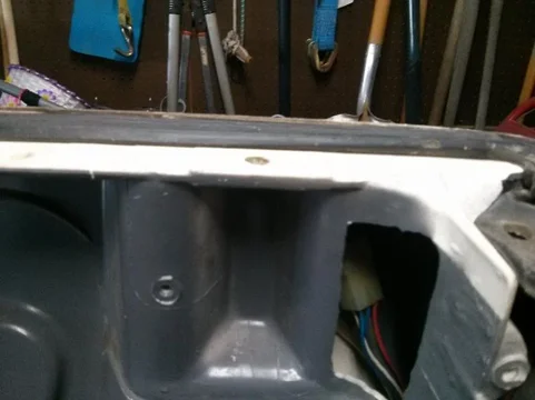

So time to add fiberglass work to my skill set. One bolt hole broken out up front, one in back corner, and a couple cracked. Also attaching pics of how they are supposed to look. Any ideas on repair would be appreciated.
Wouldn't it just be easier to change glass? I thru 2 of those away a few years ago!!
Well the same trees that took out the glass did some other damage, so I'm repairing a top either way.
youtube fiberglass repair. I am ok at it, but no pro.
my two cents that is half price today..... make a mold of the old one you have that is in good condition, then use that mold to make an accurate duplicate. make the mold with spray foam or plaster of paris, use a little oil so you can break off the mold.
