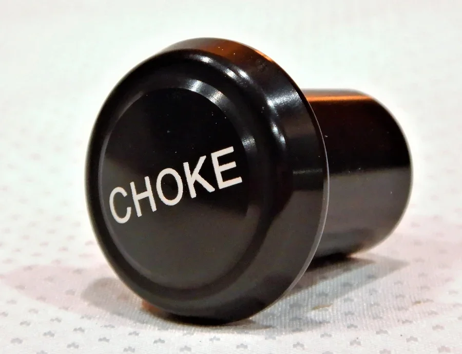

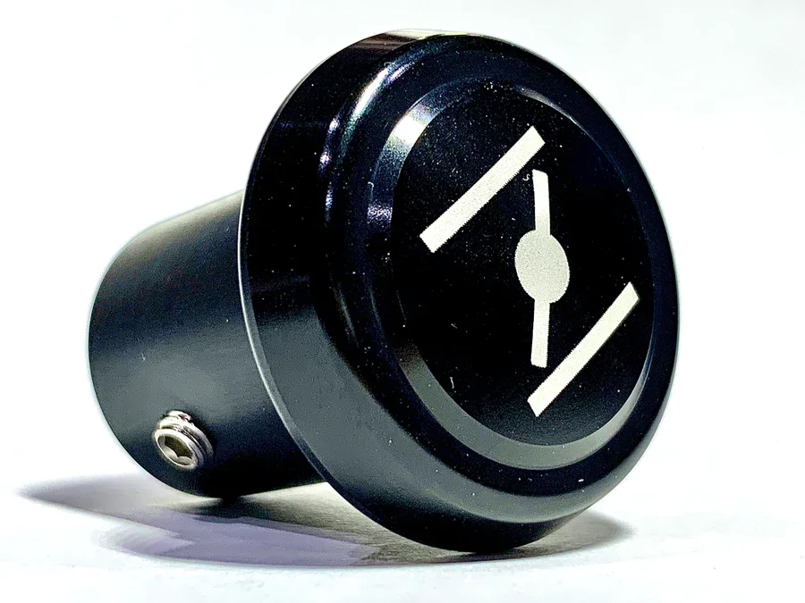

i have BOTH FJ60 CHOKE CABLE Knobs ,
reproduced in anodized BILLIT Aluminum CNC machined .......
stainless steel recessed HEX KEY and set screw included as well ........

NON-USA-SPEC. INTERNATIONAL Language Butterfly LOGO Billet Aluminum CHOKE Knob w/ Hex Key & Stainless Steel Set Screw 1980-1987 FJ60 PART # 78303-90A03 - VintageTEqParts.com
CHOKE PULL KNOB - NON-USA-SPEC. INTERNATIONAL Language Butterfly LOGO - Part # 78303-90A03 - TOP SHELF QUALITY - 100% Faithful Reproduction...

USA-SPEC. TEXT FONT LOGO Billet Aluminum CHOKE Knob w/ Hex Key & Stainless Steel Set Screw 1980-1987 FJ60 PART # 78303-90A02 - VintageTEqParts.com
CHOKE PULL KNOB - USA-SPEC. CHOKE FONT TEXT LOGO - TOP SHELF QUALITY - 100% Faithful Reproduction Billet Aluminum Anodized - ...
