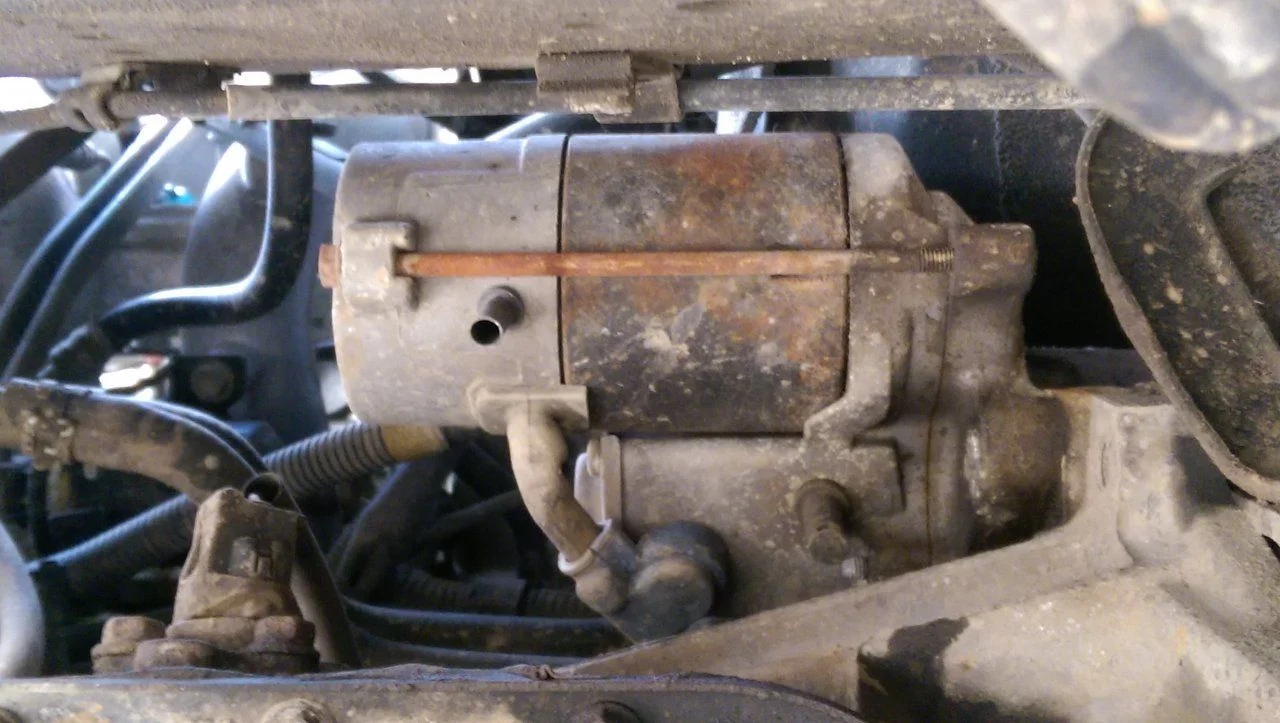

Can you see the starter? Does it look like it has been replaced? If not, how many miles are on the truck (not a great measuring stick, but close)?

Haven't looked at the starter yet but I'm at 153,080 miles this morning. I get off at 1 today so I'll look at it when I'm at Autozone.

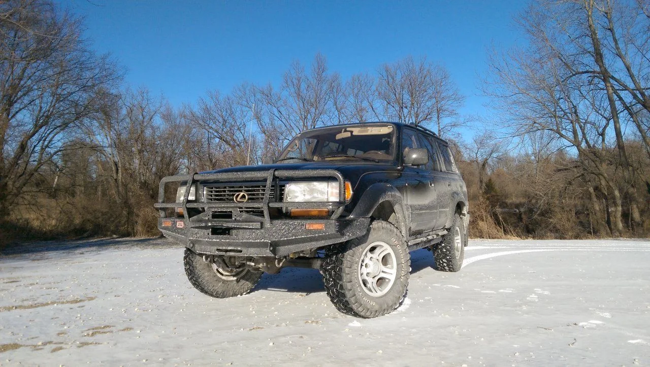

Had to drive my girlfriend to the airport in some slush Sunday morning at 530 and I thiught this was kind of cool. Here's a pic for all you guys
Nice black truck! :flipoff2:
If you were good at photoshop, you could make that picture look like you was driftin'... :cool:

Haha that and turn the picture sideways at a cool angle! Now that's the ticket...
