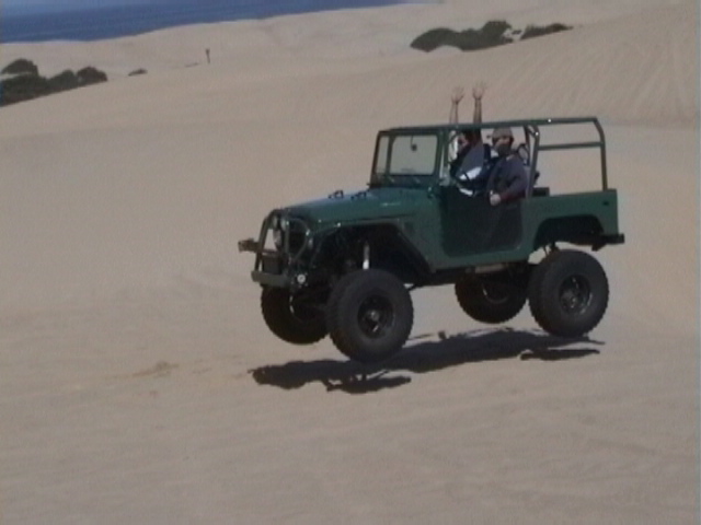

Coil suspension in a 70's 40.

Ken Hanna has an excellent coil suspension on his FJ40. He's even mentioned putting kits togther.

Enter and click "Outback" for a good reason to go with coils.
I'm totally impressed with links and coils, maybe even for a FJ60, who knows some day...
P.S. look for a article in an old FourWheeler magazine by Fred Williamson IIRC. About 6 months ago? Good stuff.
Best of all, coils are good for more than rock crawling...

TJ 4 banger fronts
Oh yeah, 23" to the botom of the frame with 40" tires ;)
