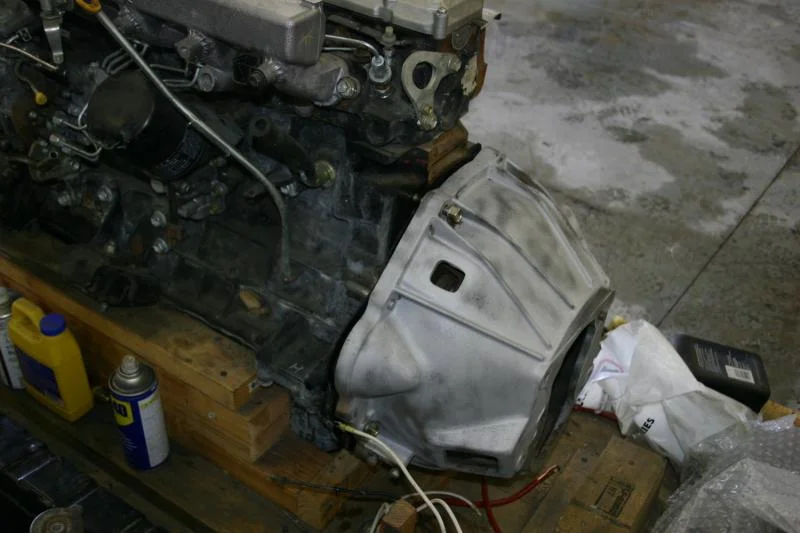

Basically, I've got an aluminum bellhousing that I want to clean up. The red dirt from Australia is just plain super tough to clean. I've soaked it in the parts washer (solvent), I've scrubbed it with solvent, scrubbed it with purple power, and it just doesn't get clean enough for my anal-retentive self. So, I've lightly hit it with the abrasive cabinet (glass beads), and it gets the dirt off without a problem, but obviously it needs a coating to stay clean for years and years.
So that's my question here. What sort of coating should I use? I have a powder coating oven that it should fit in, and I generally prefer to PC parts over paint, but I'm not dead set on anything.
  • Just clear coat over the aluminum?
  • Silver
  • One of the cast aluminum paints from Eastwood or something
Here's how it looks with a little blasting right now:

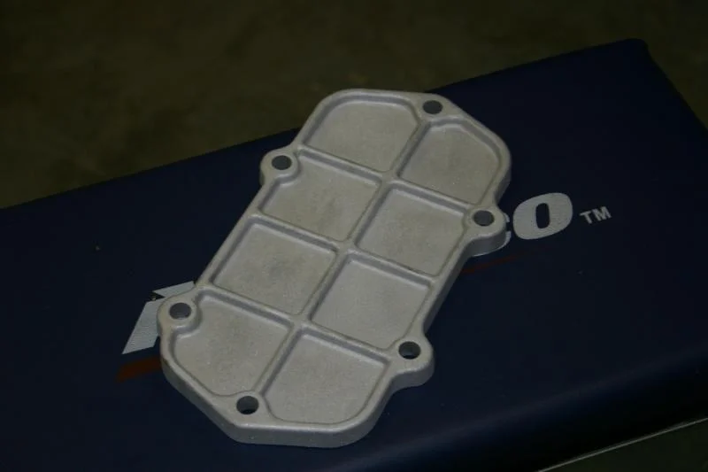

I decided to do a little test with some spare T-case parts (PTO cover) just to see how it does...
Here's the cover after abrasive blasting (composite/glass beads in the cabinet).

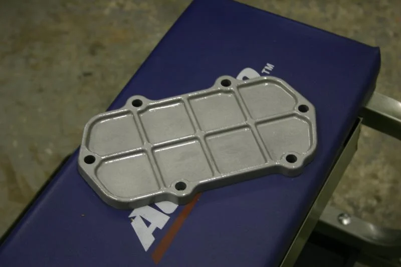

I then used a clear powdercoat layer on it (Caswell's clear, I think)

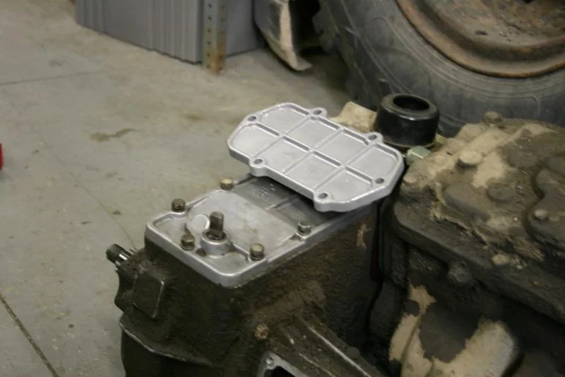

And just a comparison, the PTO cover setting next to the to cover, which did clean up very well using solvent and purple power.
I think that will work. I like that the coating doesn't end up absolutely uniform.
