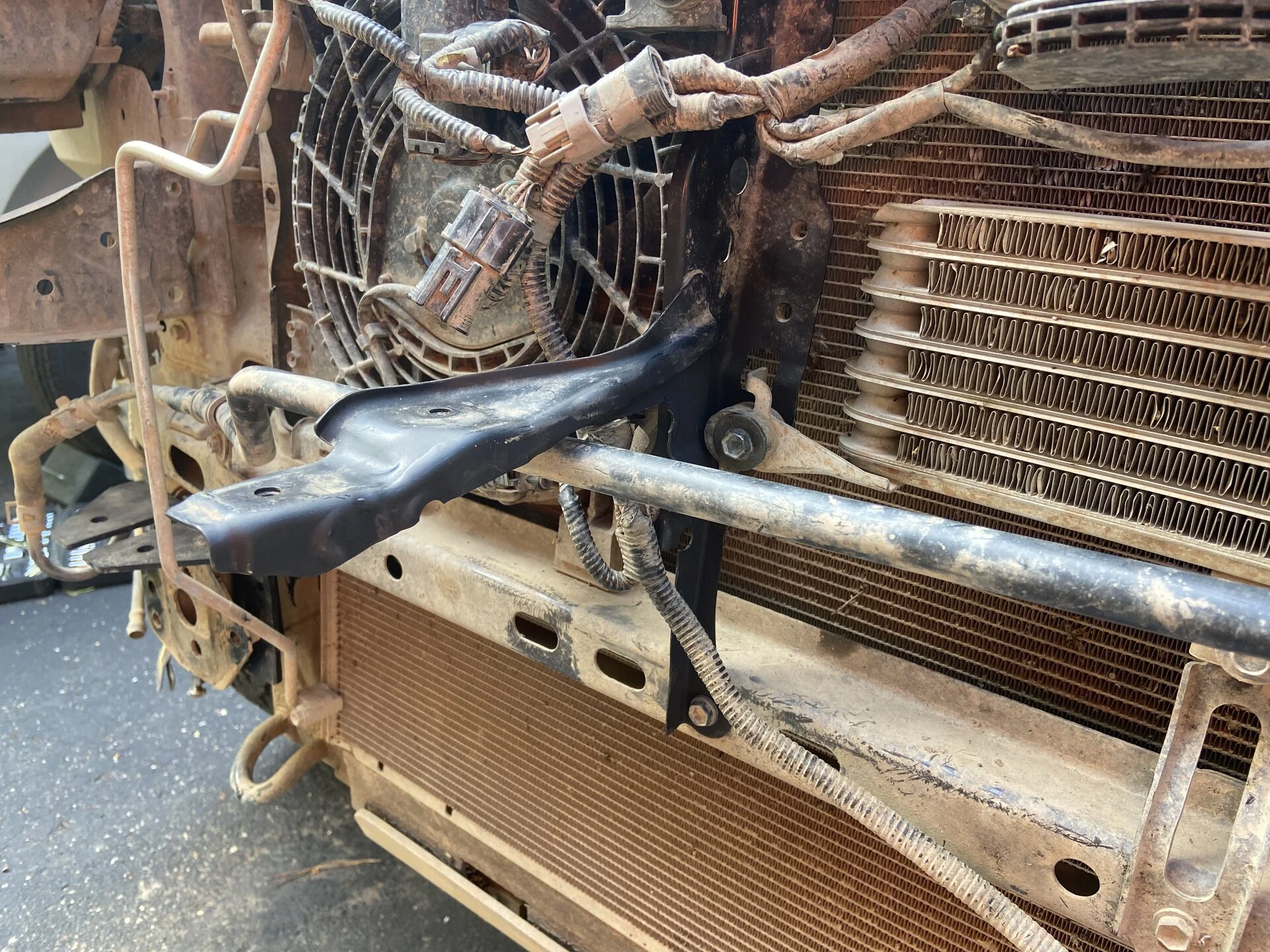

I assume you had to remove the horizontal metal brace behind the grill? For my Victory that brace stays in place, along with the plastic "pockets" the grill ties into. You can see the horizontal brace in this picture.
If that brace is gone, I would suggest creating a brace from the grill to the vertical brace in front of the condenser. You might be able to utilize this piece that went between the aforementioned horizontal brace and the vertical brace, but may have to lengthen it somewhat if the horizontal brace is gone. Or make a new one. And, of course, you will have to figure out how to tie it into the grill.

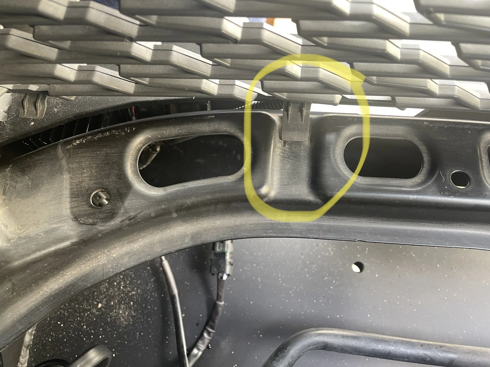

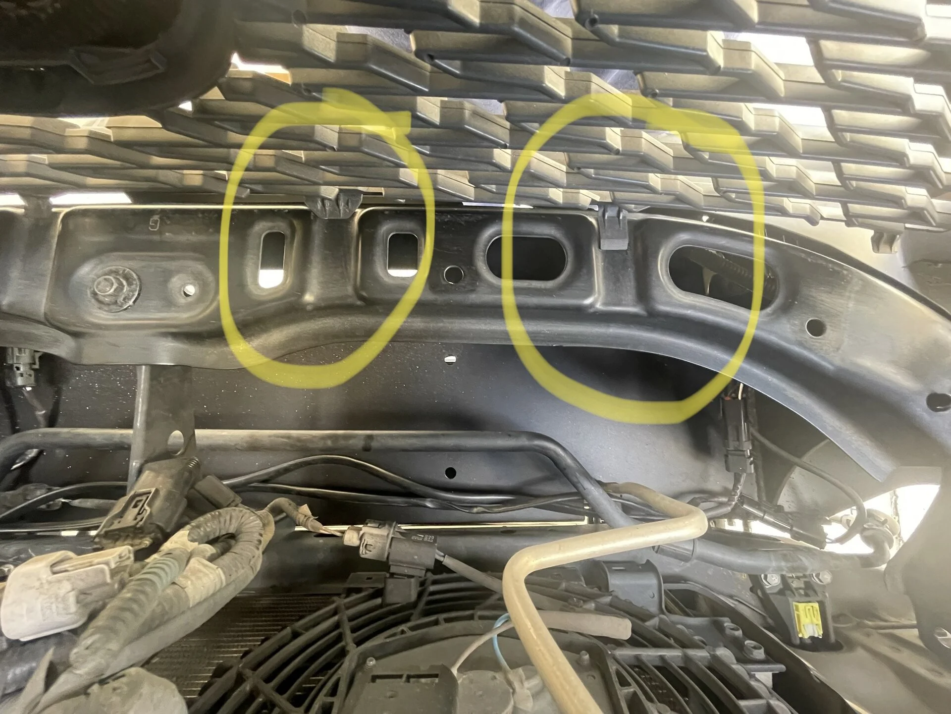

Here are the pics of the grill installed. The bottom tabs are circled.
Try this on a couple of them and see if it feels right. Drill a hole 5/32 thru the through the tab and metal tabs that are over the metal frame. Put a 1/8 zip tie in from underneath.
Then take the head of another exact zip tie and cut the tail off. Slide the head down the tail of the first zip tie til it’s almost tight. This should hold the grill I place. . If it feels good do the others. You can make a plastic tab extension for the tabs that need to be longer. Let me know if this hack works for you. Thanks Anthony
