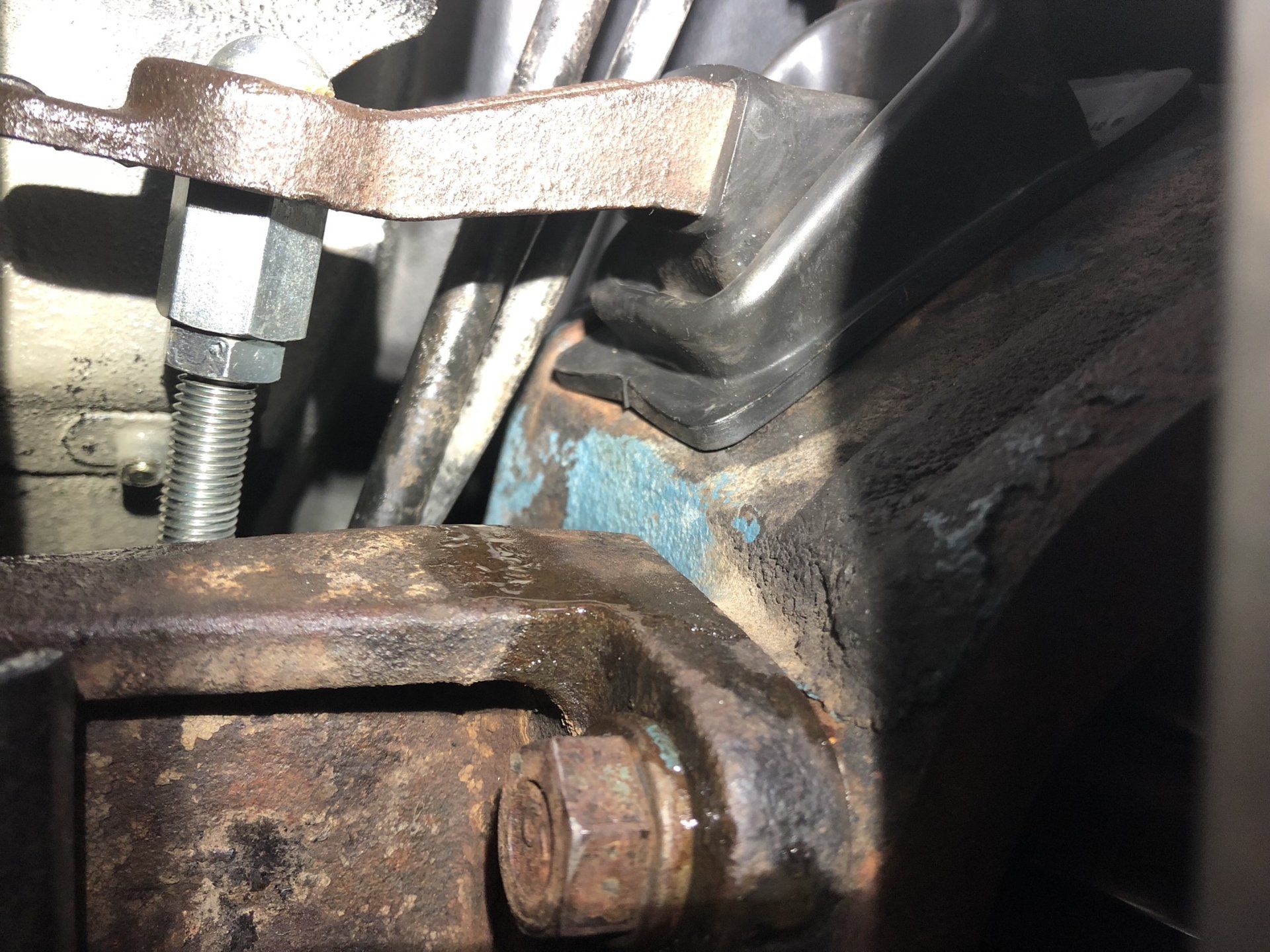

I’m having clutch slave acorn nut fitment issues. The clutch fork is either a 1974 or 1975, I’m not sure which. I have the two acorn nuts below (one closed, one open). They both appear to push and lock into the clutch fork. I don’t think they are supposed to. The slave piston will then pop out and/or the slave rod bends. I know 1974 was a cut over year for the clutch setup, so that adds to the issue.
Is there are third option out there I’m missing? I think I need a fatter acorn nut maybe?

Your slave and fork set-up looks like how I found both of my early '75s. With a little wear on the fork or nut, it looks like it will pop right thru. On the slave, the piston is dished and the slave push rod is half-spherical; so it probably won't bend much beyond the rubber boot. The later aftermarket option might be a better answer for the fork. I have to deal with the same thing after I get the motor on its mounts.
In my first and second photos the acorn is wedged in. I had to pry it out. Maybe the 80s version of the slave/rod/acorn is a suitable substitute?

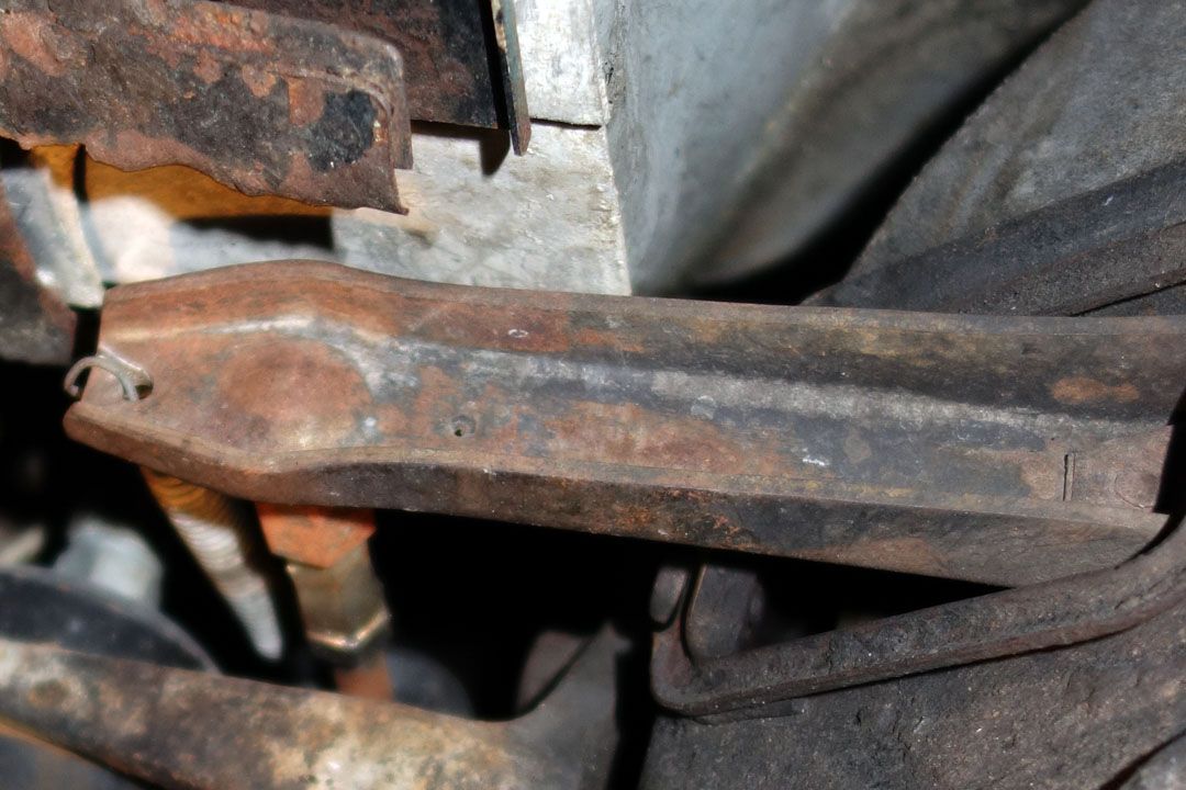

I don’t know if mine is original but the fork on my 74 is stamped steel and where the closed acorn nut rides is just dished out. There’s no hole so it needs to be the closed acorn nut. Mine has never fallen out. The hole I would guess would be to accommodate the open nut and would give a larger range of adjustment.
Your fork looks cast, is it? Mine is stamped steel. The hole in yours just looks too big is and probably wore out. But I’m guessing.
The hollow hex in your first post is what is supposed to work. If it binds, then the hole in your fork is not good.
And it will eventually snap the pushrod.

It definitely binds.

:D Good stuff! I learned a little about clutch fork differences AND, thanks to @hobbes photo, that there's supposed to be a boot over it ...o_O The more you know, the more you know you don't know.
Always great to learn you have issues you didn’t know about. For instance, I’ve now learned there are supposed to be clips on the end that I apparently never had. More good news....

Was just thinking of a repair to your fork. Even while in place. With some sort of bushing. First thing to come to mind would be the brass part out of a 1/2" dielectric union. Can't see it in the pic but the other end of the brass part has a flange on it. Seems like it would just drop right into your fork and be held in place by the nut. And you could use either open or closed nut. $5 at Home Depot. Just might be a quick easy fix even if its temporary.
