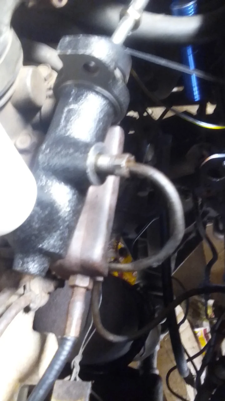

Earlier in the year I tried to put a kit in my master and slave. I ended up buying a new master that came with a braided stainless hose off ebay for $120. It had a long hose for a 45, one with the correct hose shorter length was $30 more. I just have the long hose in a loop. I screw the hose into the slave, then installed the unit - the fitting at the master could be tightened without turning the hose. Anyway has been working fine and its nice to have a new hose as the old one was original

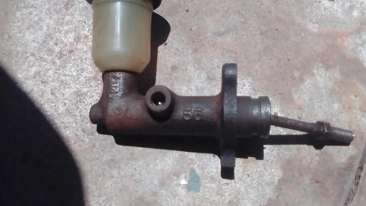

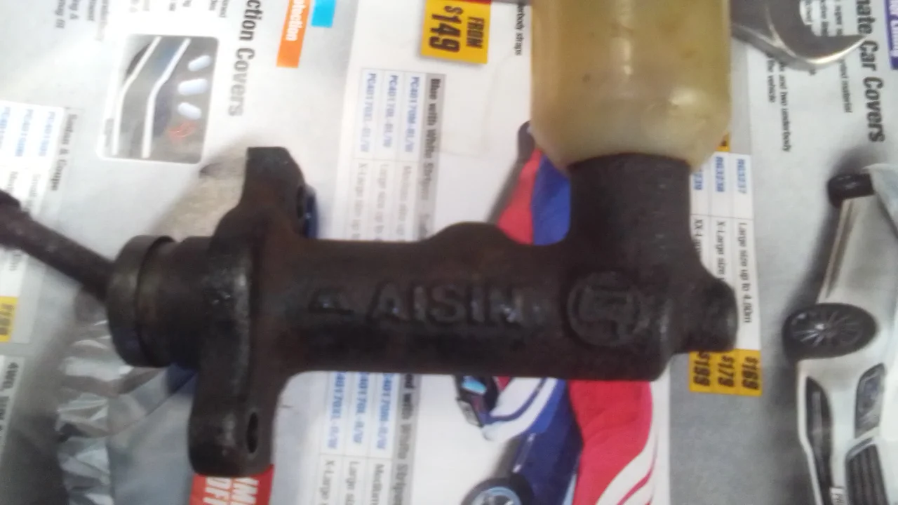

I Have Pics Now. Marking on MC are... 2H Under the bottle, 3/4 and 56

side port from parts specs
3/4inch 10Mx1
3/4inch 14Mx1.5Ball

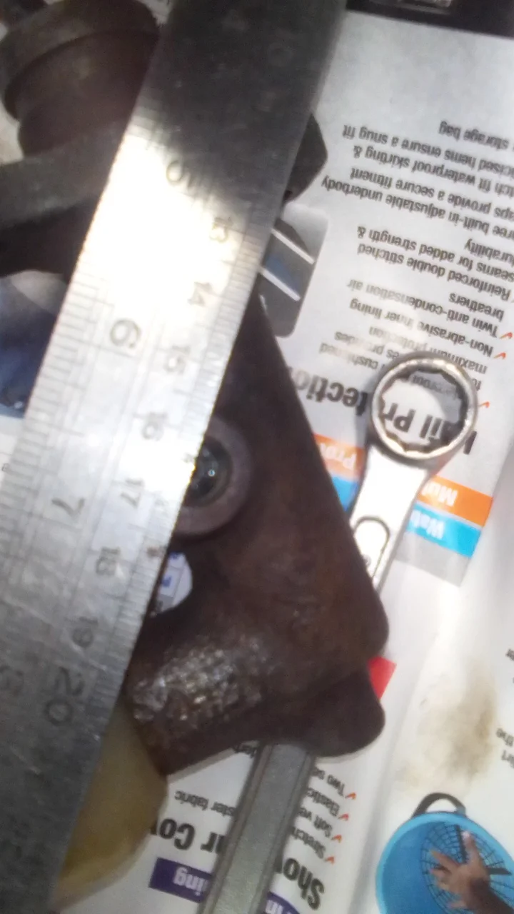

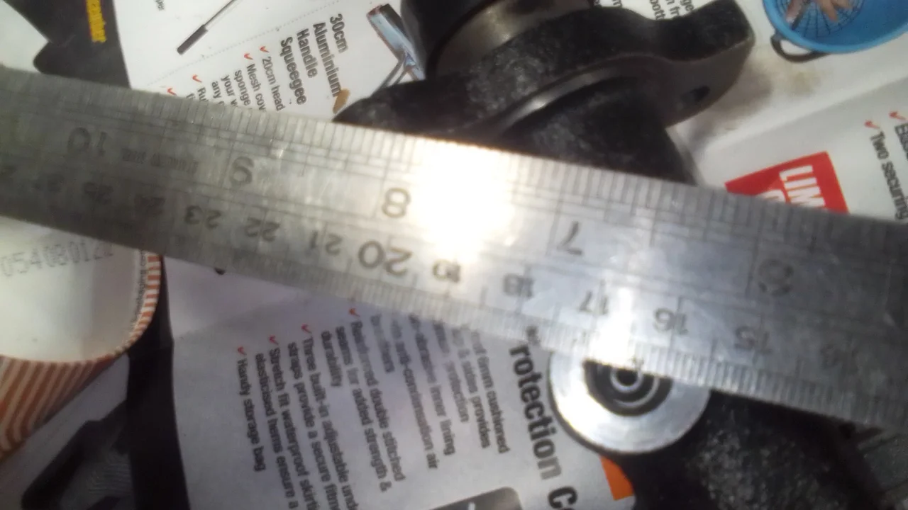

If a hydralic fitting of a "14Mx1.5Ball" is 4mm wider than a 10Mx1, why isn't the pics of orig parts side bore 4 mm wider than the pics of 10Mx1 replacement part (ZPM 06115) i got incorrect...
There's no room for an adapter piece. This CMC is in a build but factory mounted off chassis just where the collum shift linkages go thru with about 3mm of play... Am really trying to avoid workshop or buying an additional line if the correct part is out there.
As per the pics above the bore size seem the same but they arn't.
Based on the spec i read and my (mis?)understanding i am thinking the JB1528 bore will suit the clutch-line seat and thread based on the "14Mx1.5Ball" im reading. All others seem to have the "10Mx1" even tho the bore looks same? gmf'd
