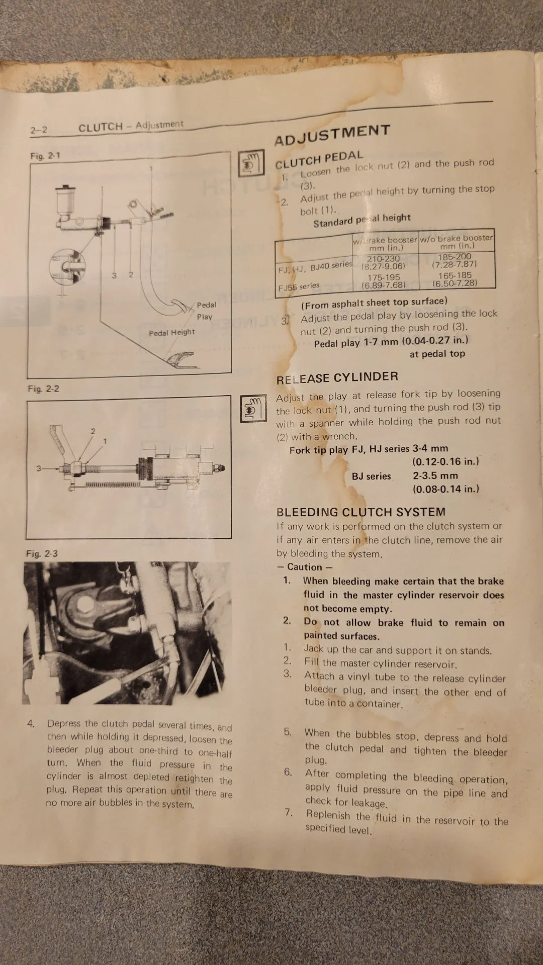

UPDATE: I was reading on this more and decided to see if the pedal was the correct height. It was not and I adjusted the nut so it was at the proper height. At that point I was able to get it into reverse and get it out of the garage, however, I am still unable to get it into 1st. (2, 3, 4 and R all work fine.)
Help!
Once the pedal adjustments are done, then the rod adjustments between the slave and the fork will determine where the height the clutch engages and releases.
Figure 2-1 is in the passenger compartment. Figures 2-2 and 2-3 are in the engine compartment. Follow the FSM verbatim and you should be successful.
