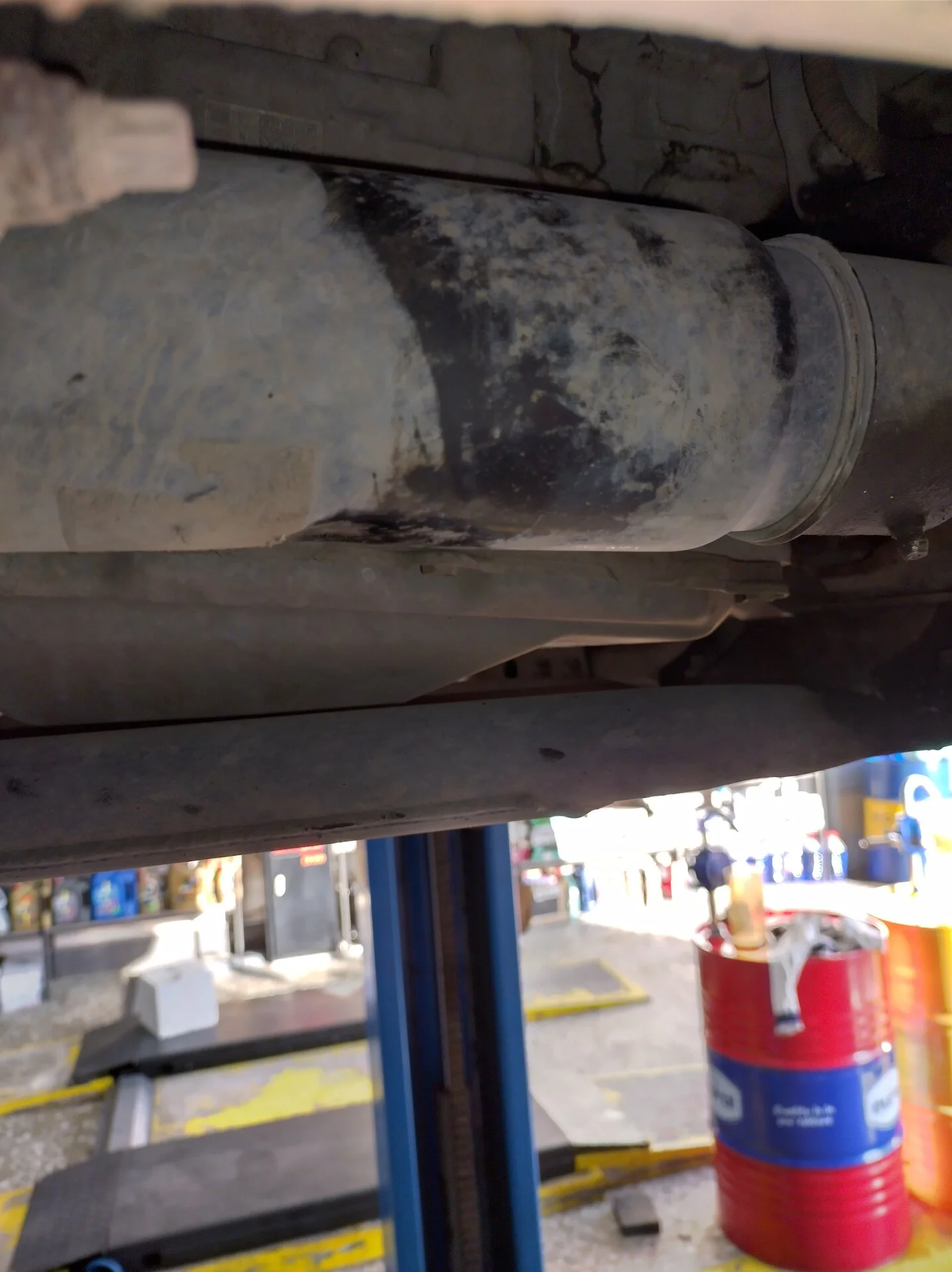

6: found minor bent on front driveshaft tube.

The driveshaft is a pretty robust tube. If that dent is not normal, it took quite a hit (or the driveshaft was used to to lift the vehicle).
