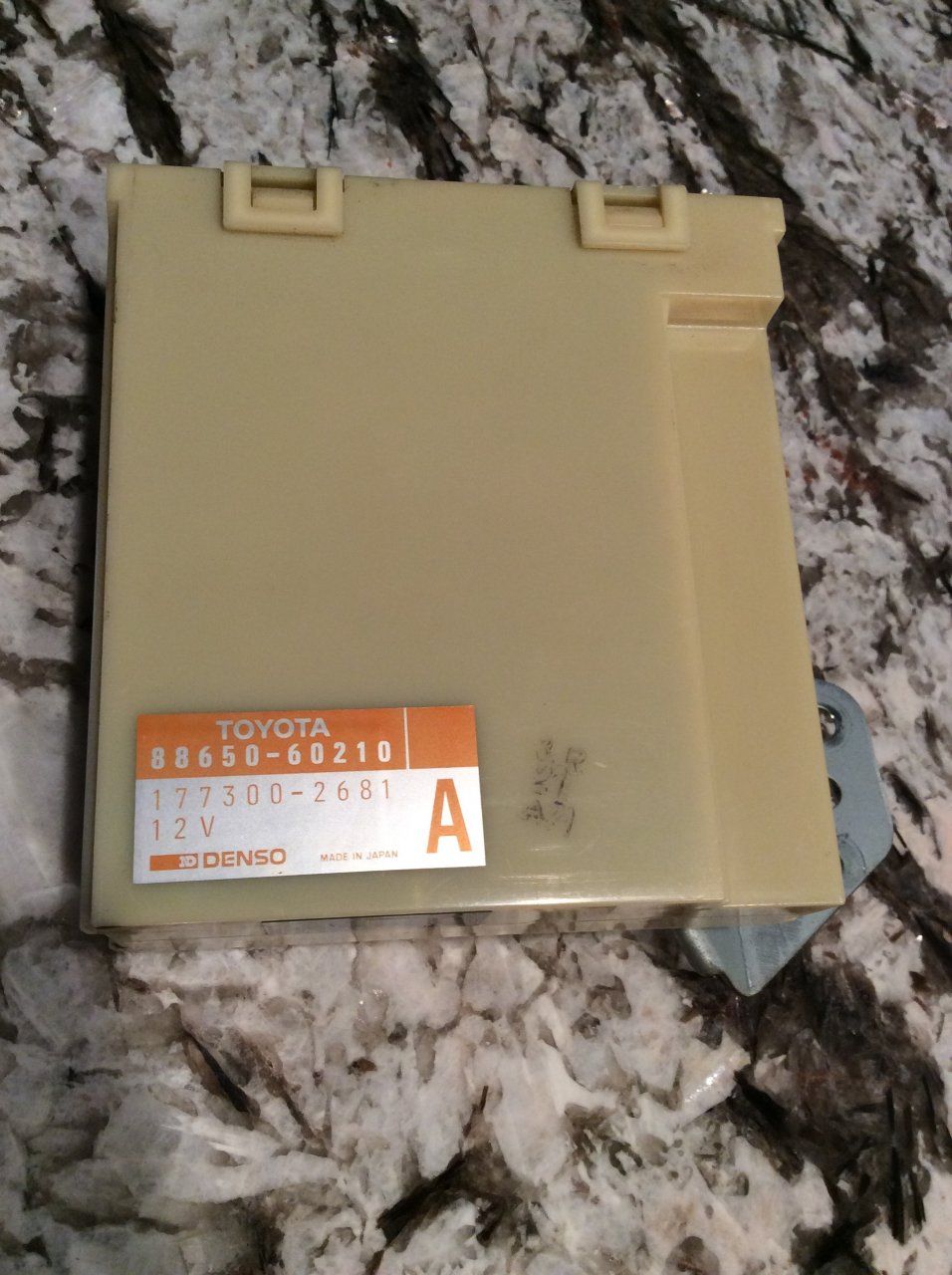

Ok dug it out but the number is 2 versions prior. PN: 88650-60210
I'm on my phone so it may not upload the picture.
So finally got around to pulling out the control box under the right side of the dash. First off...yes that thing is a B!tch to get out. I left the dash panel on...guess my long fingers finally came in handy.
Anyway got it out, opened it up and....
Nada. Looks fine. :( Going to drill a couple holes in the bottom corner of the case to hopefully prevent it from going bad.
Attached a few photos. So back to the drawing board. Off to do some more searching/reading...if you have any insight shoot it my way, would appreciate any and all help!
Will report back with what I find:cheers:

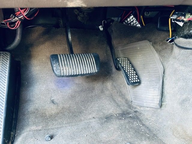

I however cannot find it in the fsm but think i have located on the truck, is this it?
Sorry for pic quality its a hard angle.

Where is this box? I checked under the steering column above and under the pedals but didn’t see it. I’m having problem with the blower fan. There no AC on Lo setting, Mi and Hi work. Just replaced the blower resistor since it’s out of specs. TiA
