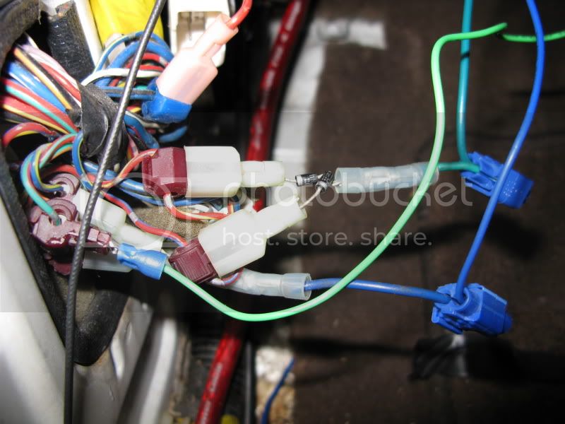

This is what my 95 looks like. Don't mind how ratty everything looks, been meaning to clean it up but have not gotten around to it.
Thanks for making the effort with the pics, it seems as if you have two blues and one green, is that correct or just the way my screen 'sees' them?
I understand how the diodes work but have not found out WHY the interior light/door ajar warning is back feeding to the door lock controller and even more perplexed by the fact that it is only the drivers door causing the problem.
Can you actually see the colours that your Clifford is connected too as other wires are blocking the view of the connection? Whatever you can do will help but please do not disturb the wires and end up with something not working.

In the picture mine has teal, blue, green, and red.
Green goes to green and red
teal goes to red-blue red-yellow
red goes to blue-black
and i can't tell what the blue goes to in the image.
