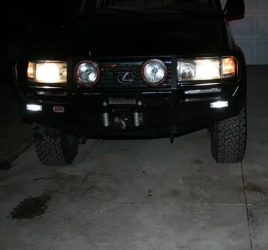

48 LED corner lights, and 63 LED 1156 bulbs in the ARB lights, with clear lenses, super fast shipping to NC, thanks.

of course from our friends at eBay. At the time, it was the best deal (price and shipping) for the bulbs. If I were purchasing today, I would recheck the listings for a better price but it is still going to be close.
Be very careful on the 63 stack bulbs. To get the compression needed to get it in the slot, you have to carefully distribute the pressure, and slowly turn it into place. While I did not learn the hard way and they may be far more robust but I really thought I could have twisted them apart just trying to get them into the slots. The 48LED's are put together in a way they are fine, while they are fine for the corner markers, I doubt they will fit into the ARB slots, I did not try it but they seem too wide for the compartment.
While the photo looks like I have the headlights on (which is not the case) the photo only includes the corner marker lights and the ARB bumper lights, LOTS of LIGHT!

Nice, would you post a picture with the main headlights on for a light comparison?
Lights comparisions. . .
Sure, here they are:
Top: Low Beam and LEDs
Middle: High Beam and LEDs
Bottom: No Beams! and LEDs
One caveat, :censor:cell phone camera but that's what's available at the moment.
(Also, note the trailer in the foreground, that may also give you an idea of the illumination.)
And without the Hella's!

I was looking at those LEDs but wasn't sure how bright they would be so I went with the LEDs I posted earlier. It ended up being much more work than your solution. I do wish I could see your lights in person, would you say you have appreciable more light down and to the sides?
If you havn't done so already I would go back and add lots of clear silicone to seal up the lights. If your housings were like mine they weren't well sealed from the elements and I doubt those LEDs like much moisture.
So I am guessing you wired the ARB lights into your parking lights?
I went with Slee's aux jumper harness with a switch for power - also much more work and more expensive than your solution.
We should do a separate write up from Nakmans sales thread for the lighting section of FAQ. I'm not a big fan of the redundant turn signals in the ARB so the extra lights for driving are a big plus with me. I especially like a little more light off to the sides. I bet other people feel likewise.
I don't know enough about how to move a thread but that would be fine with me. Good idea on the silicone. And to wiring, I did not want another flashing light so you are right and I don't like to splice into a wiring harness lead, so, I wired them into the parking lights. I have replaced my marker lights on each front fender with sealed/closed housing LED's and had already made a tie into the factory harness with several pig tails I created. I just added a second lead on each of the pig tails to tie into the ARB lights.
As to lights down and to the side, you know, just based on the recessed nature of how the lamp housing is mounted in the ARB bumper, other than some ambient light flooded into the area, I can't say it (light) is there in a significant way. Nevertheless, just turning on my parking lights gives me enough light to drive through town of a night. At 60-75 on the highway, no way, but around town, sure. And, if I am working in front of the bumper and need some light, there is ample white clean light without killing the batteries using the headlights.

It sounds like my 3W LEDs put out more light since when I turn them on there is a noticeable difference in side lighting, but at 4 modules total it isn't cheap. Also, the second LED module was a bear to put in - only good thing is the modules are waterproof so I don't need to worry about that aspect. I'll have to add pictures later.

they look bright no doubt.
I'd like to see the same 3 pics, but looking outward to see how much light is projected onto the roadway..
