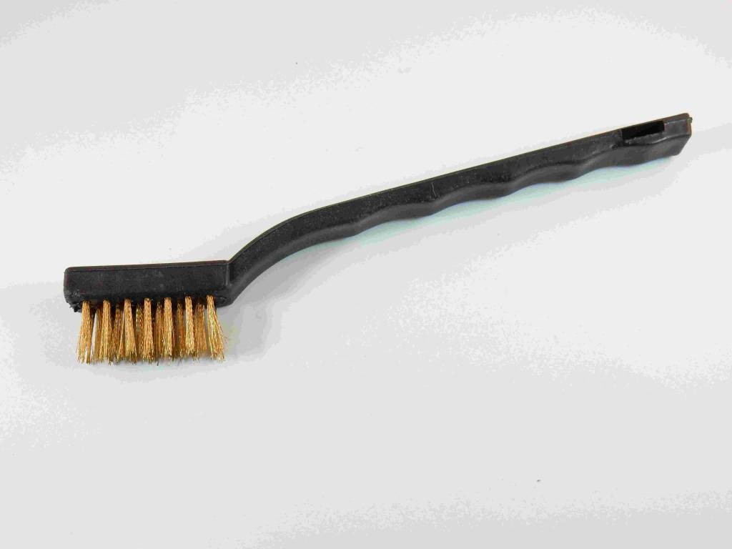

On the subject of cleaning terminals, blast out the grime with something like the aforementioned CRC cleaner. Then spray it with Deoxit to remove corrosion:
I've had neglected, 30 year old motorcycle terminals that were clean and glossy after simply spraying with Deoxit, then plugging and unplugging them a few times.
If that doesn't sufficiently clean them, use a soft brass bristle brush:
To prevent corrosion in the future, pack all connectors with silicone dielectric grease. I buy cans of this stuff when it's on sale:

then when i confronted the clock spring i just kind of moved into replacing the clock spring which definitely was an adventure in itself. documented here in all its glory.
anyway if you have this problem i finally replaced the relay by ordering a NAPA relay. i'll post a part number but it is $20 compared to over $80 for the toyota one.
a couple other notes are rhat my relay seems to have failed in a weird way that may be related to the coil in it. basically from what i can tell if you remove the relay for a period of time or disconnect the battery the horn will work for some period of time only to start to "not kind of work". what is additionally confusing is the 96/97 steering wheel (at least) has four sets of contacts. so when it is "not kind of working" it is not working in a way that appears to depend on which way you push the airbag - making it seem in a way like the problem is in the wheel.
i took apart the relay after getting a new one in to have a look and it looks about as clean as you could hope to see.
