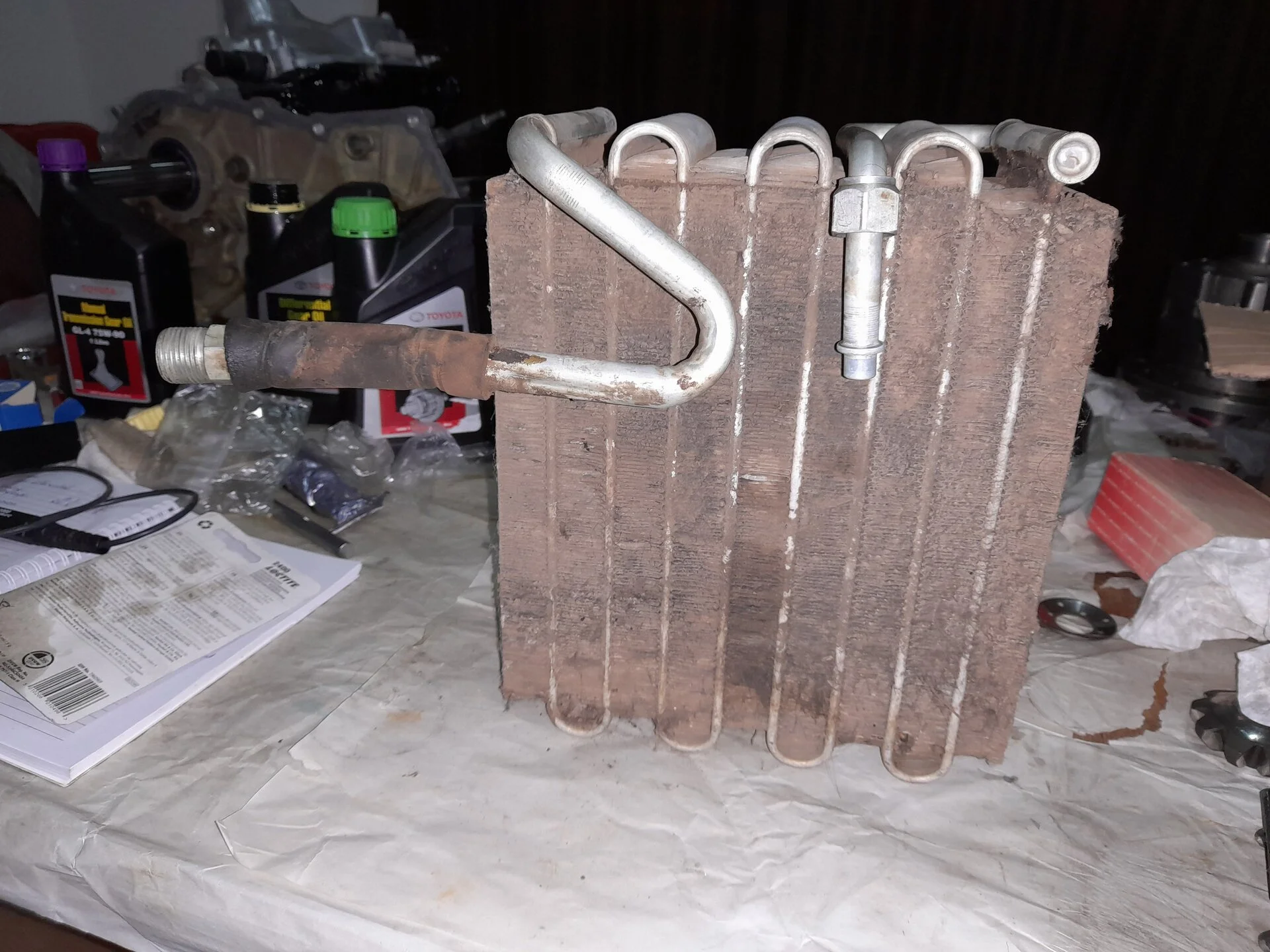

My evaporator coil, while not damaged or corroded, is caked in 30+ years worth of dirt and fluff.
I have a junk coil which is similarly dirty and experimented cleaning it with a power washer from a safe distance where it would not damage the fins, but this only got rid of the loose stuff.
Can anyone recommend a product that will shift this stuck-down dirt? I was thinking maybe brake fluid which I have used successfully to get sticky stuff off plastic.

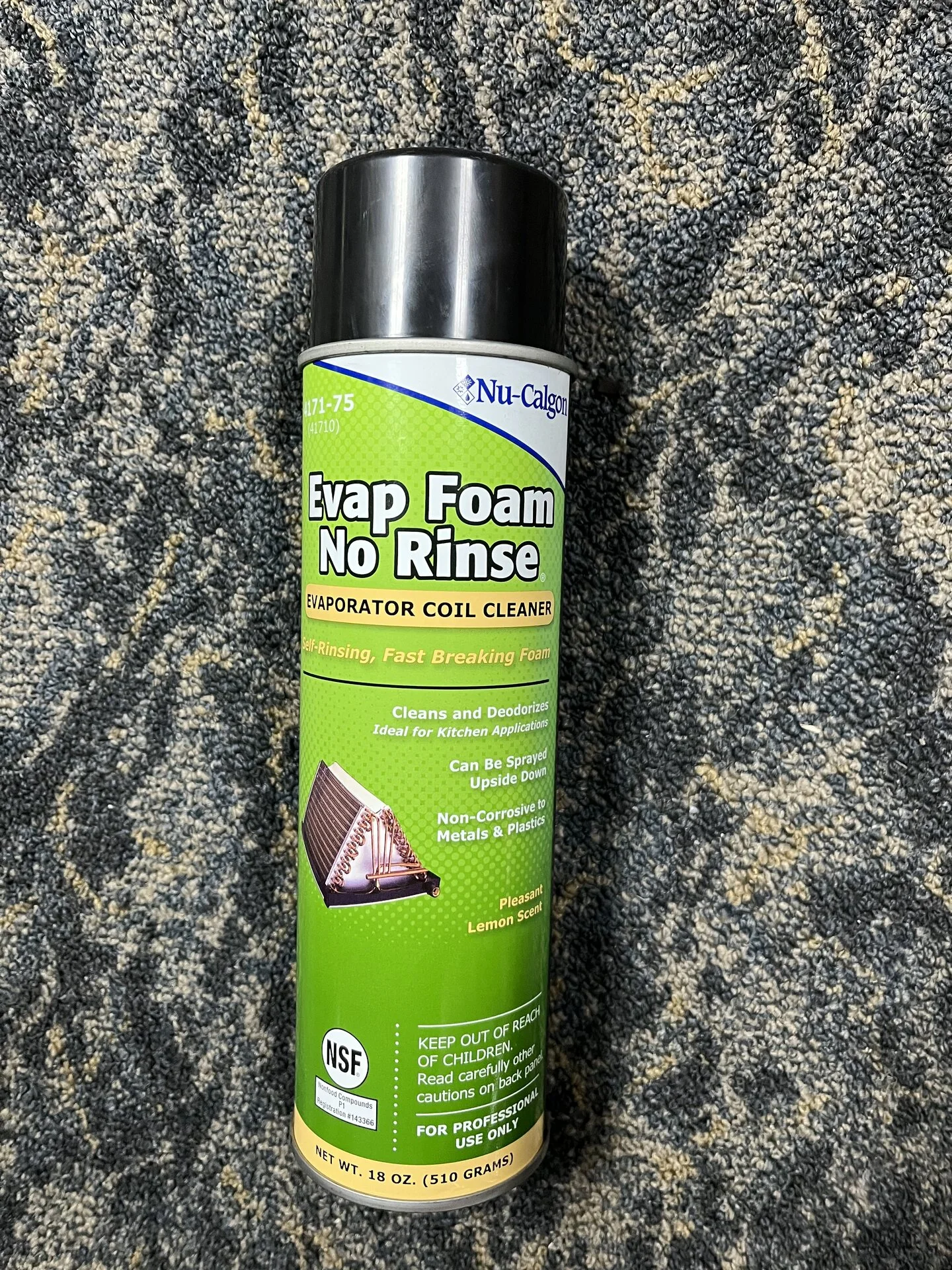

This is what I've used on mine.
It worked pretty well getting rid of the dirt in the condenser and evaporator.
Thanks. If I don't get satisfactory results with dishwashing liquid/brake fuid and power washing, I may see if anything like that can be found locally, but I somehow doubt it. Any idea what's in it?

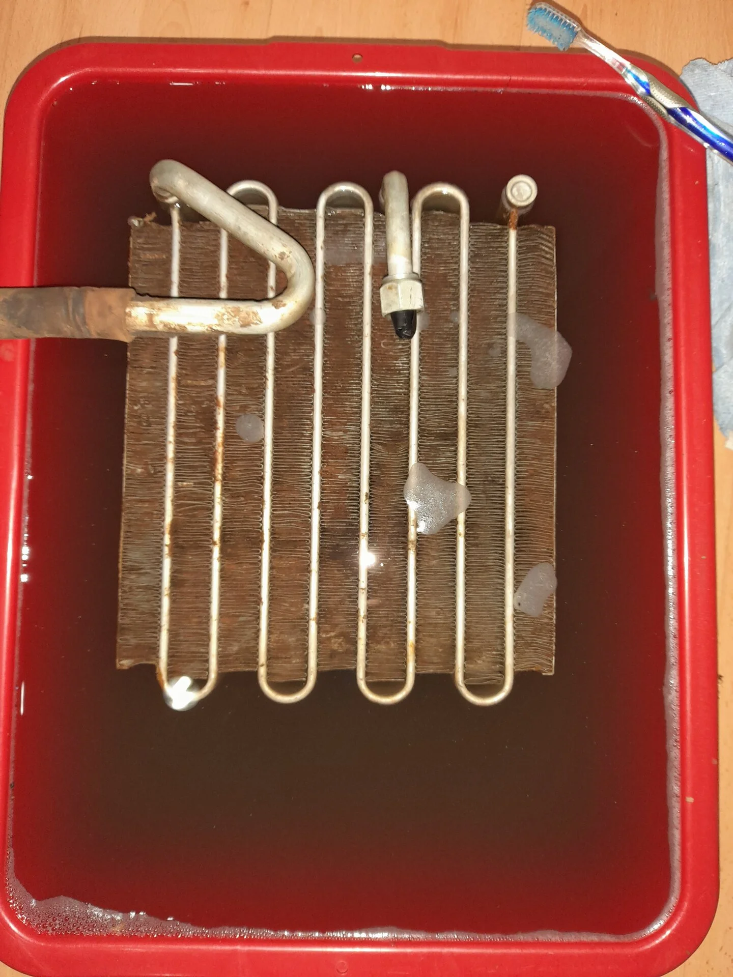

Currently the coil has been soaking in soapy water overnight (Thanks Spike Strip), I have been gently scrubbing the fins with a toothbrush to release 30+ years of dust and dog hair. This came from Australia and the dust is deep red.
As it came from the wreckers:
Following soaking and a bit of scrubbing (more needed):
Notice how the bottom of this 12 cm deep tray is obscured by the dirt in the water!
