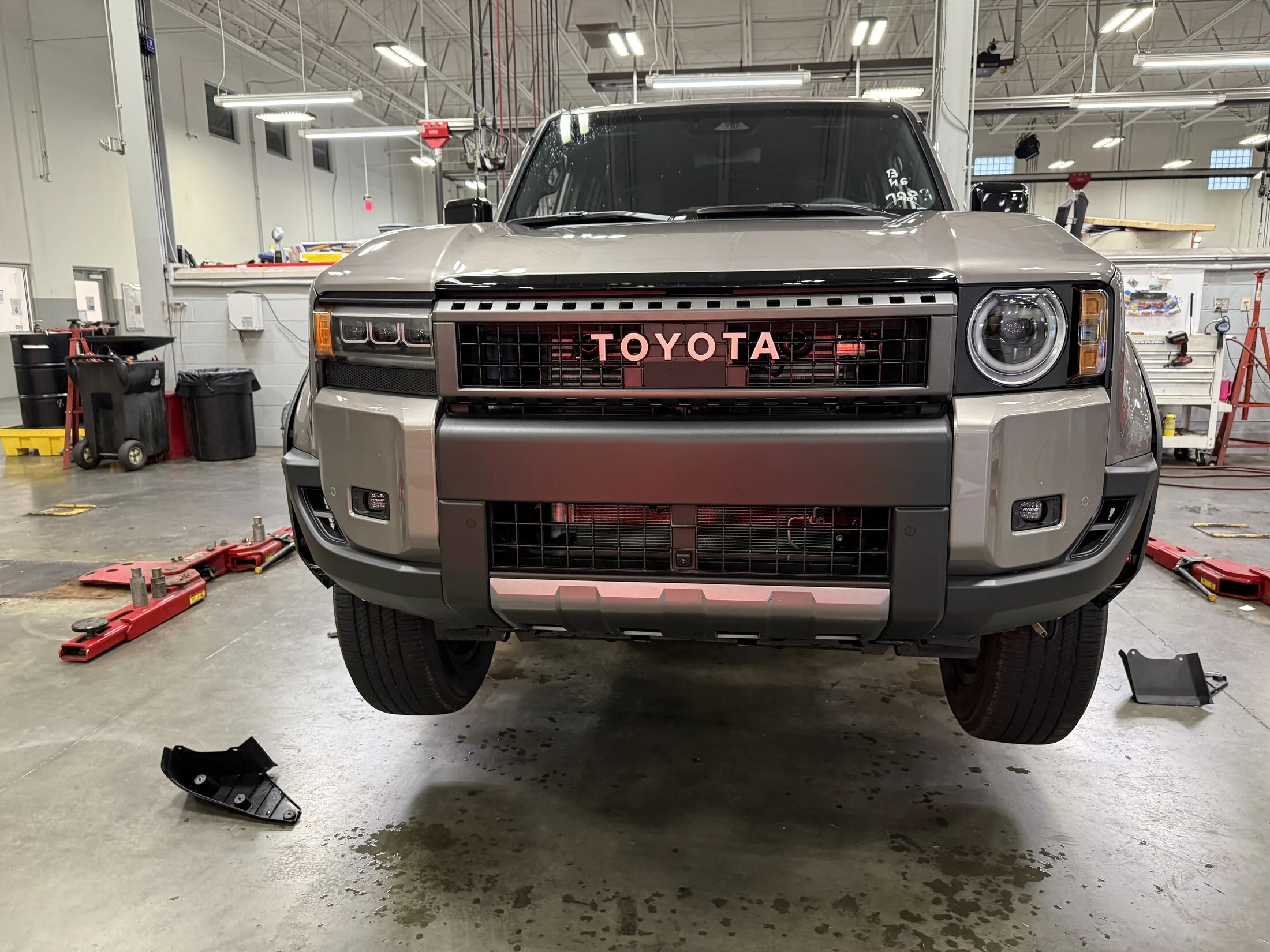

I recently completed a rectangle-to-circle headlight/headlamp swap for a Land Cruiser trim LC250.
Not super technical but not at all "plug and play" either.
You need a total of ten parts to make this possible. Although others have likey swapped these headlights before me, I belive this is the first successful full-blown install from scratch. I say that because many of the parts involved did not have part numbers from Toyota yet. We had to request the part numbers to be made which is not uncommon when a brand-new model comes out. I have a kit put together with all 10-parts if anyone wants to do this on their own. I will post a video on this in the next few days once edited.
I will make another kit for rectangle replacment for 1958/First Edition owners in the next week or so.
LC250-CHK - Circle Headlight Kit | Ed Martin Toyota Parts
  1. Qty 1 - 81056-60N90 – LH computer sub assembly
  2. Qty 1 - 81016-60N90 – RH computer sub assembly
  3. Qty 1 – 81185-60N90 - LH Lamp Assembly
  4. Qty 1 – 81145-60N90 - RH Lamp Assembly
  5. Qty 4 – 81536-46120 – LED yellow (top and bottom)
  6. Qty 2 – 8112C-60N90 – LED white (middle)
If anyone has any questions, let me know. I will post the video and installation instructions that will show how to install remove the front bumper. NOTE: after install, the MID will show a headlamp malfunction fault, this can easily be remedied in GTS+ (formerly Tech Stream) with a head lamp initialization sequence.

This should work fine with 2024 - 2026 model years.
We sell the kit online and you can have you local dealer install it. We charge $1400 for labor, it's an all-day job, bumper and grille get removed and needs recalibrated in GTS+. Should be under $4500 all-in with tax amnd labor.
