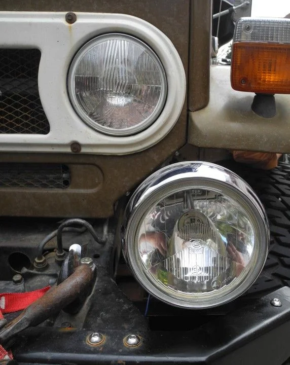

Cibie is pronounced like the letters, C-B-A. It's French. I've had the headlights for awhile, e-code 7" for LHD. You can get them with city lights in them, but these don't have them.
The driving lights I got used from Cruiser Corps a while back. They were very popular on rally cars in the 80s, but you don't see them much anymore.

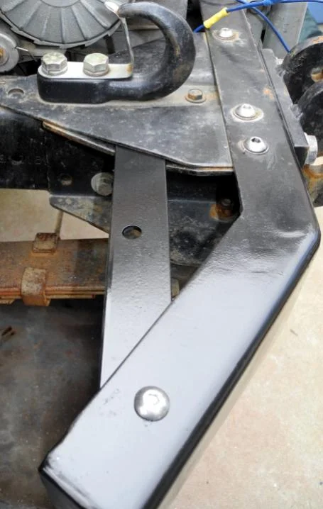

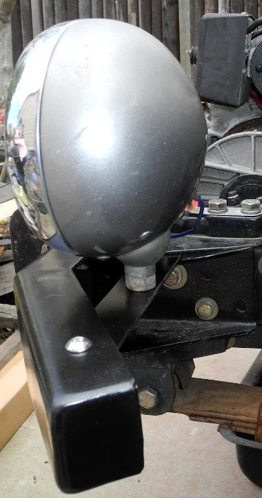

I've been trying to figure out an elegant way to mount them where I wanted them. These are 1 bolt brackets. The inboard end is jammed into the crack between the outboard bumper brackets and the top triangle braces. It's very solid in there. The brackets are angle iron. I made the first one out of flat stock and it was not solid enough to make my OCD happy. I used a couple big nuts to space them up 1/2" at the last minute.

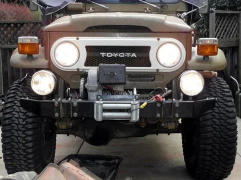

I'm going to run them with stock bulbs, for the cool retro factor.
