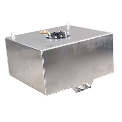

We formed a plan to get rid of most of the rear overhang and that meant getting a new fuel tank. This is what I bought. 60L Alu fuel tank.

Finished up the installation of the fuel cell. Had to make an adaptor and som stuff. Also installed new indicators with LED inserts. Then a poser shot in the fields.
