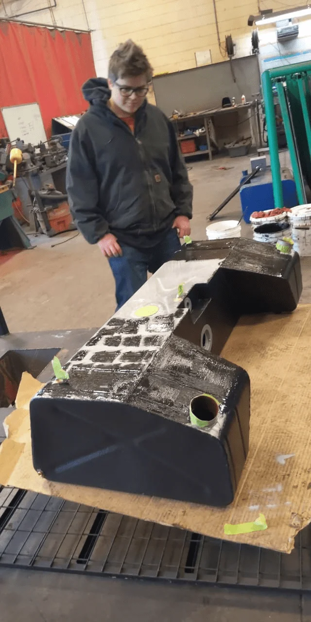

They also refurbish fuel tanks full on--the way they do it is cut the tank in half, sand blast inside and out, weld back together, coat inside and out.
They also fabricate/duplicate fuel tanks.

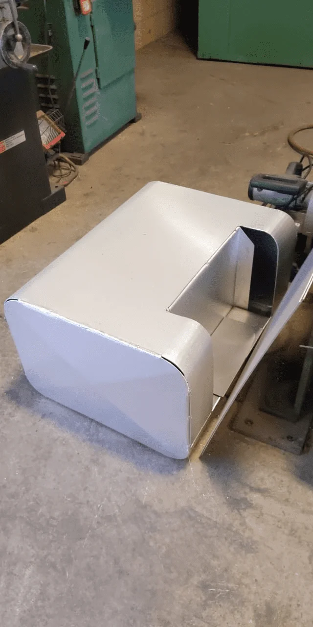

Here's their bubble tank.

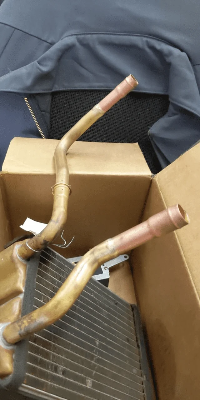

This is the work they did on my heater core for the 80. The ends were bunged up during removal from the donor vehicle and I asked them while they were at it to extend the ends 1.5 inches so there is more protruding past the firewall. They also did a couple of pressure tests and found it did not need a re-core. The price was right.
