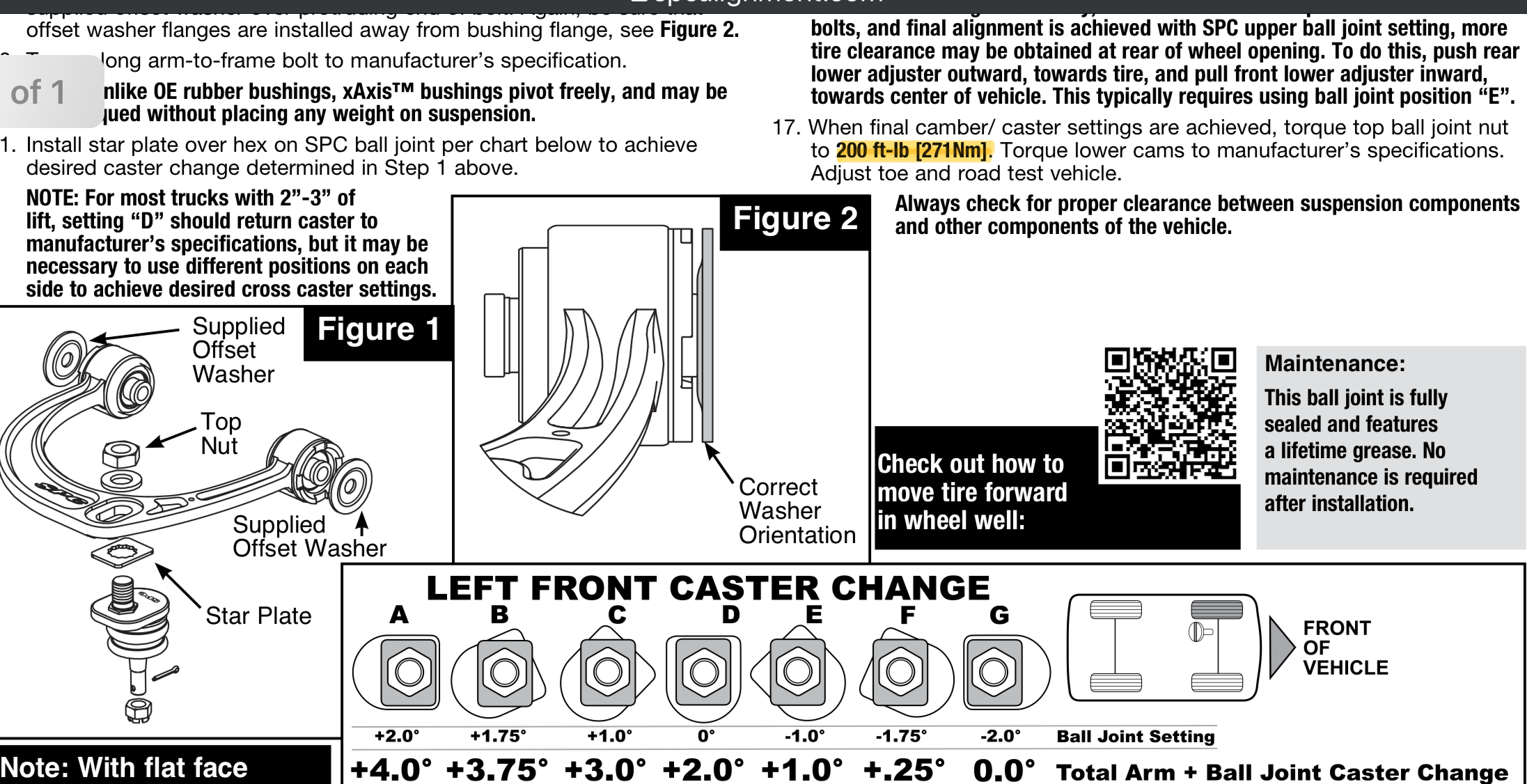

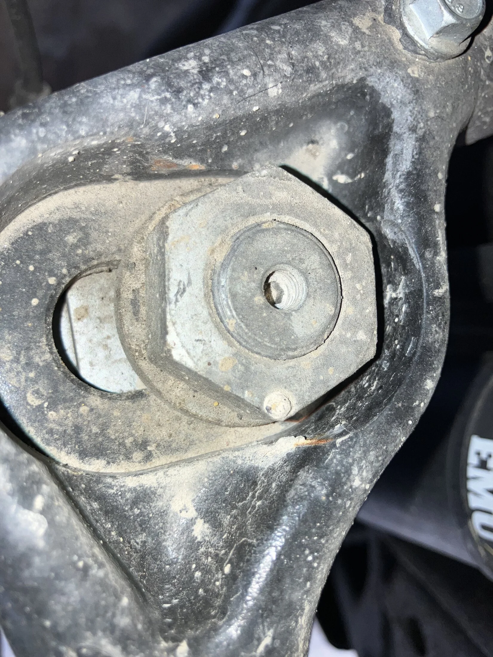

I got my SPC UCAs in Feb 2024 from Slee. They have the sealed upper ball joint. I found instructions from SPC for 2023 and 2024 sealed ball joint versions. The 2023 calls for 150 for lbs on adjusting nut and the 2024 calls for 200 ft lbs. Can anyone on here tell me if I have the 2023 or 2024 variant, or should I just set to 200 ft lbs? Picture attached of my UCA…
Go 200. I've had both versions of the ball joint, and the only one that slipped was at 150lbs (earlier version) I haven't had an issue with the new version at 200lbs.
I suspect the newer instructions say 200 because everyone was having trouble with them at 150 previously.
