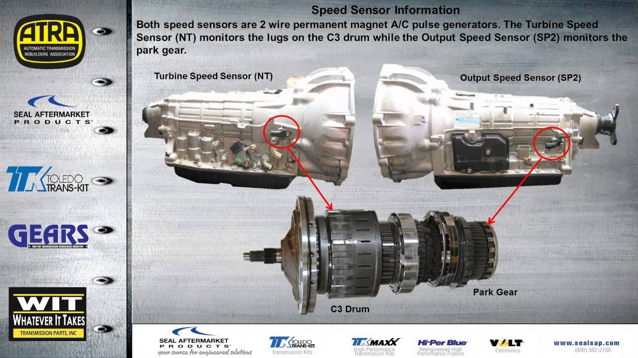

I'd be inspecting wiring to all harness connections on the transmission. Note that on ours there are a couple speed sensors stabbed into the side of it that read some of the planetary sets internally.. you'll see a 2 or 3 wire harness plugged into a black connector by itself along the side of the trans.
Thanks for this diagram and info, will check those connectors to see if anything is loose or broken.
Do you know where sp1 is? In the details of the error code, it was mentioning sp01. Is it behind speedometer?
The above transmission doesn’t have a transfer case on it.. I’d check the back of that to see whether an additional sensor was added to the output shaft.
Also were the details you mention from techstream or TIS? If not there could be generic terminology and VSS A could very well be SP2 in the above image.
the weather warmed up to 75F today and after couple of drives running errands, when I started my truck again, all the error codes were gone and no lights or flashing on my dashboard. :banana:
