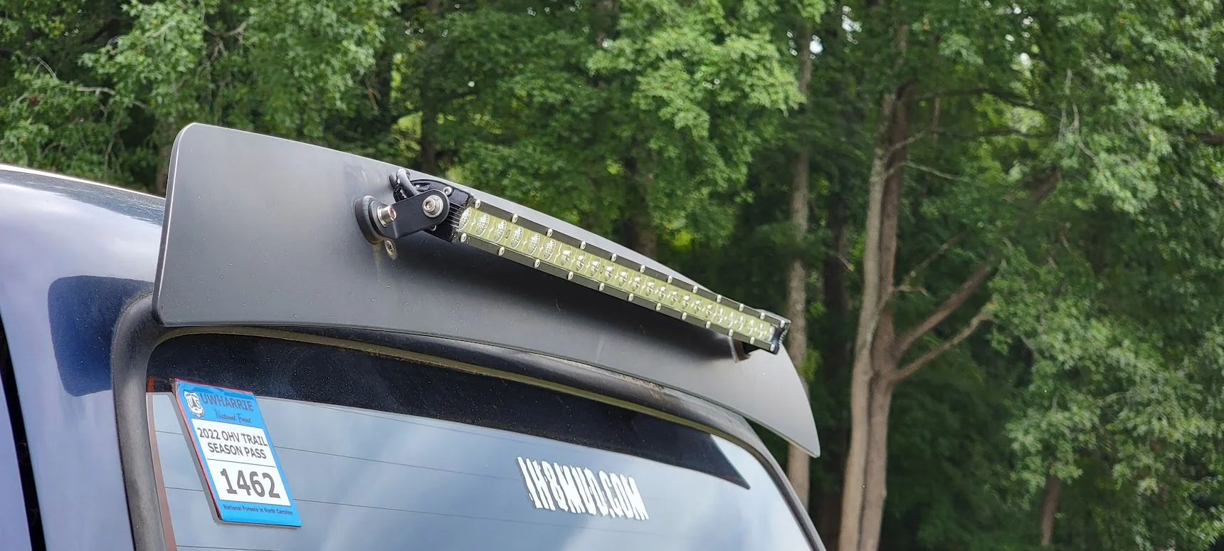

I mounted a rear lightbar to my rear wind deflector. Works great.

NICE!
You could definitely blind someone who's tailgating you, hahaha!
Too often we were getting into camp late at night and couldn't see anything to setup our ground tent.
