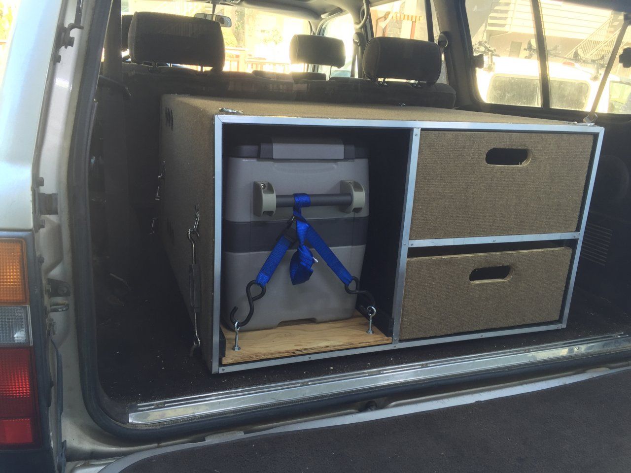

The third row seats are often used to haul kids or the cargo area is used to haul bulky items and the Cruiser is only used in "expedition mode" several times a year so the "system" will be easily installed or removed. The drawers do not need to be a sleeping platform. The drawers will be crates that can be unloaded at camp or easily unloaded at home for storage. Using leftover plywood that was cluttering the garage, the cost will be about a hundred bucks. Add $30 bucks to that if you need to buy an additional sheet.
fridge slide
that was a couple hours of screwing and gluing. Next day off I will install the shelf and slap on some carpet remnant and tie downs. Build some apple boxes and it will be done.
A bit of black paint on the interior and some aluminum trim to pretty up the edges, tie downs on top and tie downs on the sides to secure it. Done! (Except for building some "Apple boxes" for the shelves.

This is very low dollar and very removable. This week I haul 7 kids on a school trip, next week is a kayak camping trip where I need no third row seats but lots of cargo space then followed by the Rubicon trail where I will use the box.
I made two mistakes, I applied a bit of wax to the crates and they now slide in and out so easily that I need some sort of latch. The other mistake is that I should have built two large crates instead of 1 large and two small ones. the large one is easy enough to handle and slides way easier than I thought it would.

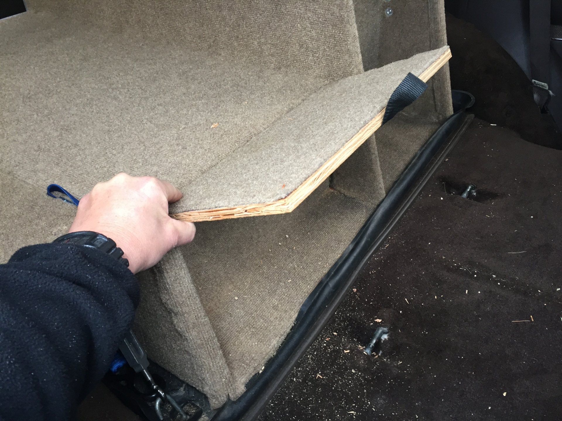

Suddenly I have the opportunity to take a couple trips without wife and kids and now I think it would be nice to sleep in the back of the cruiser. The box is a bit tall to sleep on so chopped the top kitchen box drawer off. The box can still be strapped down where it used to slide in(or it can be strapped on top off the fridge. The single shelf will still contain/organize my tools and spare parts. Under the wing is where I will continue to store straps/winching gear. The single drawer is pretty much level with the folded over middle row of seats. I did make a small little hinged piece that fills in the gap between the box and seat back. 6+ feet of room to stretch out.
