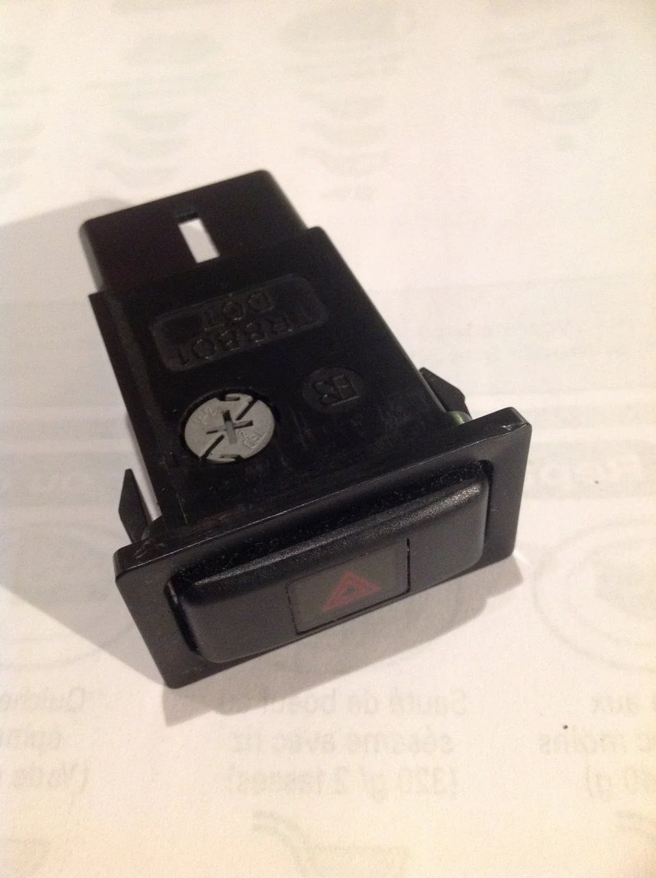

the hazard switch I use for my cdl switch is same size as my 95 stock hazard switch. A buddy sent me the switch and presume its off an earlier year LC than mine since that's what he drives.
Hey all Cruiserheads! MYTTOY here to add some info to this older thread. I found that a 1995 4Runner emergency flasher button works on my 1994 FJ80 with no trimming or modification. Just thought I would throw that out there in case anyone is wondering around the pull-a-part places and see's one. perfect plug and play operation.

I went the same route with an old tercel hazard switch. It took about 15 minutes. Super easy mod. Most difficult part was trimming tab so that the harness could plug into the switch.
Found a red hazard switch on Ebay out of a 91 LC. Dk if I'm gonna print a label or leave it as-is, but I really like the red body on the switch.
Super easy mod. Thx!
Mike
Trying to breathe a little life into this thread. I just bought my Tercel hazard switch from a pick'n pull and installed it. FYI a '95 Tercel has a completely different hazard switch, unless the one in the yard was mislabeled as a '95 and was, in fact, a newer model. I found two: one from a '94 Tercel and one from an '88. Both work perfect, thanks all for the write ups, especially the DIY relabeling and the YouTube video. Pulled the wire from the 7 pin, taped and wrapped, good to go now.
