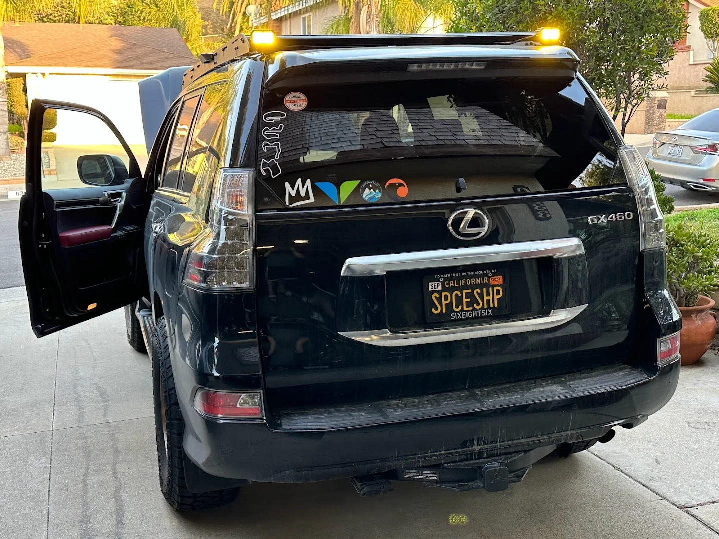

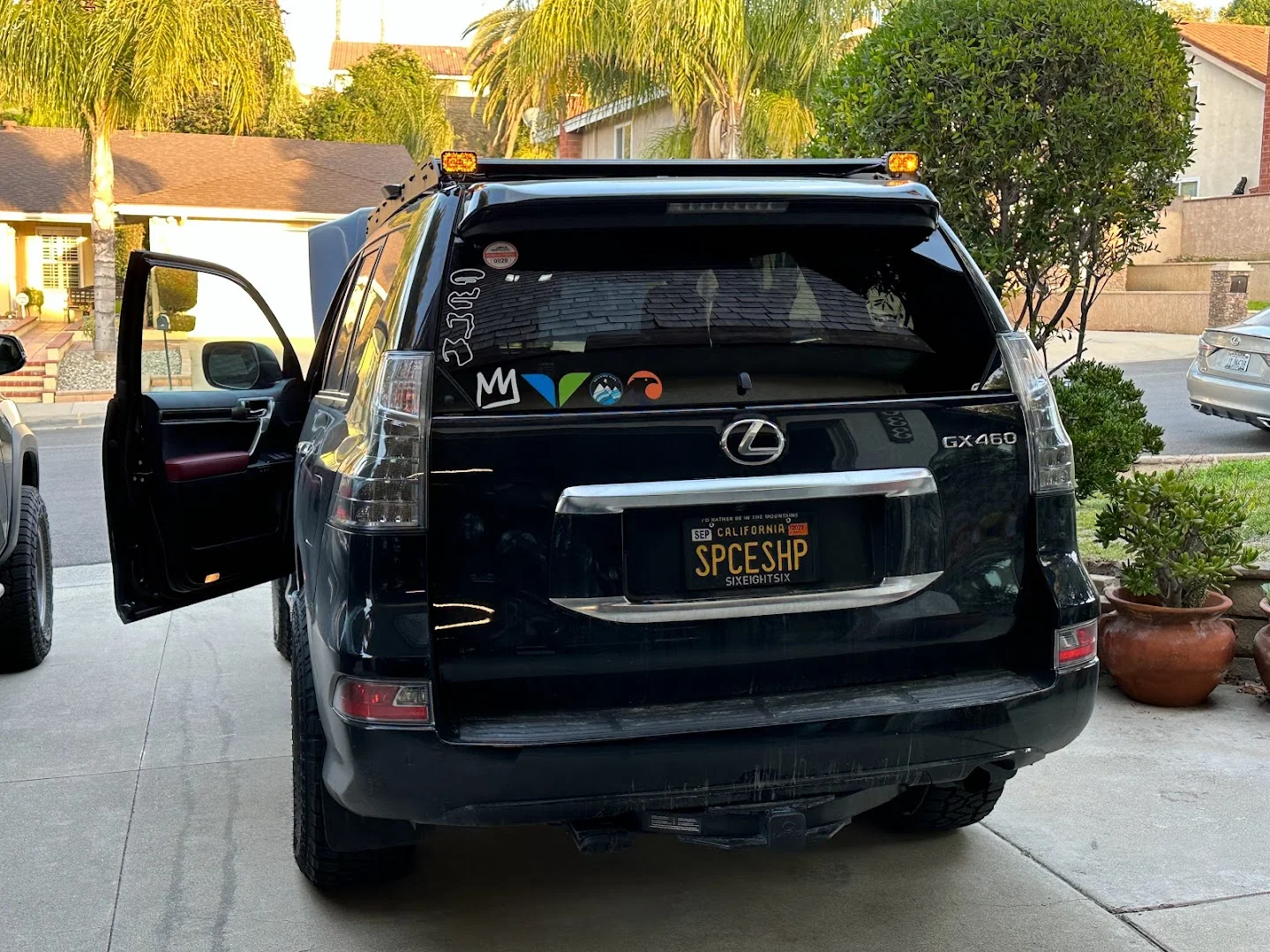

I installed a pair of Baja Designs S1's on my roof rack. They work well as chase lights, and reverse lights. We were trail running over the weekend and it was a little dusty . The guy following me said it looked like a set of yellow headlights were facing him, and it was the only part of the truck he could see. The second picture was the guy I was following for reference.
Yup, that's a familiar sight. I'm not currently running a roof rack so will have to engineer another solution.

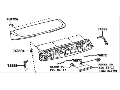

Roof rack here too. I'd considered mounting them under the spoiler, with some sort of brace underneath in the plastic. There is, however, a lot going on in that black plastic piece under, as it holds the wiper assembly and squirter.

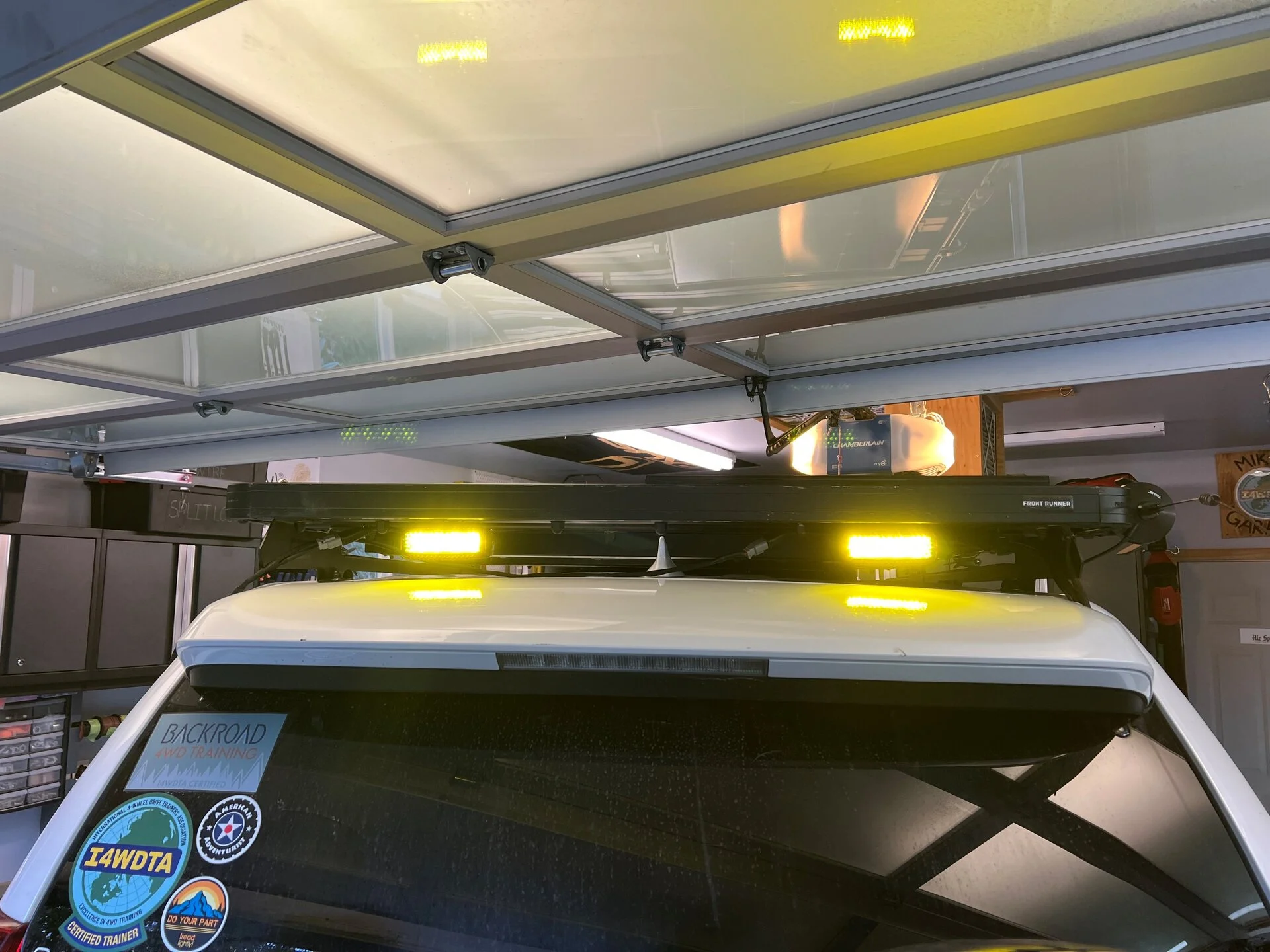

Oh, these are the Diode Dynamics SSC2 Sport - chosen because they have an amber backlight and are lower power/intensity than the other ones they sell.
