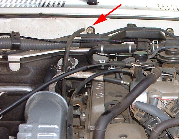

Yes, there is a ground that attaches to the front shock tower. It is part of a bundle of ground wires that I believe connects to the relay box right there.
Here is a picture of the ground on the back of the engine. (Credit: George)
In my experience, bad grounds are a major cause of charging issues.
If your battery lost a cell, it would be closer to 10.5V. 2.1V/Cell for a fully charged lead acid battery. 2.1V * 6 Cells = 12.6V total. I bet your battery is good.
Very interesting, I just took a look at a picture i had of my engine bay and there is no ground wire connected there. I would have to do some looking around to see if it got tucked away whenever they put in the engine. I wonder how the truck would be able to even start then. I will send a update when I get a chance to go to my vehicle. Where does this ground wire originate from so I can trace it?
This post shows both attached ends with this picture.

I went out there today and I am in fact missing the ground wire there.

Nothing changed when I ran the jumper cables as ground. This still doesn't look normal to me. Is this a accurate way to test? Anything else I can do to test the grounds? Should I go ahead and order some wire to install that missing ground?
Thank you to all. I will additionally take a look at the one by the oil filter the gentlemen above was talking about hopefully tomorrow.
I see you connected Battery Neg to the Firewall, ...I am not sure why.. but did you actually ground the engine to chassis ground?
Not that it matters, the OEM ground wire connects to the left bolt, not the right bolt on that harness bracket.

Yea the picture didn't upload where I attached the cable to the bolt from the spot where the ground was missing. Is that the improper way to test that? I was under the impression that all i had to do was attach the jumper cable to the bolt where the engine to chassis ground would have been, but I could totally be wrong because I don't have any idea what I'm doing lol. I have a multimeter that I have been using too not just the scanguage. One thing I haven't done is measured the resistance between the alternator and chassis, I will get to that tomorrow.
Yes, you can use jumper cables but they can be finicky getting a good bite on small bolts. This is why reading resistances on a voltmeter is important.
