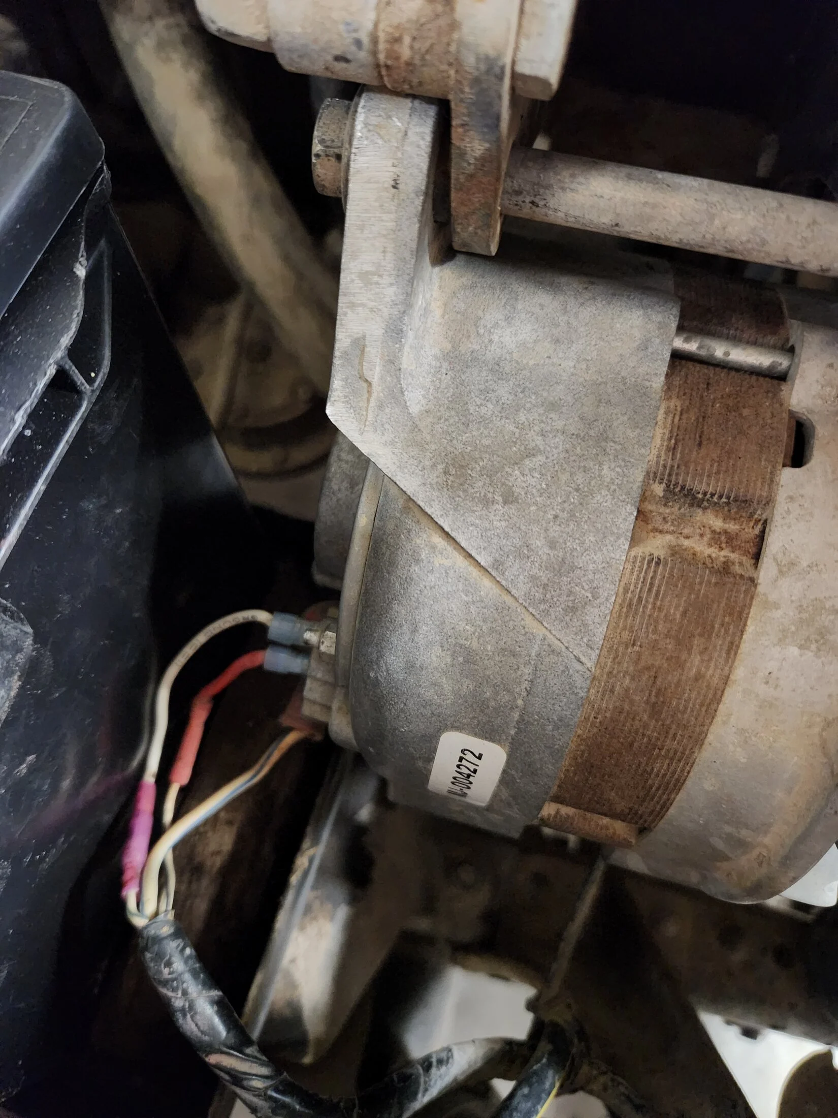

I'm trying to make sure my charging system is working as it is supposed to. I've just replaced my batteries. The old ones lasted nearly nine years. I have 2 batteries connected together as one. Everything else in the system is stock. I took the alternator off and took it down to be tested at an auto electric shop. The guy told me all was up to par. Reinstalled it with new batteries and with the truck running and even revved up a little all can get is 13.16 volts at the battery terminals. Seems like this is too low. It should be closer to 14 volts or higher. Correct? Do I possibly have a failing voltage regulator? I did clean all the connections very well, so I don't think that's my problem.
I have what I'm sure is not original connectors at the alternator but they seem to connect tightly. This could be where the problem is. ???

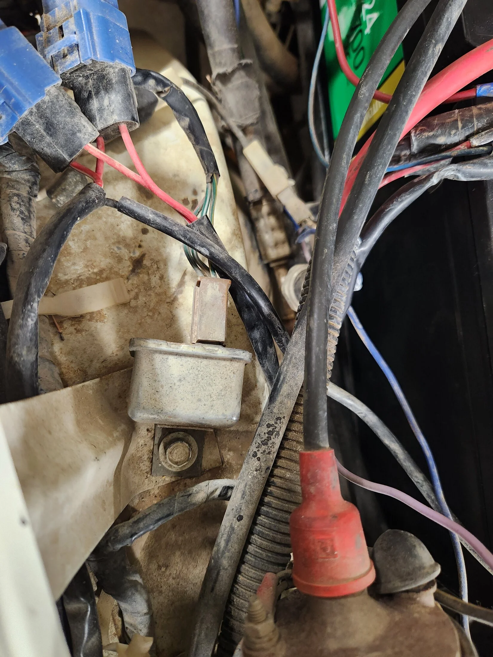

That relay next to the coil is for the horn.
I can’t see enough of the alternator - it’s orientation doesn’t look factory.
In a factory setup, the voltage regulator is under the master brake cylinder.

Thanks for the tips and voltage regulator location. It is a stock alternator. I have a vintage air conditioner. That moves the alternator from it original orientation

If you have an external voltage regulator, they can often be adjusted - procedure in the manuals. at least clean the contacts.

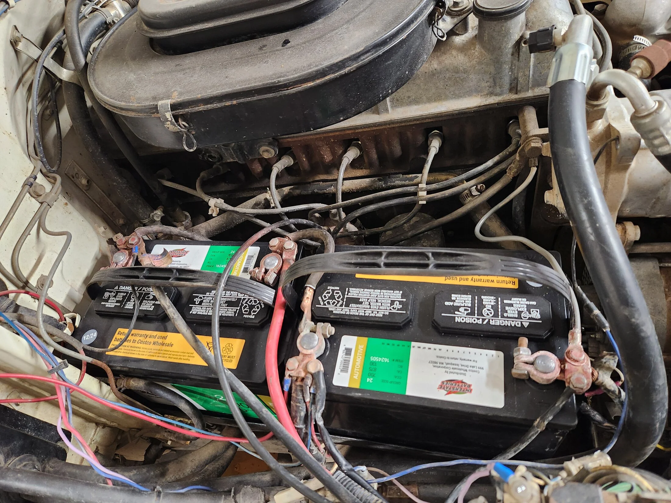

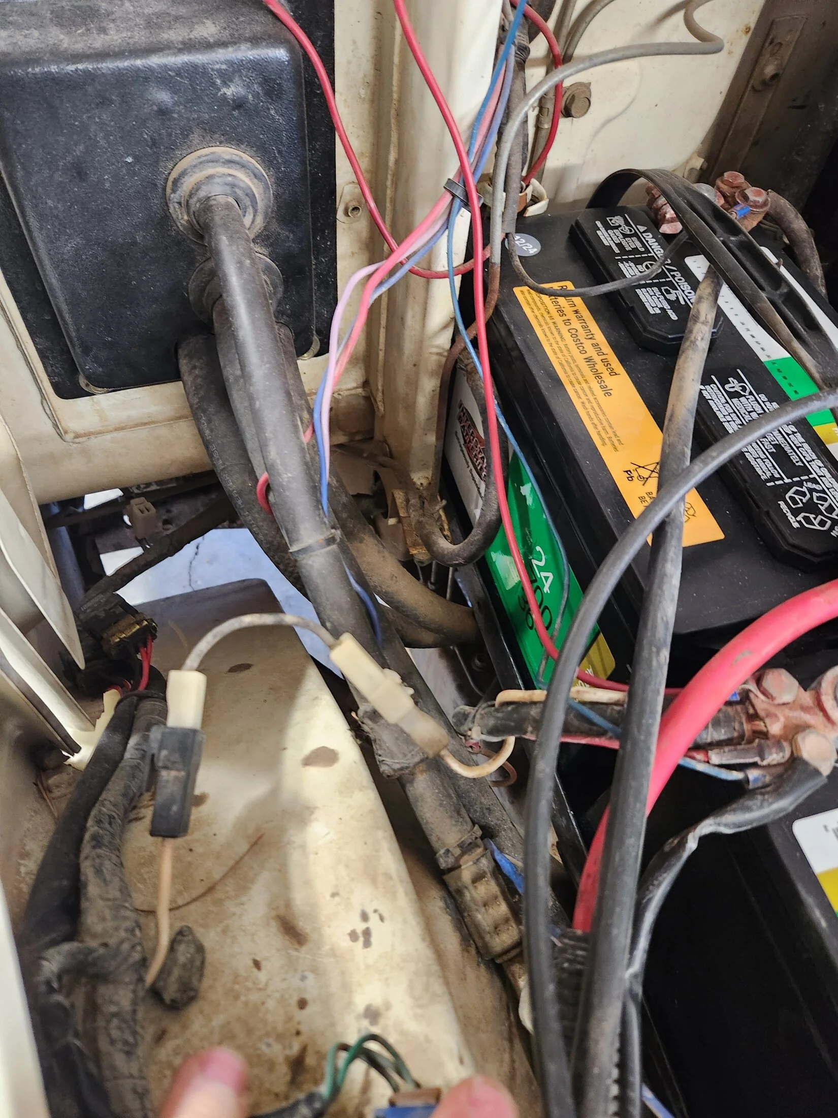

Does this harness have a fusible link?
I don't know if there is a fusible link. I've been seeing lots of talk about them and have wondered if I should probably add one. But then I comfort myself with the fact that the truck has been fine the way it is for nearly 48 years. So unless there was one from the factory I doubt I have one. How/where would look for one. I have added an aftermarket fuse panel and 50 amp breaker with some extra 12 volt outlets and a hot wire at the trailer plug coming off the panel. Also i switched to the Koito headlights and a set of off road lights. There was the vintage air add on a couple years before I bought it. Otherwise the rig is pretty well stock.

A fusible link is just a section of wire that is smaller in gauge, and it has insulation that melts before it burns. The advantage over an inline fuse is that it doesn't burn up and ignite flammable hydrogen that your battery(ies) might be out-gassing during heavy use, or a short. You can find them everywhere, but, finding the correct size might be a hurdle. Any wire connected to the positive terminal, that isn't the cable for the starter, can use them.

Without a usable link - you run the risk of the power cable to the battery melting and shorting to ground - which then - the battery boils and possibly explodes/ catches fire.
In my 75 rig - what was there kinda looked like it might have been a fuse-able link - it won’t risk a maybe on that power supply- personally.

X2, sounds like your batts are at voltage. the regulator is working and in float, do what Charlie mentioned and it will draw a load on the batts, regultor should kick into charge mode and you should see a charge voltage at batt. pics of your batt + side going to starter wires will show a fuseable link , usually just off batt +.
