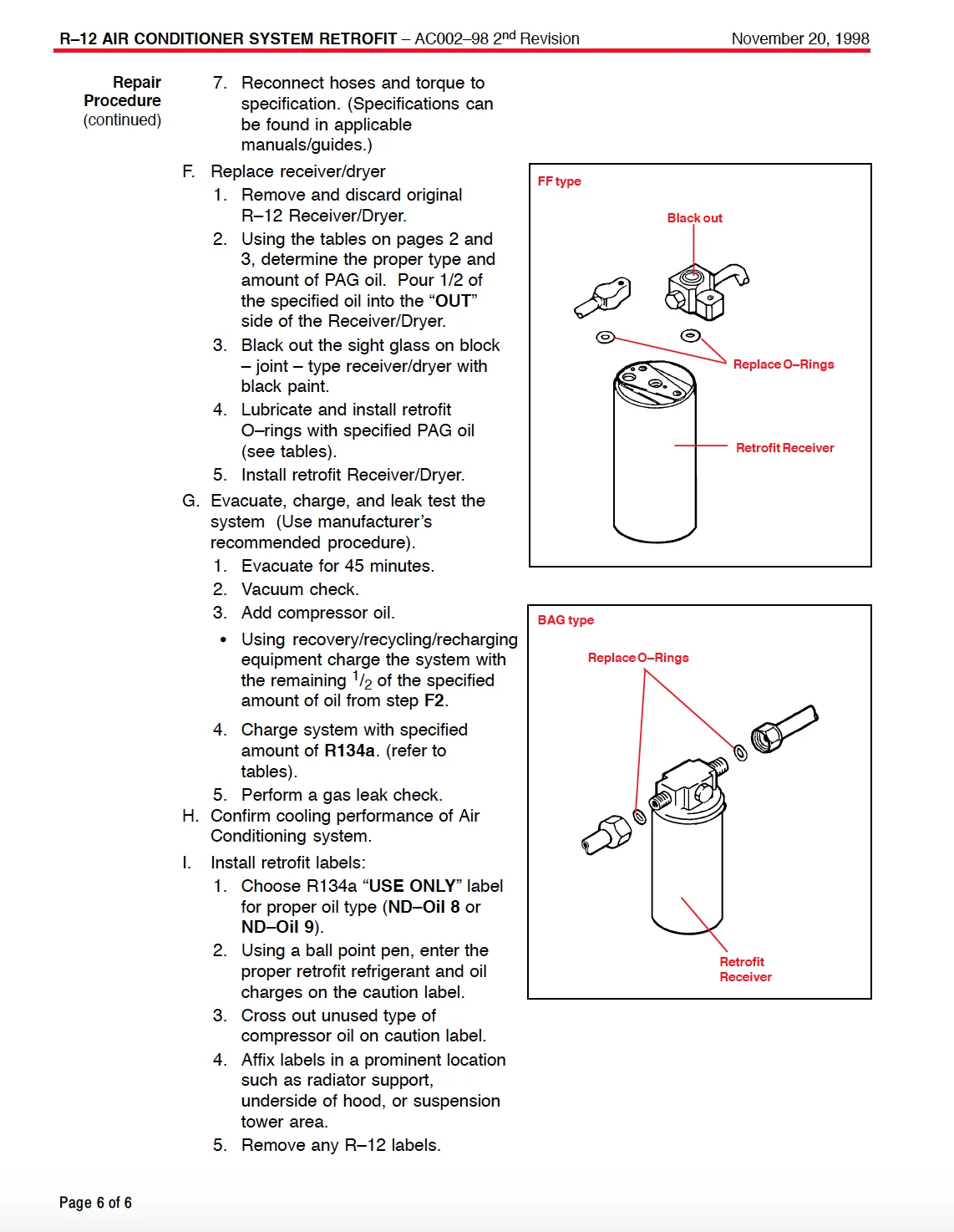

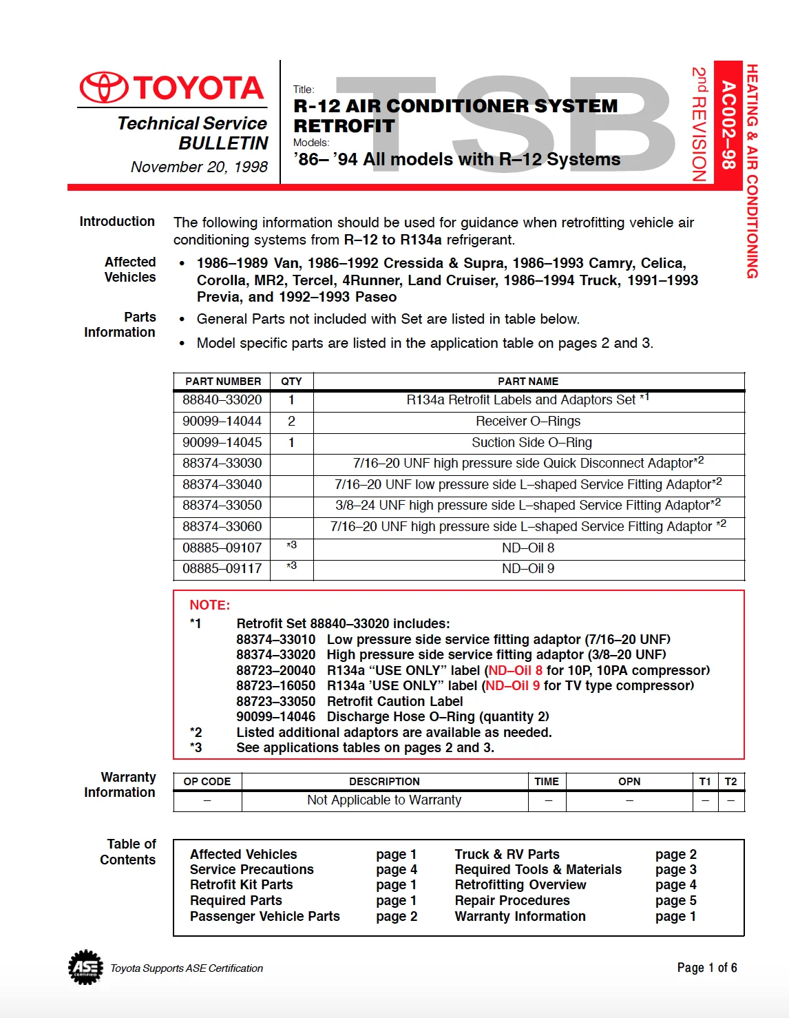

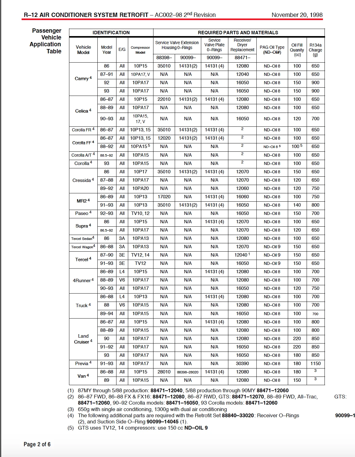

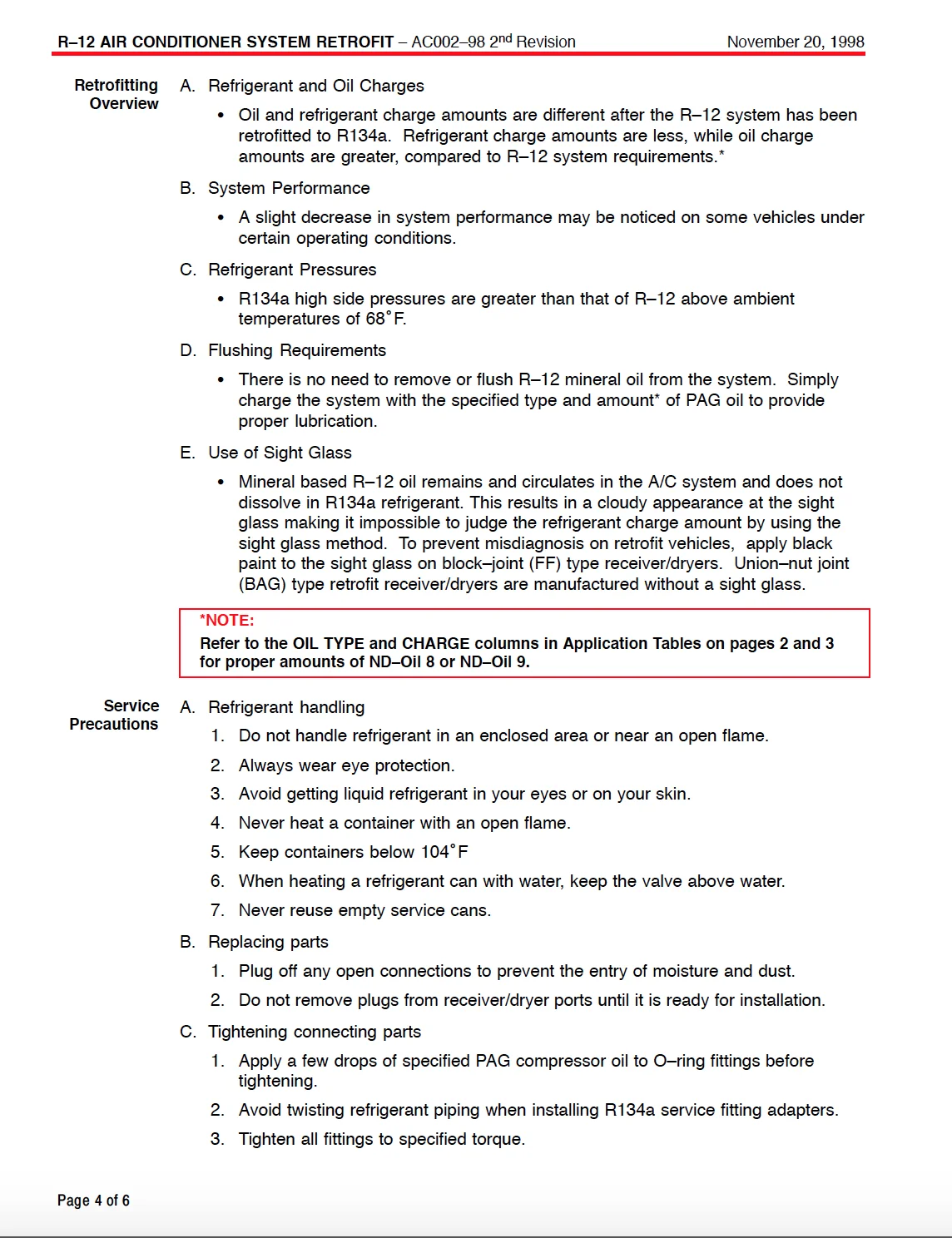

I found this a while ago when I was in the middle of re-furbishing all my heater and A/C boxes. Not sure how much this will help you but there is some good general information here when converting from R12.

While the above Toyota procedure is super helpful, if you just want to add some R12, watch this video. it's a process for 134a, but doesn't really matter. Just get the pressure levels for high and low from searching here on MUD.

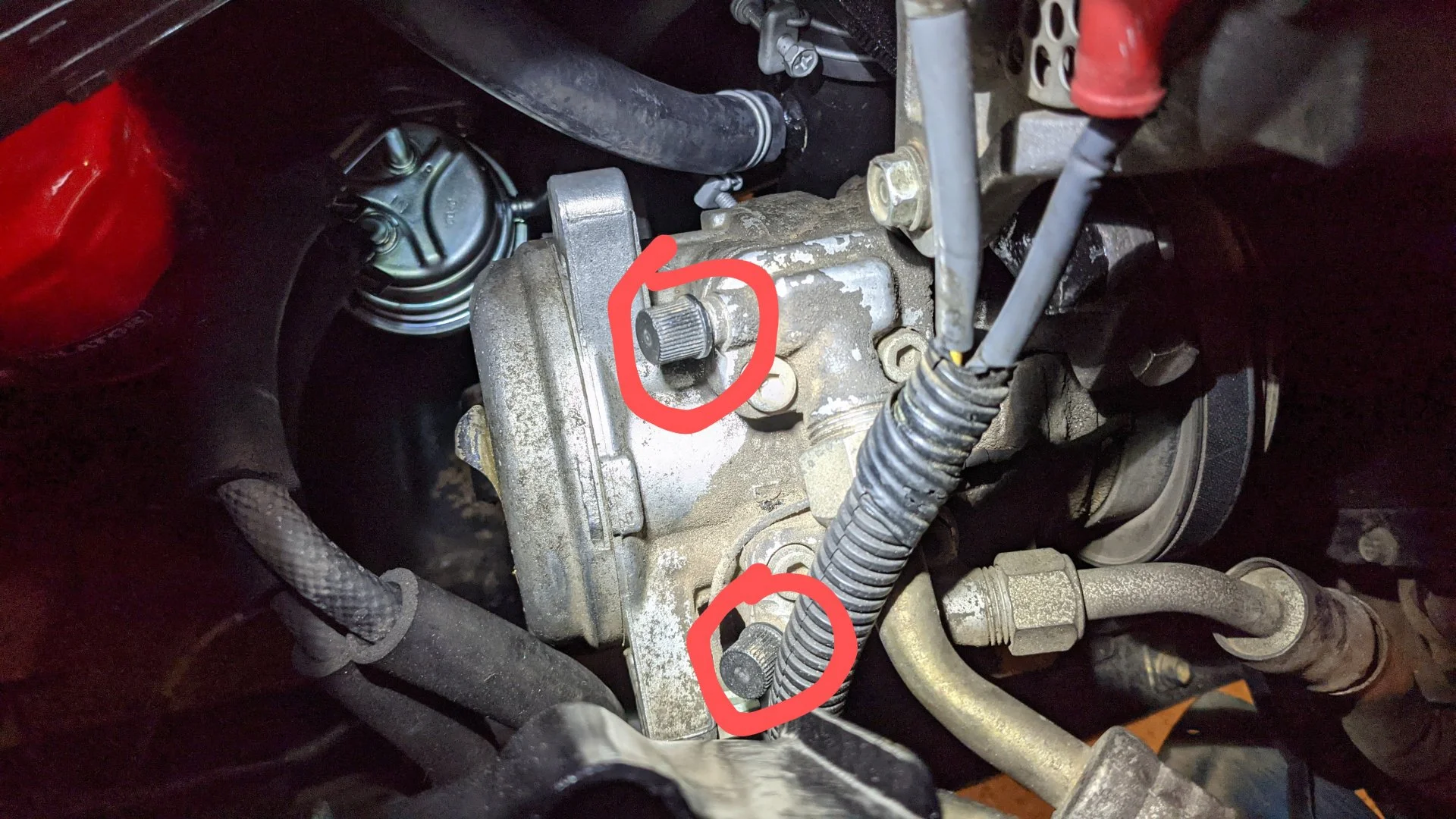

Nice. I was hoping for direct simple fix. I watched the video and while I was certainly willing to do what needed to be done seemed like way more than $50 of gear. Steve one more question where do you add the R12? There's the metal pipe passenger side that looks like the valve but I'm not certain.
I am trying to learn about this process also......but I don't think that is the correct IN!!! The two connections are on the compressor with black plastic caps or covers on them, if still installed.

Thanks!

In. That looks promising.

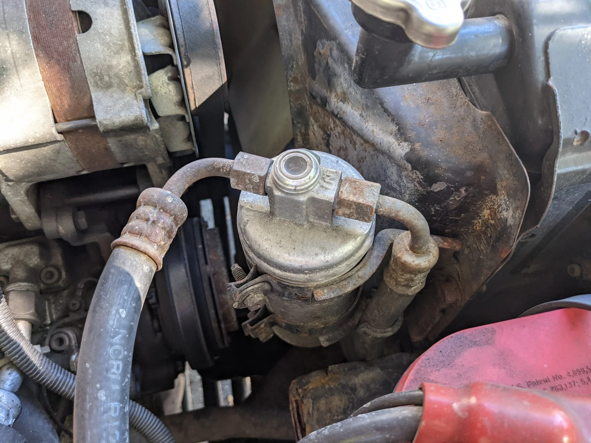

If your system is still R12, you can charge it using the sight glass on top of the drier. If you see bubbles in the glass when the A/C is running, then it's low on refrigerant. You can just add refrigerant, a small amount at a time, until there are no bubbles in the sight glass. You'll need a set of gauges to accomplish this.
Note that bubbles will briefly appear when the compressor cycles, and this is normal.
You can also add R12 until you get a nice cold center vent temp - (38-45) and quit at that point. Don't be a hero and keep adding refrigerant beyond a reasonable coolness point.
