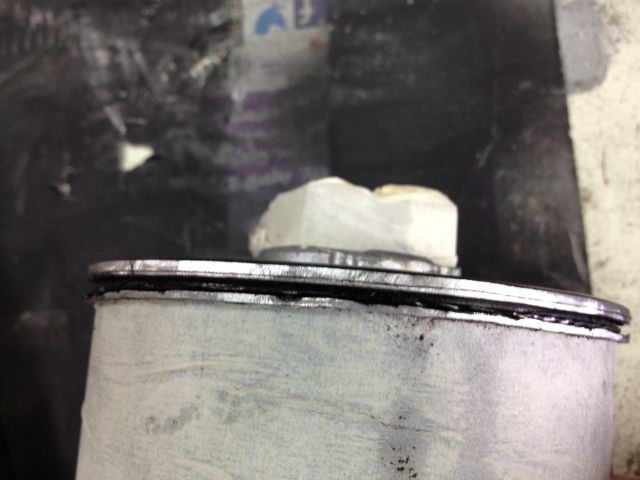

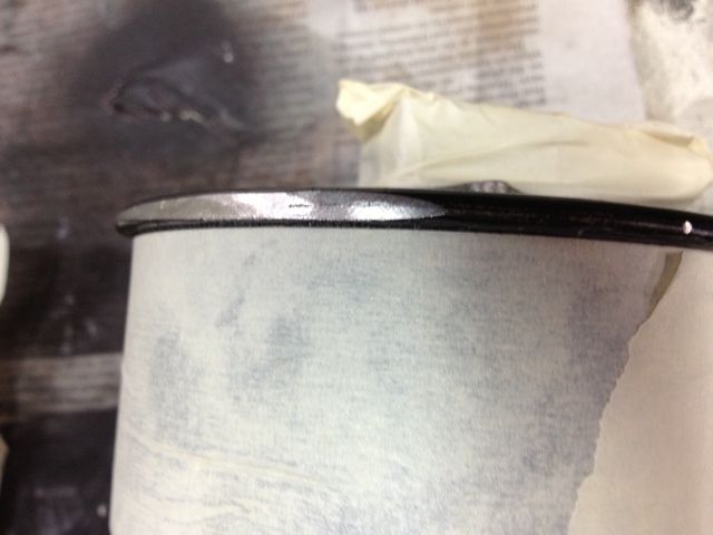

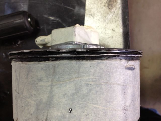

I figured out how to open the charcoal canister so you could theoretically refill it as many times as you want! Basically, the top closes like a paint can or an old school jar of rubber cement. The only difference is that its folded over and crimped to the canister. To remove it, simply grind the crimp down, gently tap a knife between the top and the canister, and then tap it open with a hammer and screwdriver. It's not super pretty, but it should reseal by just tapping the top down. I'll probably apply a little fuel resistant RTV or something like that to help with the seal.
First picture is starting to grind the crimp down. I put masking tape on the sides and over the valves to keep shavings out. I used a hand file, but a flap wheel would probably be the ideal tool.
The next picture shows the line you're trying to grind all the way around.
The third picture shows the bottom of the crimp being pulled off.

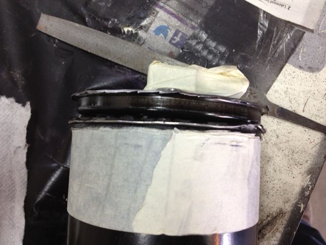

Once you've got the bottom of the crimp removed, put a strong knife between the top and the canister and tap it in to create a gap. Once you get the gap started you can work your way around with a narrow screwdriver and hammer to tap the top off.
I wound up bending mine a bit while experimenting with how to get it off. I could probably do it much cleaner knowing how to get it off now.
I haven't filled it with new charcoal yet, but FirstToy has already covered that part of the procedure. I'll post some pics of how I seal it all up. Probably I'll just tap it down with a little sealant.
