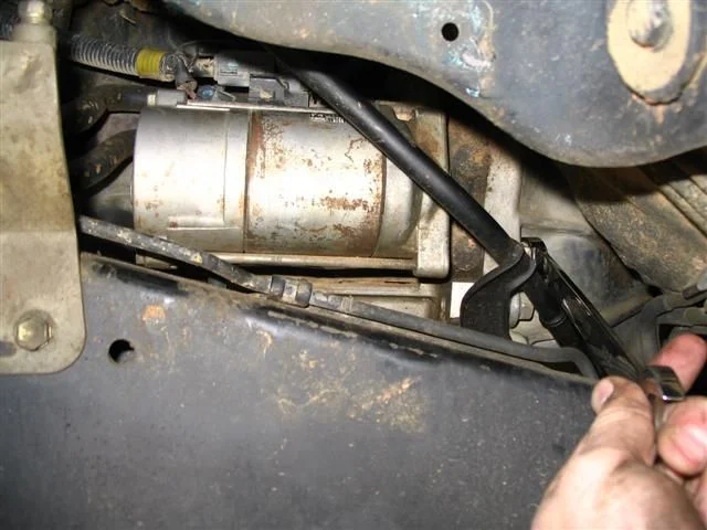

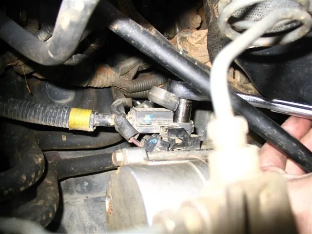

here is a couple of shots of my rig looking up during my starter removal. You can see the PHH.

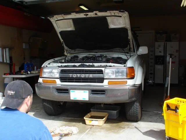

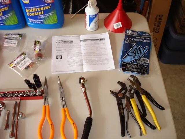

As promised, here are some photos. First the set up table (notice e9999's walkthrough - thanks again e9999!).

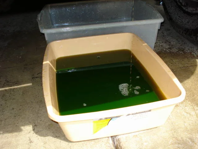

Then the coolant drain (through the petcock & block plug). Mop at the ready (too many neighborhood dogs...).

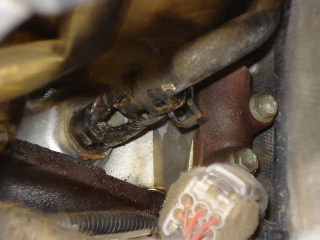

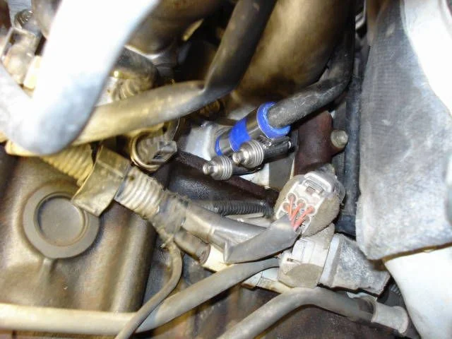

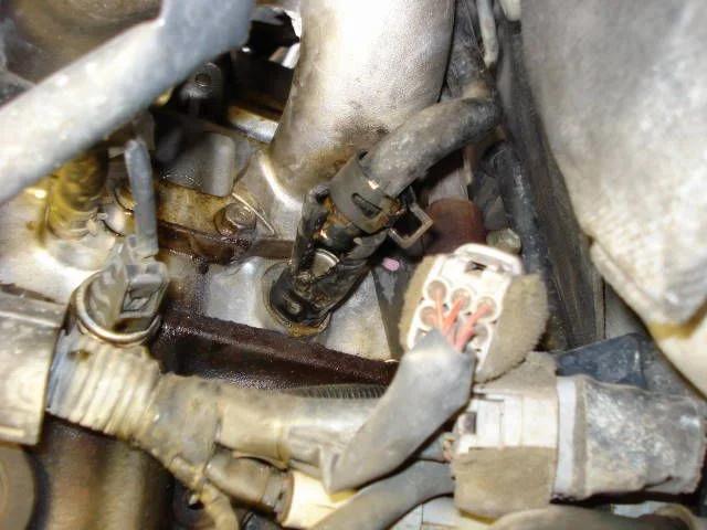

Here is a shot of the old PHH after I cut and ripped it.
Removing the starter and transmission dipstick tube definitely adds some elbow room! Both the starter and tube were very easy to get to using some swivel sockets and gear drive box wrenches.
Cutting the tuna can clamp with a dremel w/cutting wheel went perfect. I was able to manually rotate the clamp closest to the block and squeeze it with a pair of angle needle nose pliers.
Removed the top bolt from the metal tube and reached up from under the vehicle to just loosen the lower tube bolt. That allowed me to twist and pull the tube out of the way.
Pushed the new PHH on and swinged the pipe back into place. This took about 1.5 hours (including coolant drain, tire + starter + dipstick tube removal). Having all of the tools ready helped!

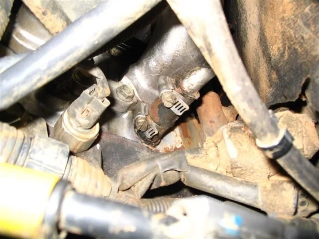

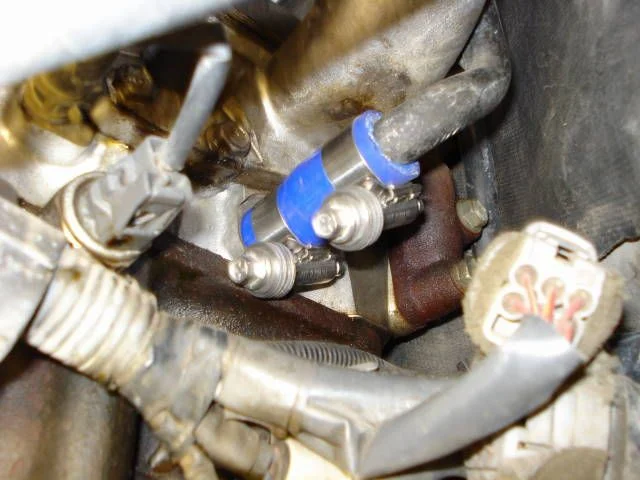

New PHH installed! Much easier than I thought it would be.
