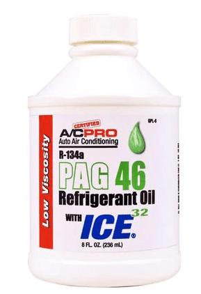

this is available at autozone locally. What is ICE32? Is this acceptable or should I be looking for pure PAG46?
After Googling "ICE32 additive", it sounds like a good thing, actually.
Snake Oil mostly....,but won't hurt anything if that's what you want to use. Just start with fresh PAG46 in what ever form.
